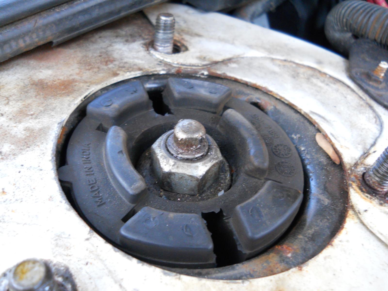

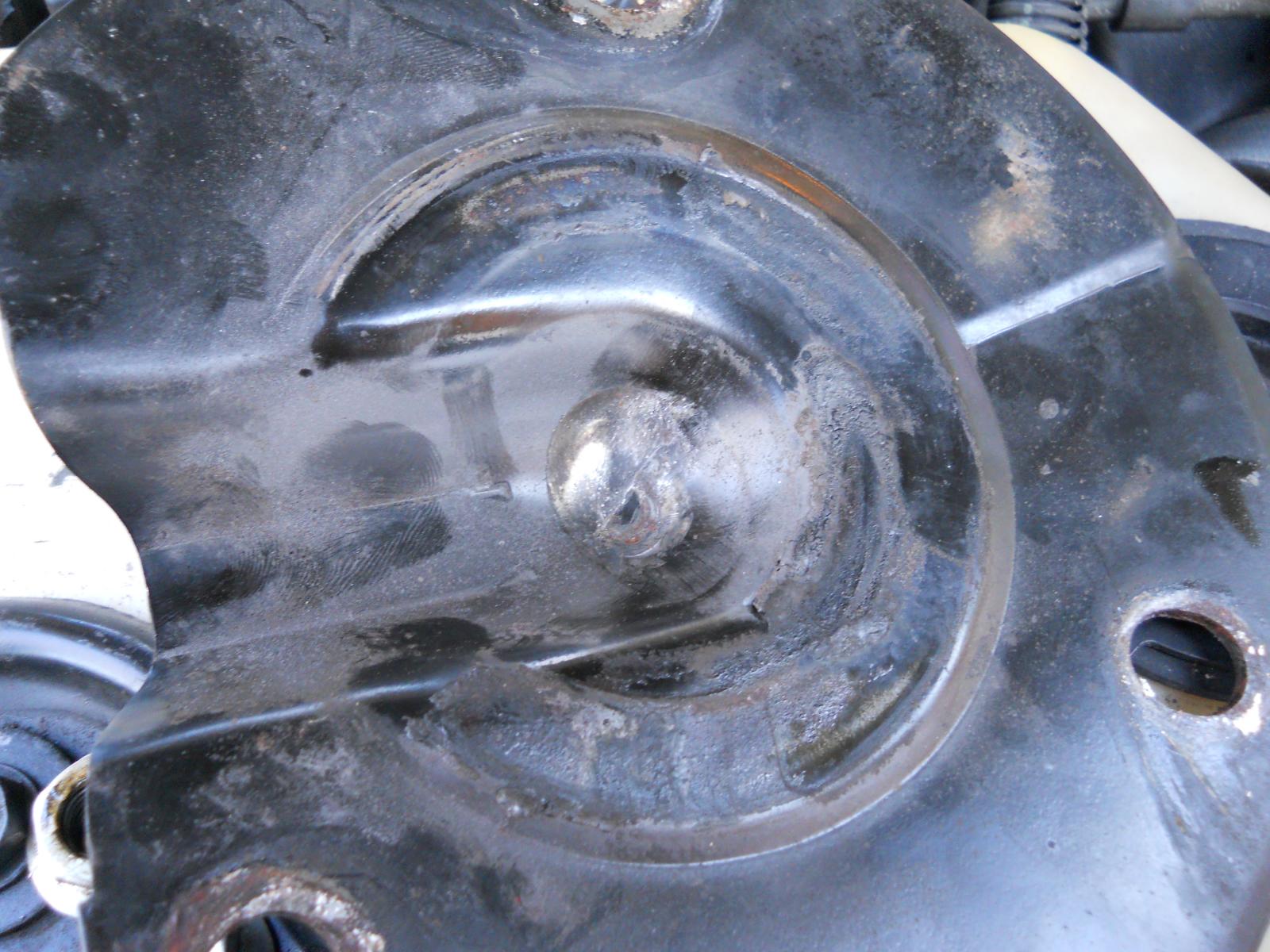

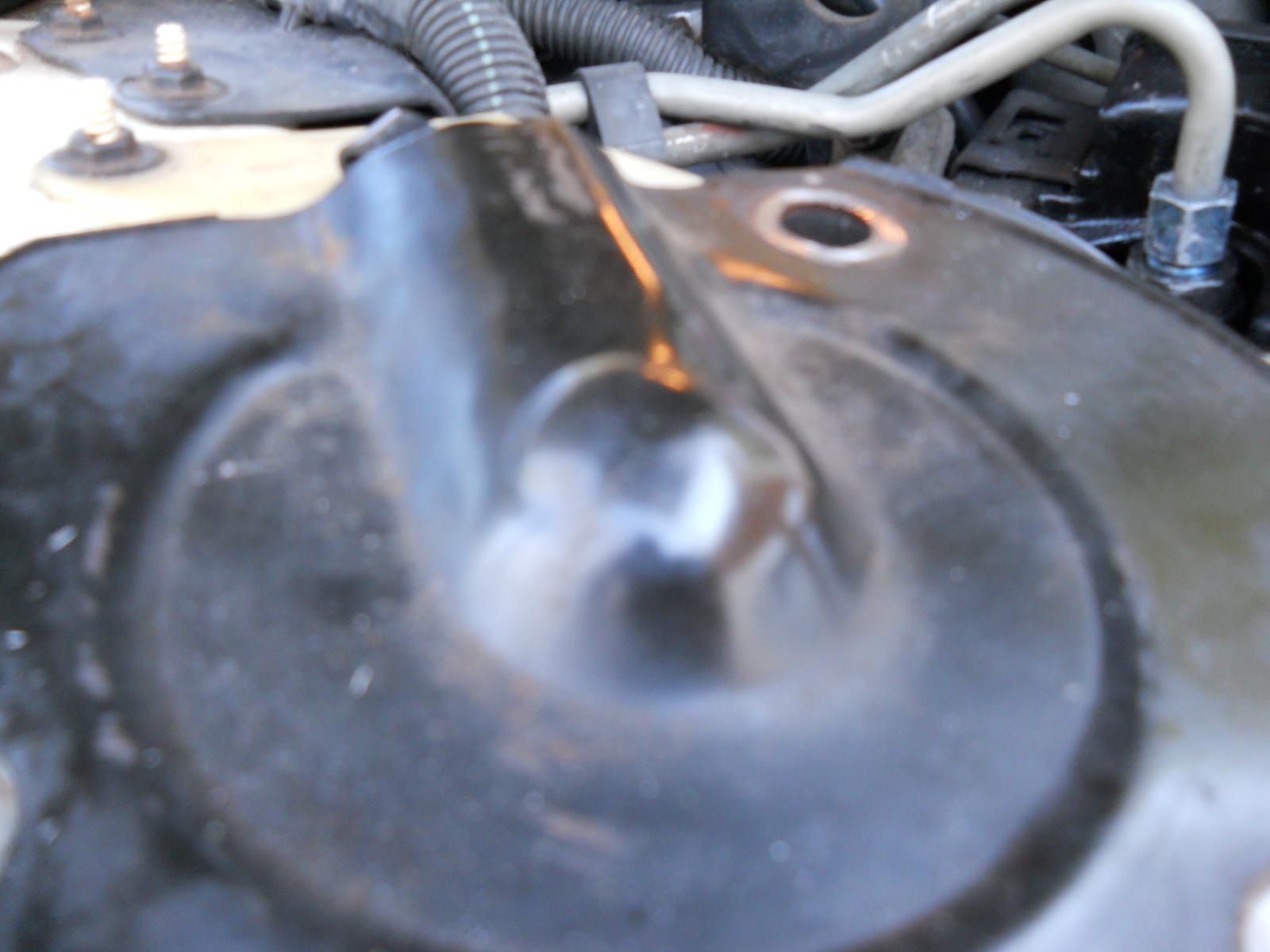

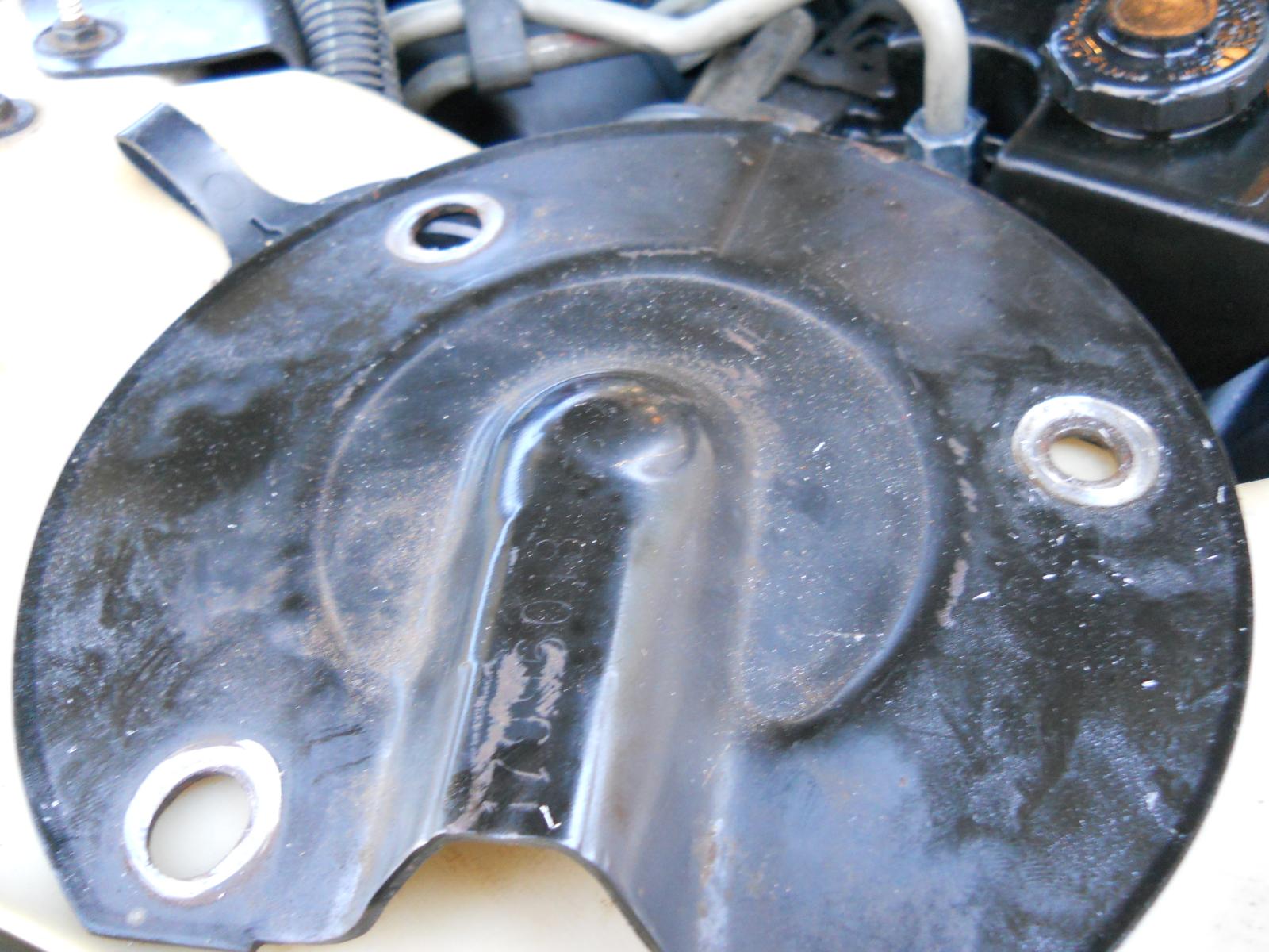

z34dumas Posted February 15, 2013 Report Posted February 15, 2013 soo about 6 months ago my front struts were comin up and slappin against the cap on top of the tower... making a horrible noise and deforming the caps. i went to jack up the car and the passenger side strut assembly blew apart. i literally replaced everything front and back except the springs and it was fine for awhile but now they are rubbin the caps again..... could this mean my springs are wore? anyone else have this problem before? Quote

z34dumas Posted February 16, 2013 Author Report Posted February 16, 2013 no the mounts are brand new i put everything in myself... and the nut is there i checked everything and made sure it was all tight but im still getting the noise and scrubbing on the top plates and the tops of the strut rod are mushroomed out. i cant figure it out Quote
