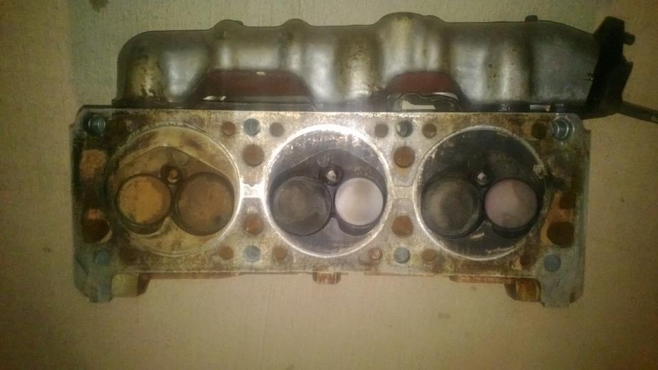

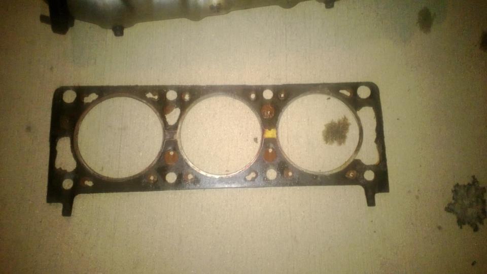

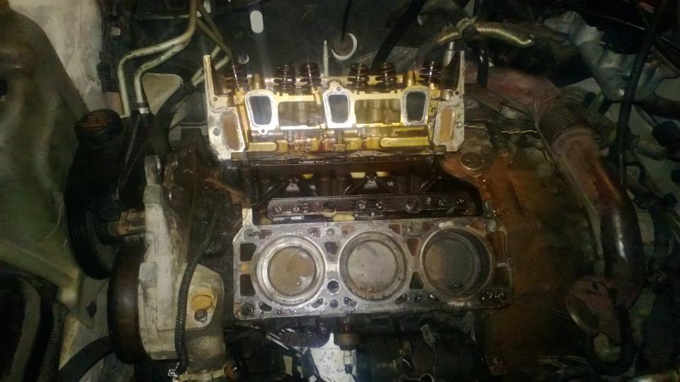

96_GP.SE Posted February 12, 2013 Report Posted February 12, 2013 Hey guys. I'm Trent John. 18 years old. And recently just bought my first w body. I found my 1996 Grand Prix with 145,000 miles on Craigslist for 1000 or best offer. Started talking and found out LIM and head gaskets were just about gone. Coolant just poured out the motor as you poured it in. But the car still ran surprisingly well. After checking out the car. I asked the guy what his price was. He told me give him a offer and I started low thinking he would work it up a bit. I walked out with my first w body for $150! The air condition system was recently changed before I got the car. Including New tires. New plugs. Air filter. Battery. Power steering hoses. And a couple other things I can think of at the moment. He sunk some money into it. Well anyways, I got it home. And found out the coolant was pouring into cylinder 2. And that the LIM gaskets have been changed before. But all of the bolts weren't tightened down, weren't even hand tight. figures. Pulled the heads off. Sent them to get checked. Both heads were great. Surprisingly, No warping or anything. Changed the head gaskets. Put the LIM back on with the metal fel-pro gasket set. Finished putting the motor together. Changed the oil. Flushed the cooling system. And she fired right up. Quote

96_GP.SE Posted February 16, 2013 Author Report Posted February 16, 2013 definitely a head gasket problem Quote

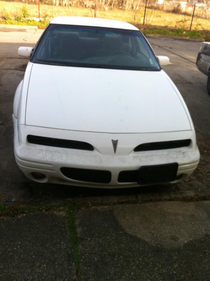

nelson480 Posted February 20, 2013 Report Posted February 20, 2013 Looks identical to my car, cept i have white wheels! I have same interior too, but im gonna add power seats and leather cutlass interior Quote
