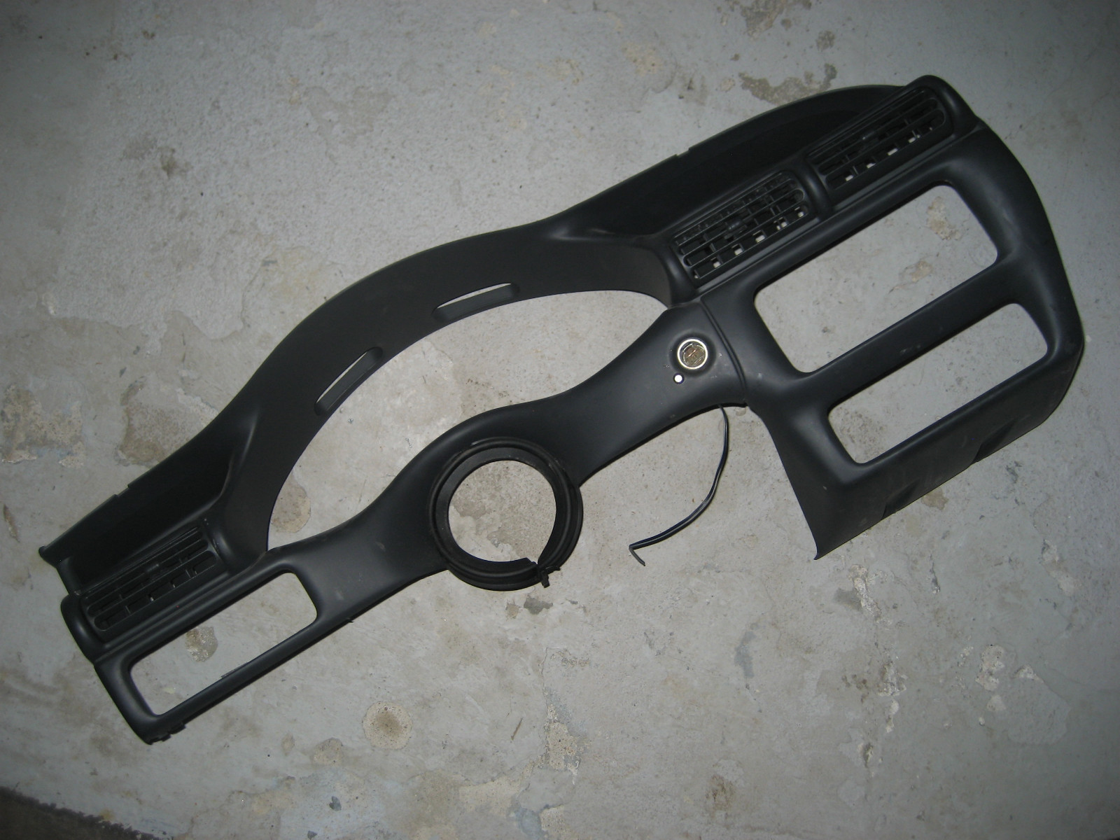

This is from a 96' GP it looks to be one piece instead to two where the radio bezel separates. did they change that? I'm hoping if I take a gamble on this it works for me.post-6482-143689123583_thumb.jpg

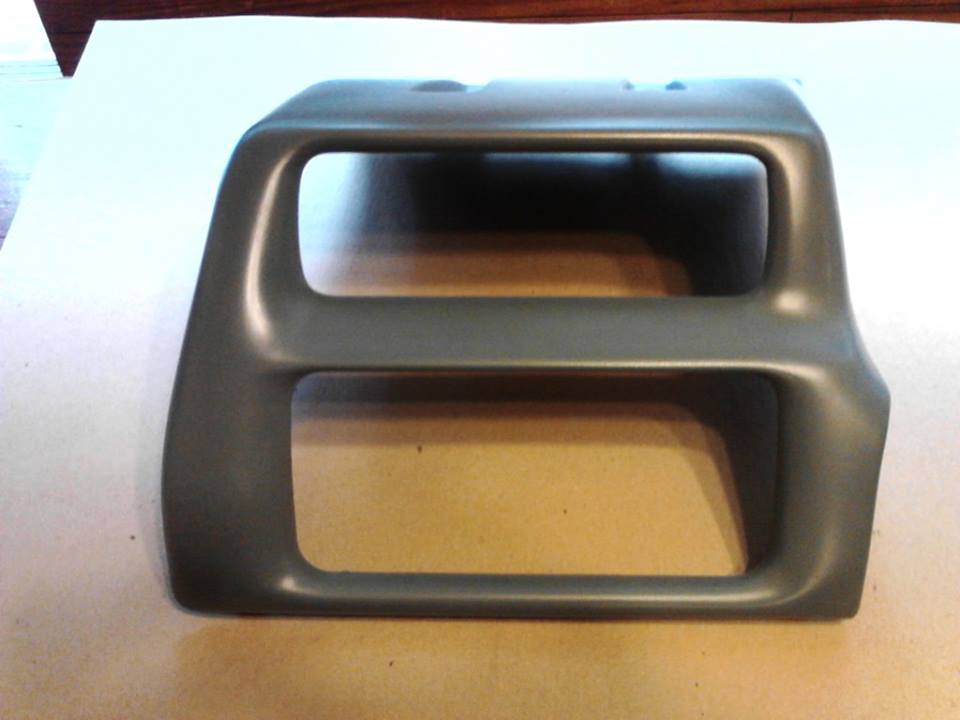

I used lacquer thinner and a scotchbrite pad. Took the goo off with little effort. Sand with 600, adhesion promoter, paint, clearcoat... Not a problem. I went with a lighter grey (by choice) with a satin clear coat. Hold up great. post-9414-143689142425_thumb.jpg
