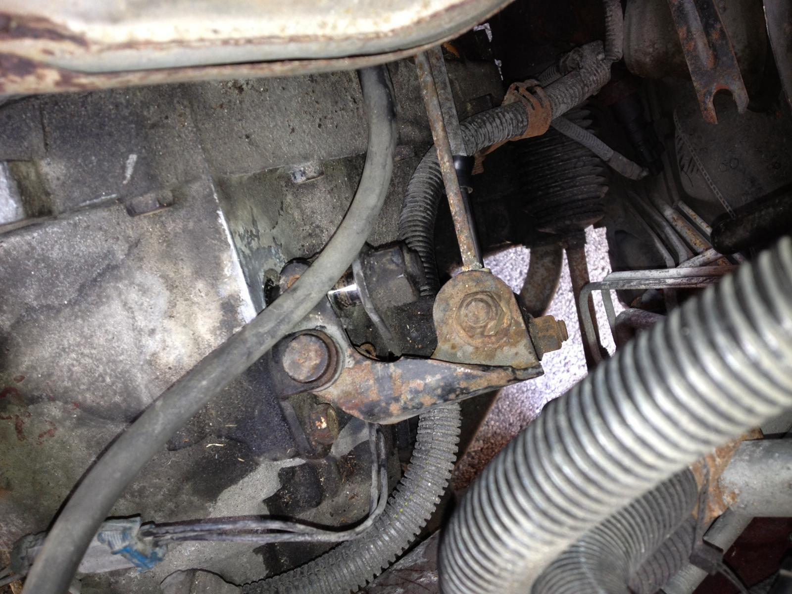

R Crusoe Posted February 3, 2013 Author Report Posted February 3, 2013 These are images I took of the positions of the likage and cable positions in the various gears - 1-5 and then reverse. Anyone see anything out of the ordinary?? Quote
alec_b Posted February 4, 2013 Report Posted February 4, 2013 Can you put it into reverse when the engine isn't running? Quote

alec_b Posted February 4, 2013 Report Posted February 4, 2013 That's what I was going to suggest. Put in reverse, fire it up and see what happens. I'm just curious if there's maybe something wrong with the reverse gear. The fact that it goes into all forward gears would lead me to believe that it's not a linkage problem. However it is possible that just reverse could have gone sour. Quote

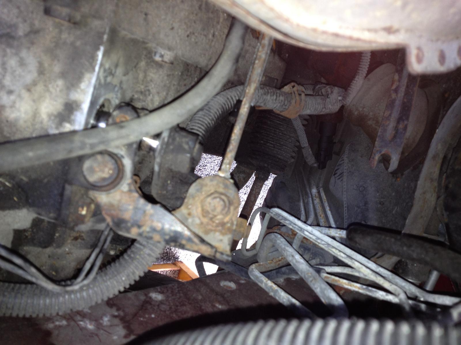

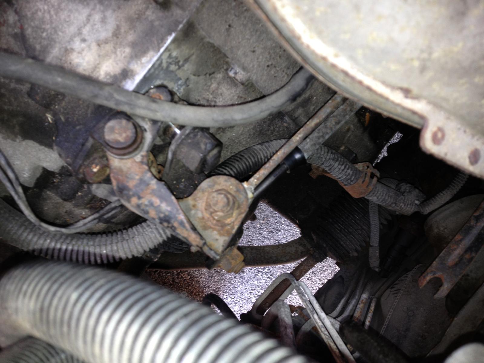

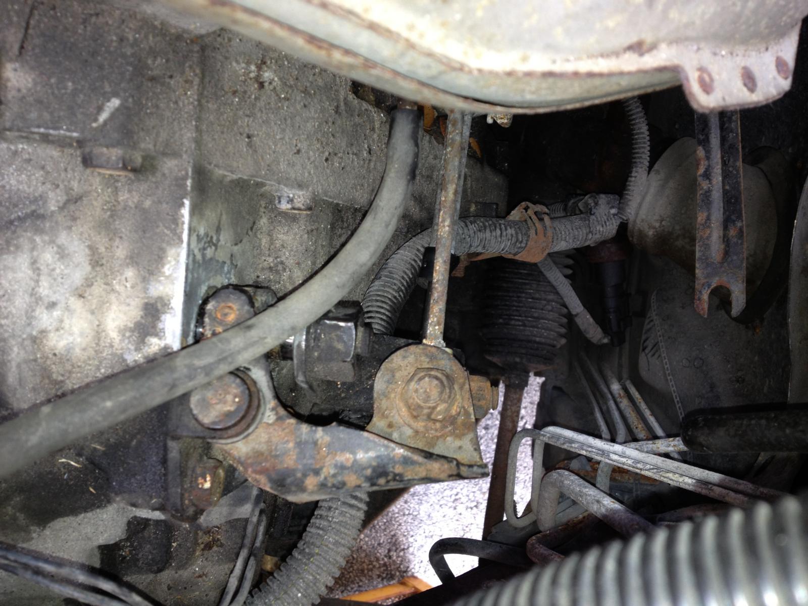

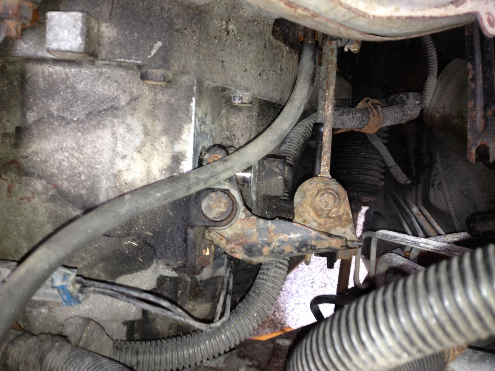

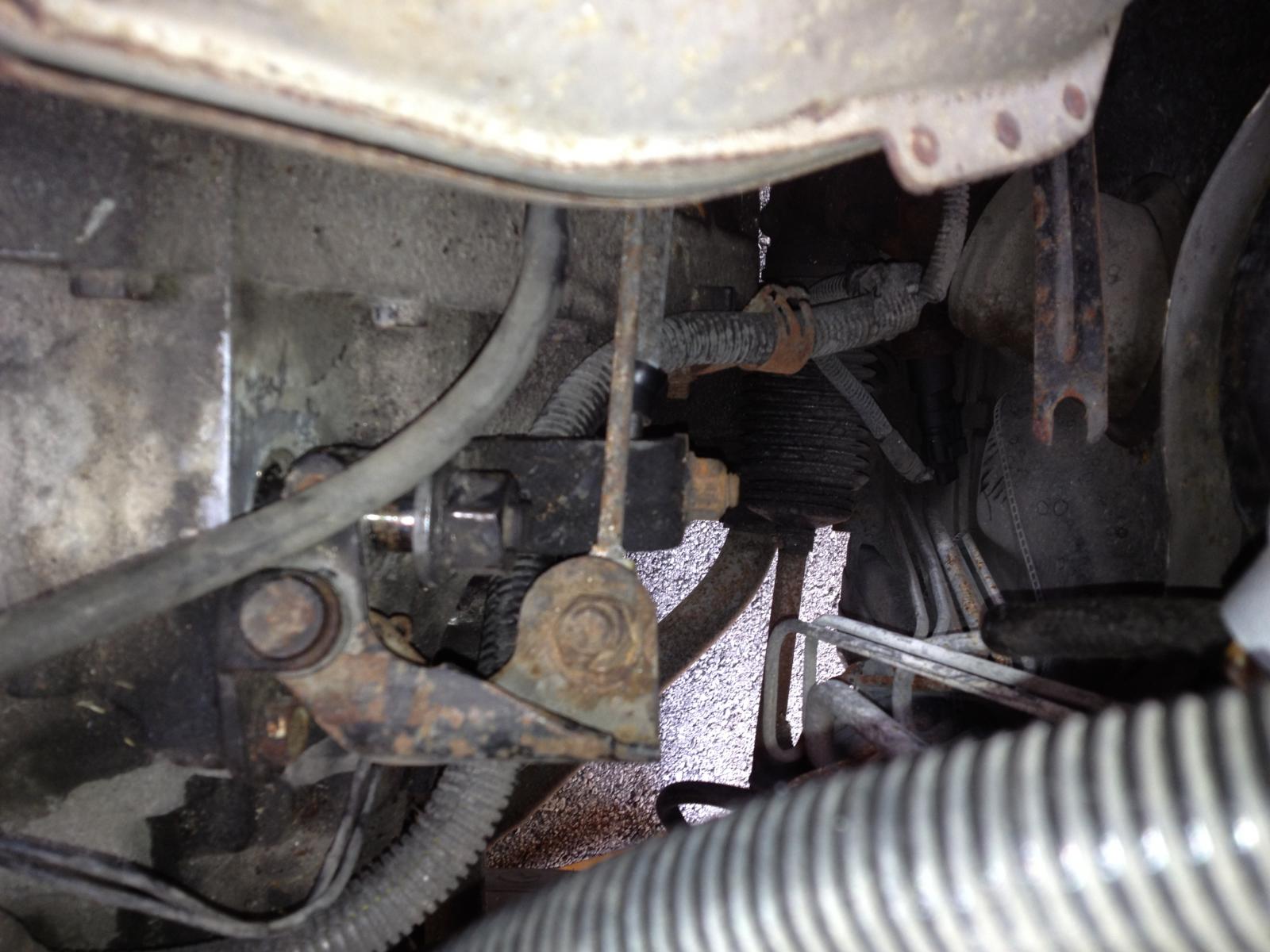

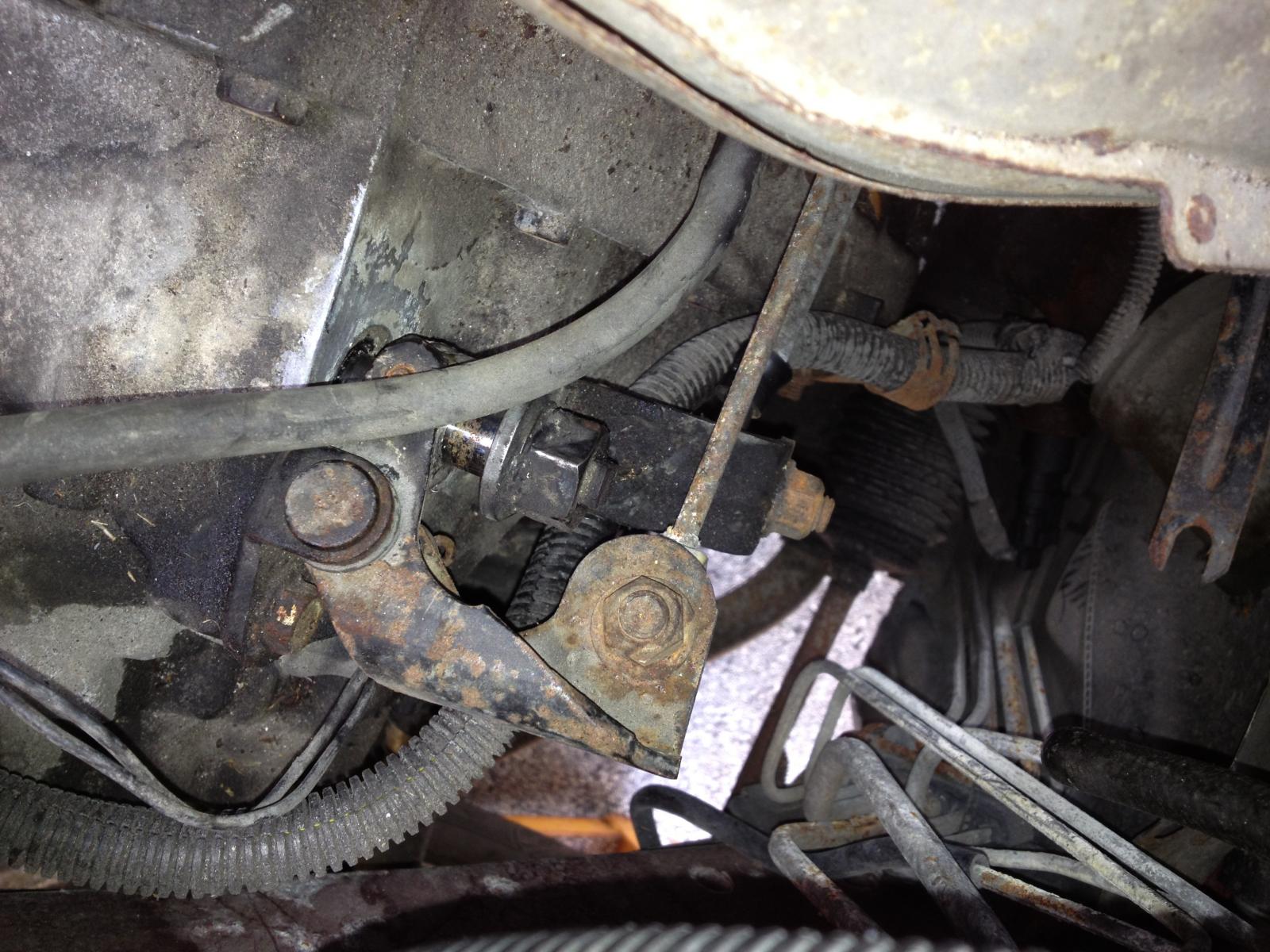

R Crusoe Posted February 10, 2013 Author Report Posted February 10, 2013 Started car with gear shift in reverse position and clutch pedal depressed. Released clutch gently, but car tries to move forward. Quote
