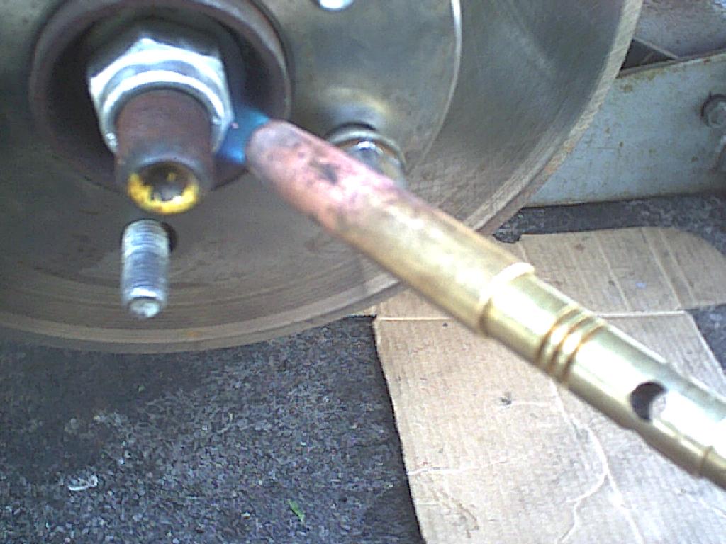

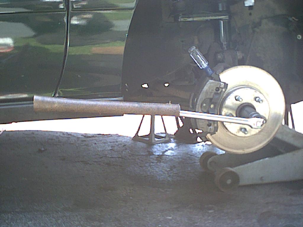

Cutlass350 Posted February 1, 2013 Report Posted February 1, 2013 It's not horrible. But, depending on the age of the car, where/when it's driven, etc, there are some things to be careful about. 1) You need the right socket for the hub nut. Get that at Autozone. You need a heavy duty socket. Even if you did have one that fits (unlikely), get a socket made for hub nuts. Those sockets have less flex. If you strip the bolt, you're super screwed. So, spend the ~$10. 2) It's ??~170 FT Lbs?? of torque on the hub nut. That means using a good 1/2 racket and a pipe. Many of the cheap breaker bars will do just that - BREAK! 3) If there's rust on the hub nut (guaranteed if in a snow state), do the smart thing first, get MAPP (like propane but hotter), and heat the ****** out of the nut. And, I do mean the heat ****** out if the nut. Have your ratchet, extension, socket, and pipe ready to use. The nut often comes off with out a lot of problems doing it that way. 4) A torque wrench is a good idea to put the nut back on. Again, it goes on with a lot of torque. Many torque wrenches may not go up that high. Not that big of a deal. Max out the torque wrench, then snug it a little more with the pipe and ratchet. Or, make sure you put the hub nut on with a good deal of force. FWIW, I actually slightly lifted the front of my Achieva (an N-body) when I did that car. On my heavy Intrigue (W body), it's heavy enough so that it barely moved. 5) You may need to use some heat on the bolts that attach the hub. I often do. Be careful of the ABS and wires! I often remove the ABS stuff/wires first. On my Intrigue, the ABS is internal to the Hub - just a wire coming out. On my Achieva, there's an external ABS sensor. Good Luck! Quote

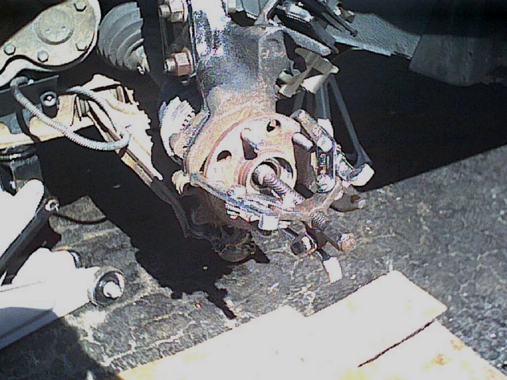

Cutlass350 Posted February 1, 2013 Report Posted February 1, 2013 (edited) Some old pictures of a spindle R&R that I did on my '94 Achieva. But shows other relevant stuff. Remember those old "VGA" cameras. http://www.veryuseful.com/GM/tmp-bearing/index.html Edited February 1, 2013 by Cutlass350 Quote
Cutlass350 Posted February 1, 2013 Report Posted February 1, 2013 Oh yea, as shown above, you can often use a screwdriver, punch, etc in the rotor and put it against the caliper to keep the rotor from turning. Quote
