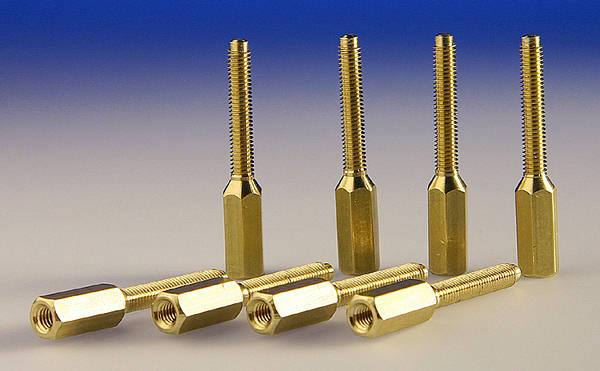

Emptydarkone Posted January 26, 2013 Report Posted January 26, 2013 How about a stud extender? In the size you need, of course. Quote
