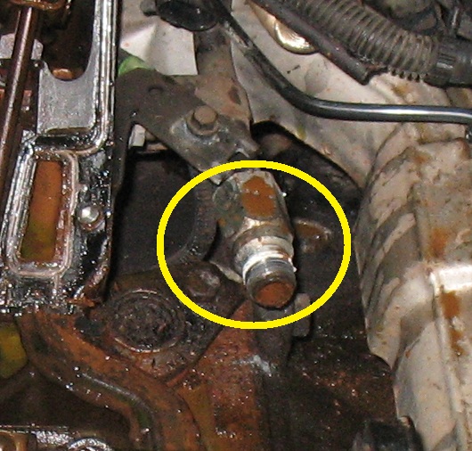

j_mezz Posted January 17, 2013 Report Posted January 17, 2013 Did it have Dex in it? Maybe you didn't get sludged because it didn't? Replace the plugs while you're in there, I didn't and am kicking myself. And make sure you get this little bugger unbolted and out of the way. I was ready to put everything back together, the LIM seemed to be sitting flush but the bolts wouldn't line up because this was pushing on it. There's an on-line manual in the FAQ section but the link doesn't seem to be working. Quote
97oldscutlas Posted January 17, 2013 Author Report Posted January 17, 2013 Thanks for the heads-up and reference info, j-mezz! Yeah, the engine bay says use dex only. so, it had it in there to begin with. I had to replace the radiator earlier and flushed and refilled with extended life.. I prob will replace the plugs, even though i replaced them earlier.. definitely a pain in the rear! Quote
