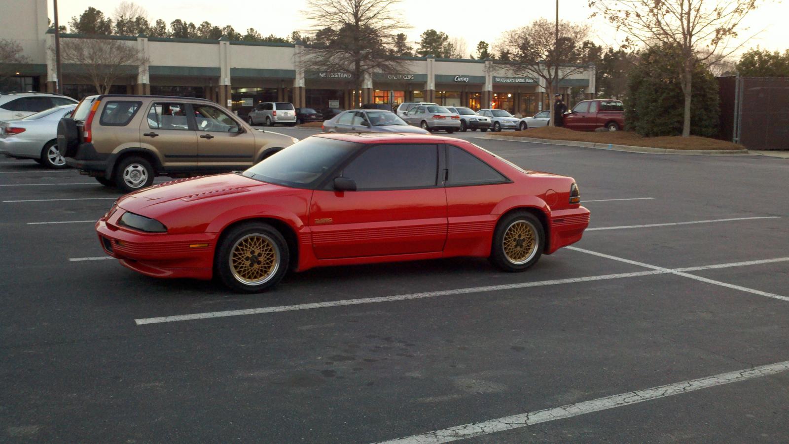

I have a birchmount leaf and intrax springs on my 92, I think the birchmount lowered it around 2", maybe 2.5" after it settled. I think eibach springs are still available for the front.
Birchmount / Intrax combo
keep in mind I'm running 245/45/16 tires.

I was going to leave it but I have mismatched springs in the front and the left side sags about an inch. thus since the car came with the birchmount Im thinking about swapping it in if I can get lowering springs for the front. i like the way that looks in those pics. Now hows the ride? stiff? noisey??
I used the 3" drop on the rear and trimmed the stock springs till I got the desired ride height for the front. Obviously there are other ways to do this. I have had no ill effects from cutting the front springs. Car rides stiff and handles great.
