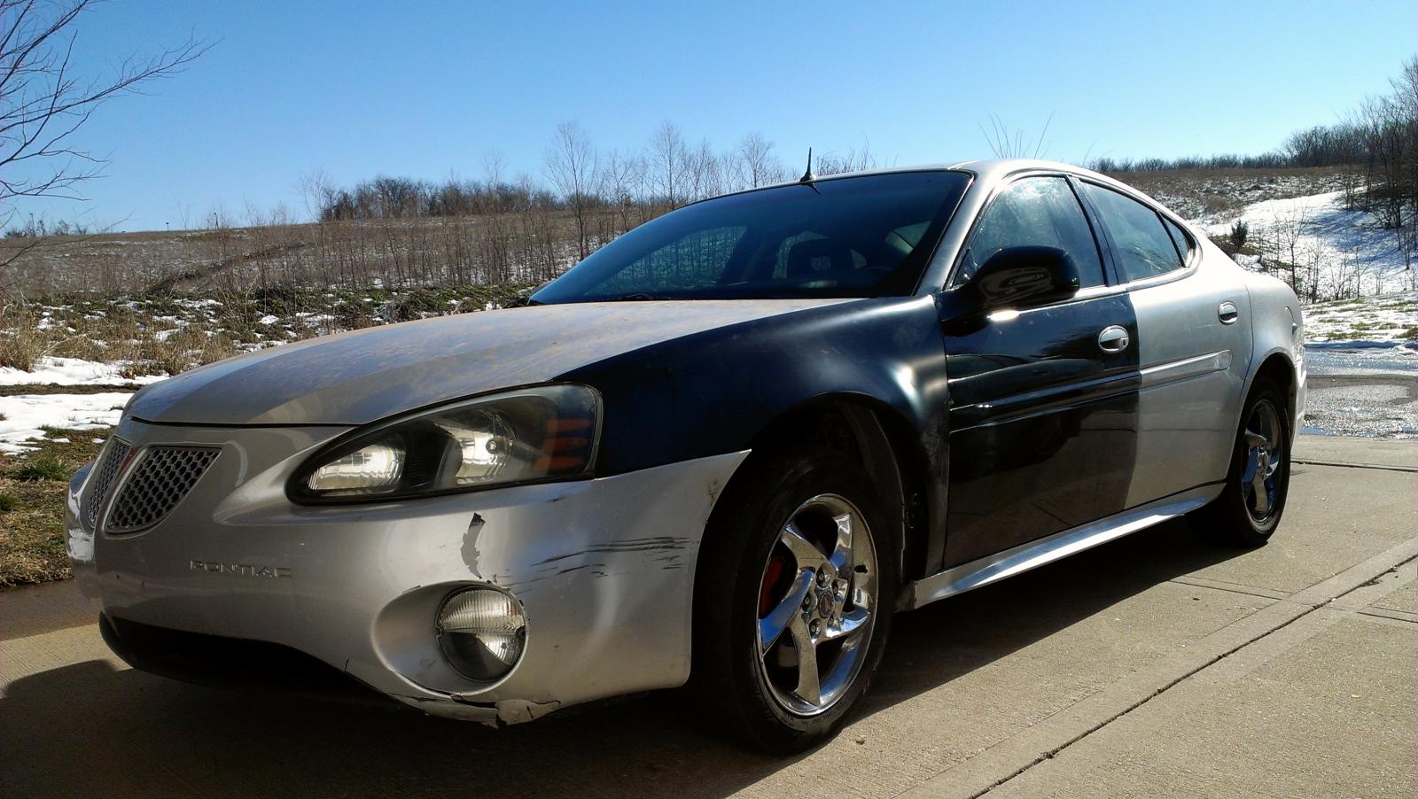

So far so good...
I did have more pics of the job but I accidently deleted them. But she drives like new. Installed a subframe and entire suspension and of course the fender and door. Only issue now is left front hub, ABS sensor is out, and a p0128 code. Im just really lucky and surprised the actual unibody was not bent in anyway.
So far all together I have $3177.14 into it, thats with what the car cost me too. Happy Days :-)
If that's just primer you better get that painted! Don't want it to rust!
It could also be bad wiring going to the wheel speed sensor. Dorman makes a replacement harness that you can install.
Its the Competition Group GTP. I didnt even know it was the Comp G until after I bought it, didnt even know they existed, just thought it was a GTP LOL. As far as the wiring for the ABS the wires are pulled out of the hub. The clip that holds the connection from hub to wire harness was broken and it was ripped out by the CV axle. Oops.
The door is used So it has factory paint, got lucky and found one on CL for $125. The fender is primered though, hope to get it all finished in a month.
Fender looks like just e-coat is all. Nonetheless, painted would be a good idea. Looks like it will be a new car in no-time.
