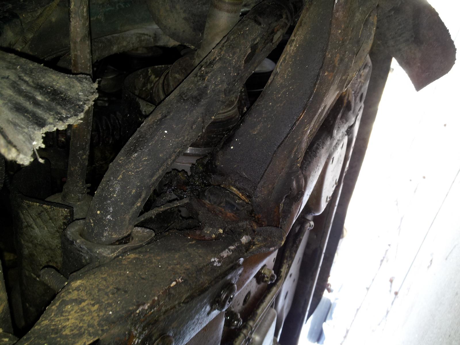

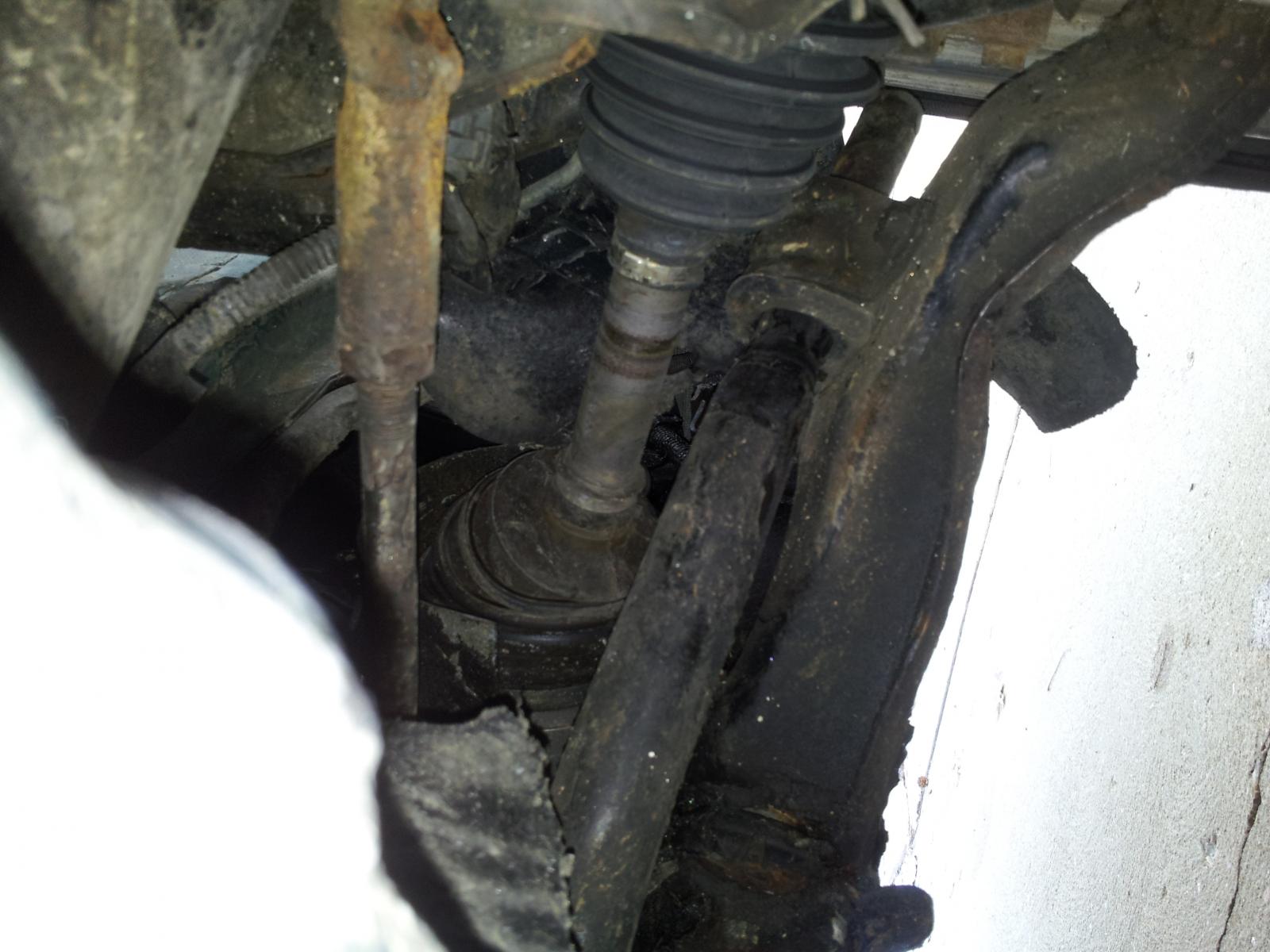

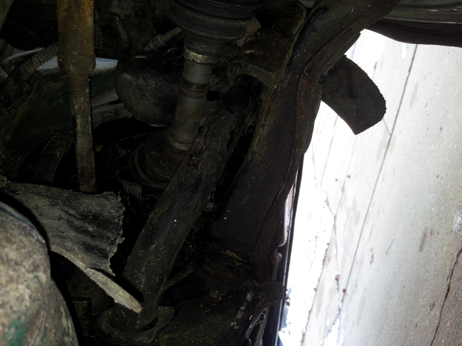

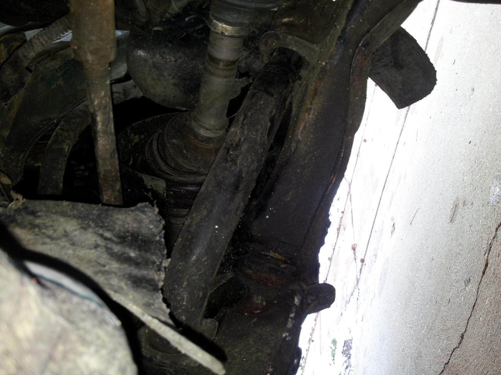

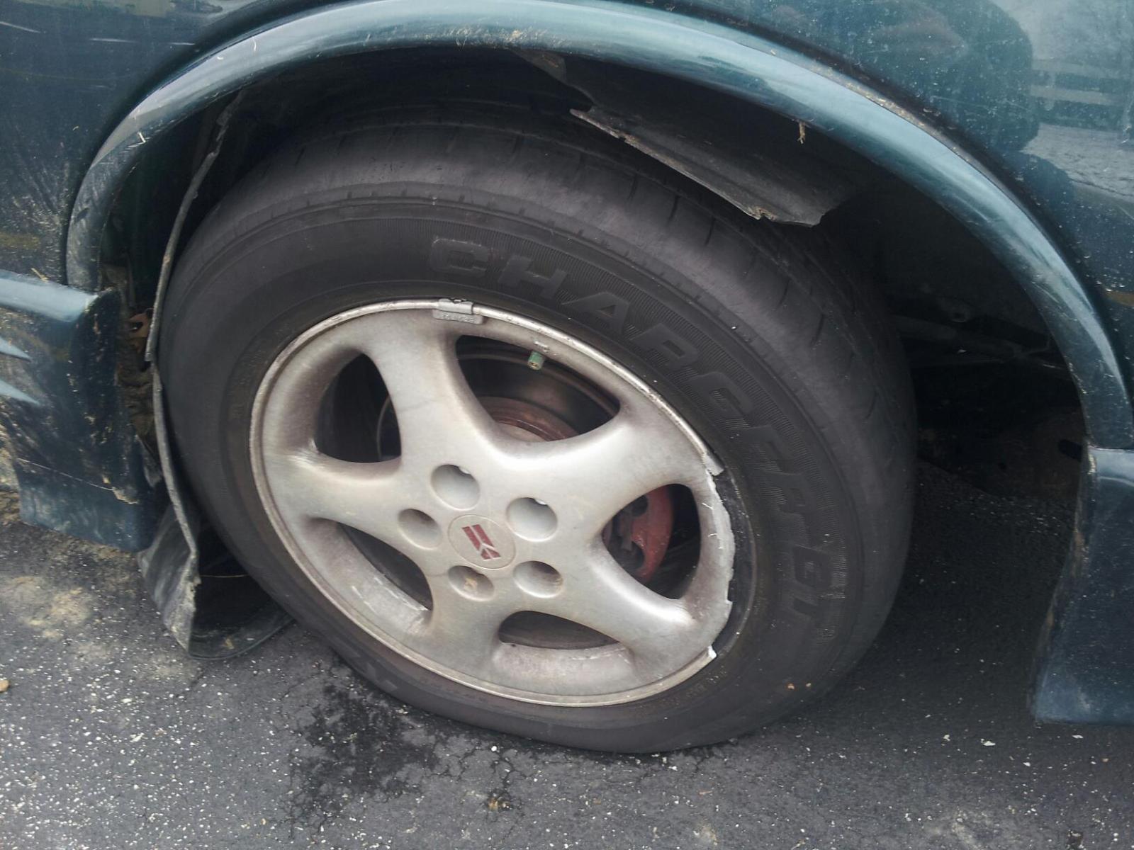

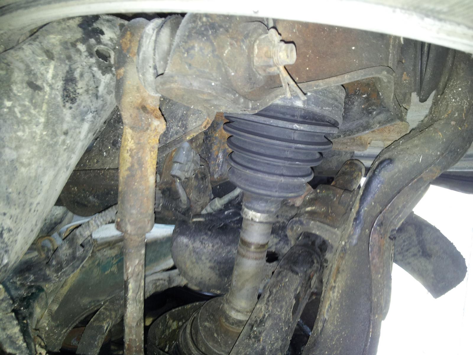

Rick Posted December 29, 2012 Report Posted December 29, 2012 (edited) Got snow yesterday and slid off the road into a curb, the wheel is pushed all the way back into the wheel well and a piece of the suspension is pulled off. Here are the pictures... Is that a lower control arm that got pulled out? Do you guys think its salvageable...if so is the work manageable on your own. If I could get a answer before towing it to decide to have it sent home or to the shop that would be appreciated. Thank you! Edited December 29, 2012 by Rick added a picture Quote
LumiLTZ Posted December 29, 2012 Report Posted December 29, 2012 From the pics i see the control arm mounts bent/broken on the cradle. The cradle itself might be bent too. I'd also guess the control arm is bent too. Can't tell if the strut/knuckle is bent but it could be. I'd guess you'll need a new cradle, control arm, ball joint, and a wheel at least. Cradle swap isn't too bad a job, I've done it in about a day's worth of time. Quote
Rick Posted December 29, 2012 Author Report Posted December 29, 2012 (edited) So a best case scenario is that the control arm mounts are just broken, or is that a very slim possibility? So doing a cradle, ball joint, and control arm you dont think would be terribly hard, do you think it would also be under $500? Would the only way to tell if other things are bent to remove the wheel and just compare sides? Theres damage to the sub frame..likely totaled.. Edited December 29, 2012 by Rick Quote
19Cutlass94 Posted December 30, 2012 Report Posted December 30, 2012 Just get a new subframe. They wont total it. youll need a jy subframe, control arm, maybe tie rod and ball joint, and new rim. Quote

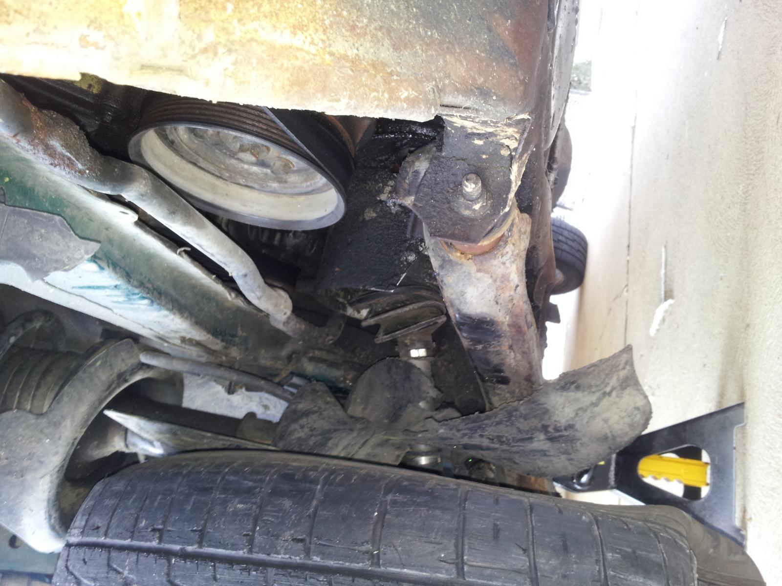

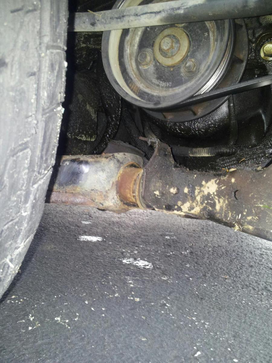

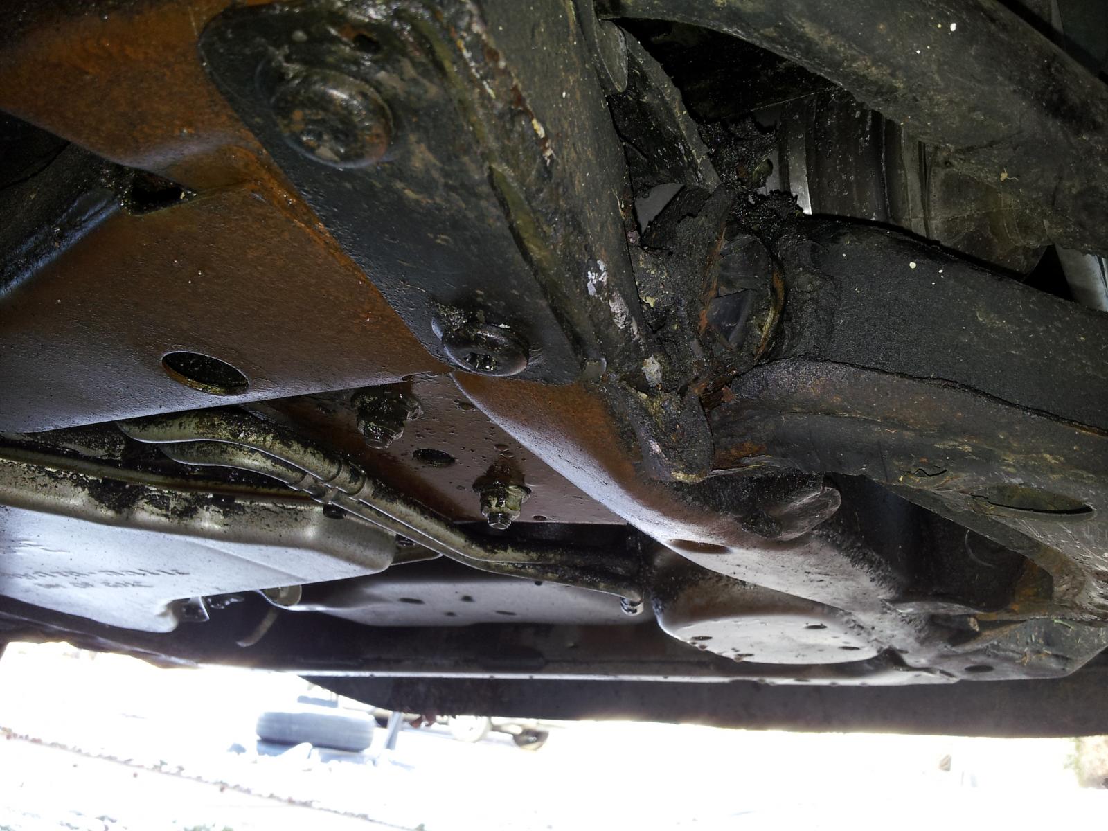

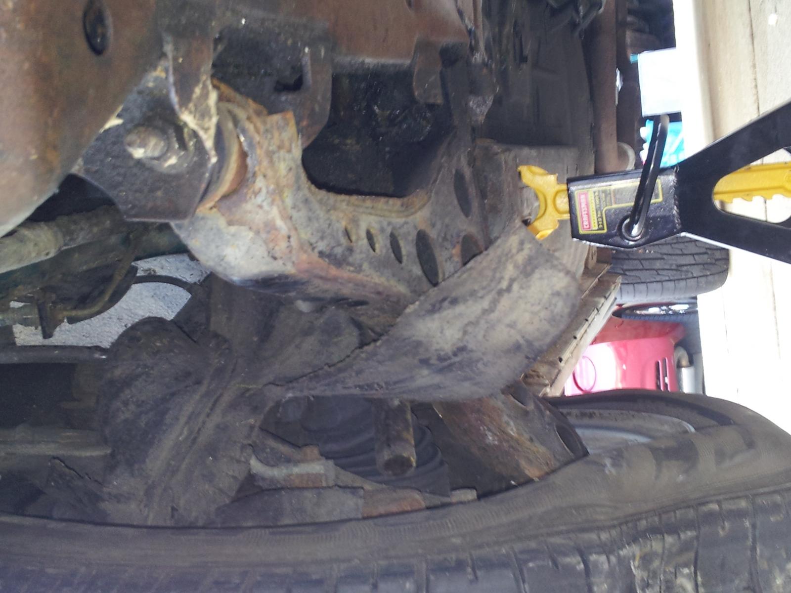

Rick Posted December 30, 2012 Author Report Posted December 30, 2012 (edited) Just get a new subframe. They wont total it. youll need a jy subframe, control arm, maybe tie rod and ball joint, and new rim. Theres the damage..the bend in the subframe is to the right of the oil pan. Is that the control arm that connects to the subframe where its bent to the wheel? Idk if its possible to reweld that member, but thats what bent the subframe and I think is what caused the wheel to shift back..but I may be wrong. Replacing a sub frame, can that be done at home or has to be a autoshop? sounds expensive. Cant figure out why the images turned sideways..sorry about that Edited December 30, 2012 by Rick Quote
19Cutlass94 Posted December 30, 2012 Report Posted December 30, 2012 I've seen it happen before. Replace it with a unit from the jy. If they total it, but it back and fix it, then you'll have money as well. But if they don't total it (which I doubt they will) it's actually not that bad if a fix, even though it doesn't look good. Sent from my iPhone in some random spot of Texas. Quote
19Cutlass94 Posted December 31, 2012 Report Posted December 31, 2012 Bah! Damn phone didn't load all the message. It would be much easier to just replace all the parts than it would be to weld. Cheaper and easier. As long as the oil pan isn't broke, it's fine. You can replace the subframe at home, but it depends alot in what kind of tools you have. Sent from my iPhone in some random spot of Texas. Quote
