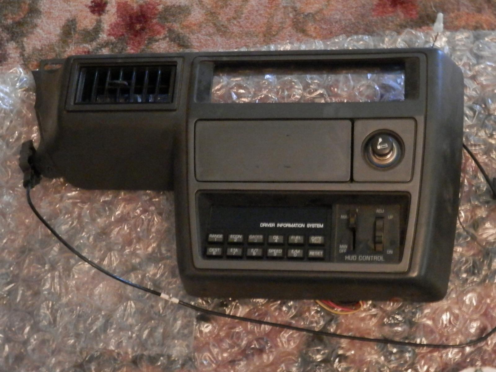

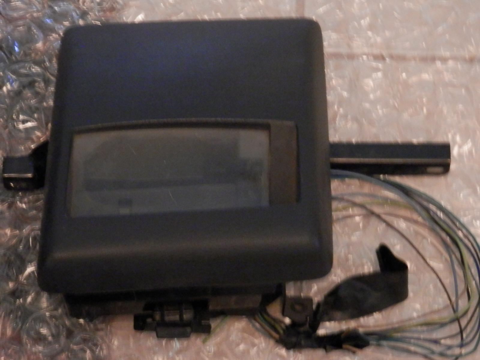

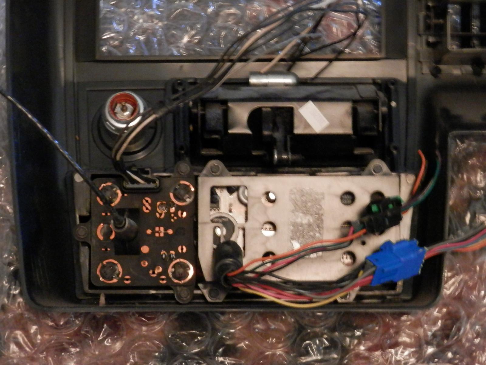

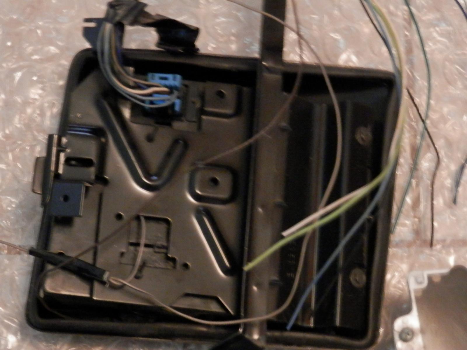

Here are some pics of what I have. If there is something else that I need please let me know.
I have the factory HUD dash as well. What type of connecters would you reccomend?
Actually looking at the pictures you have posted you already have the proper connectors on the prices you have. Now you just need to hard wire them in.
There are plenty of write ups on the boards that have covered this information in depth.
