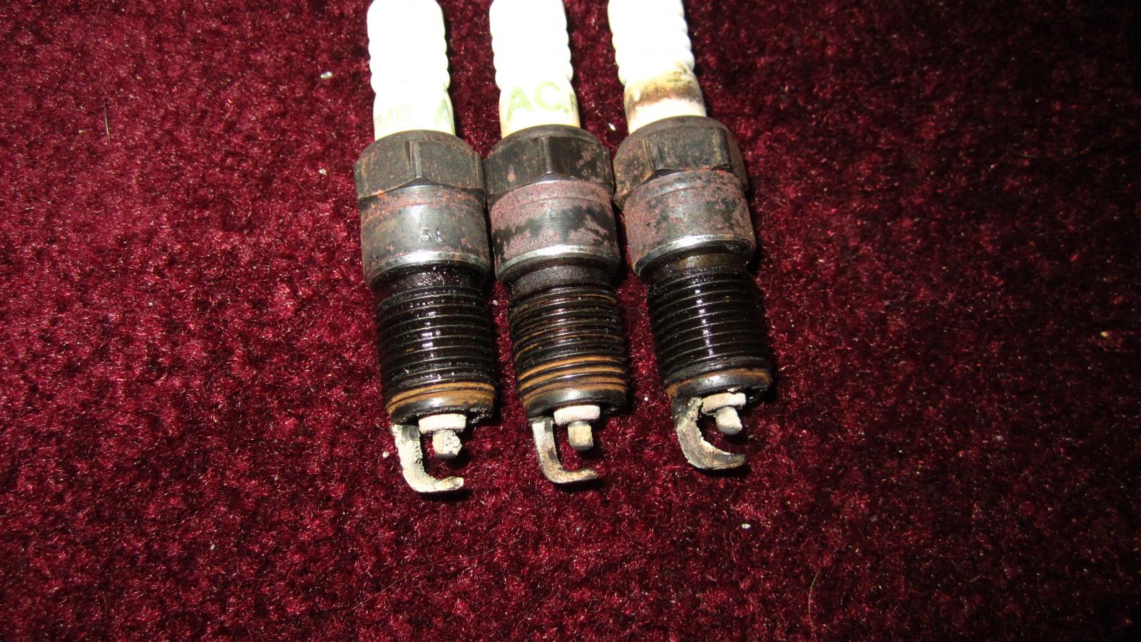

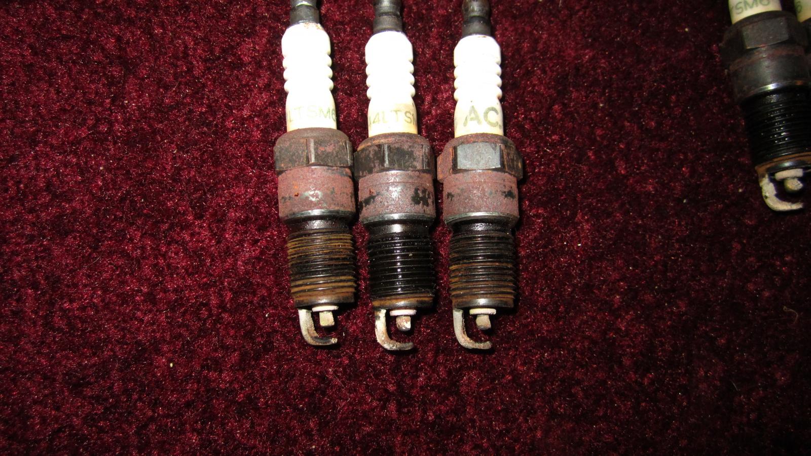

Jprice90 Posted December 2, 2012 Report Posted December 2, 2012 My brother gave me a hand doing them, he has long skinny arms so he helped alot Some of these were gapped at .75, up to .90!! Crazy! Some have some corrosion of some sort and some smelled like paint? Quote
Andrew Posted December 2, 2012 Report Posted December 2, 2012 those looks pretty good considering how old and worn they are. Quote
RobertISaar Posted December 2, 2012 Report Posted December 2, 2012 yeah, that will happen when you run plugs for far longer than they're intended. enjoy the "free" boost in power/economy/smoothness. Quote
WhatTheFehl Posted December 2, 2012 Report Posted December 2, 2012 I don't remember clearly, but I think the ones we pulled out of my old GP's 3100 at just under 100K looked worse than that. Quote
Jprice90 Posted December 2, 2012 Author Report Posted December 2, 2012 LOL, geez I thought I had something interesting here haha. These are by far the worst plugs I have seen, from my other cars etc. and the gaps were no where near as bad Hoping to get a good increase from the new pairs Quote
WhatTheFehl Posted December 2, 2012 Report Posted December 2, 2012 My car's performance remained exactly the same with the new plugs and wires we did at that time. Car ran the same, same fuel economy, etc. We even seafoamed it at the same time as well. Quote
Jprice90 Posted December 2, 2012 Author Report Posted December 2, 2012 well, in my case I used to have a what sounded like lifter tick or something, that sound is gone, it does it a little for maybe a minute but it's very slight, then after that it's gone. It doesnt take as much to get the car to move anymore either. I'm pretty happy I got to get them changed. God knows how old they were before I bought the car. Quote
Garrett Powered Posted December 2, 2012 Report Posted December 2, 2012 the back 3 plugs in my red tgp were OEM and the car had 98k. they were about like that. the thing was I was getting 30mpg on the way back driving across the state. Quote
Jprice90 Posted December 2, 2012 Author Report Posted December 2, 2012 yeahh lol, I was suprised I was even getting the MPG I was. I was getting like 23ish. Wonder if it will improve Quote

paulo57509 Posted December 3, 2012 Report Posted December 3, 2012 Here's one of mine with 42k miles compared with a new one. Both are NGK "V" power plugs. Not much of a "V" left after 42k miles. No misfires and I was still getting over 27mpg highway. The gaps did open up close to 0.060" (spec is 0.045, IIRC?) Quote
GtpKo Posted December 3, 2012 Report Posted December 3, 2012 One thing is that it puts more stress on the ignition system since more voltage is required to jump the higher gap. Quote
Schurkey Posted December 3, 2012 Report Posted December 3, 2012 It doesnt take as much to get the car to move anymore either. If the engine was misfiring with the old plugs, you can just about bet the catalytic converter is damaged from excess heat. Quote
Jprice90 Posted December 4, 2012 Author Report Posted December 4, 2012 One thing is that it puts more stress on the ignition system since more voltage is required to jump the higher gap. Hopefully I didnt screw anything up driving like that. Quote
