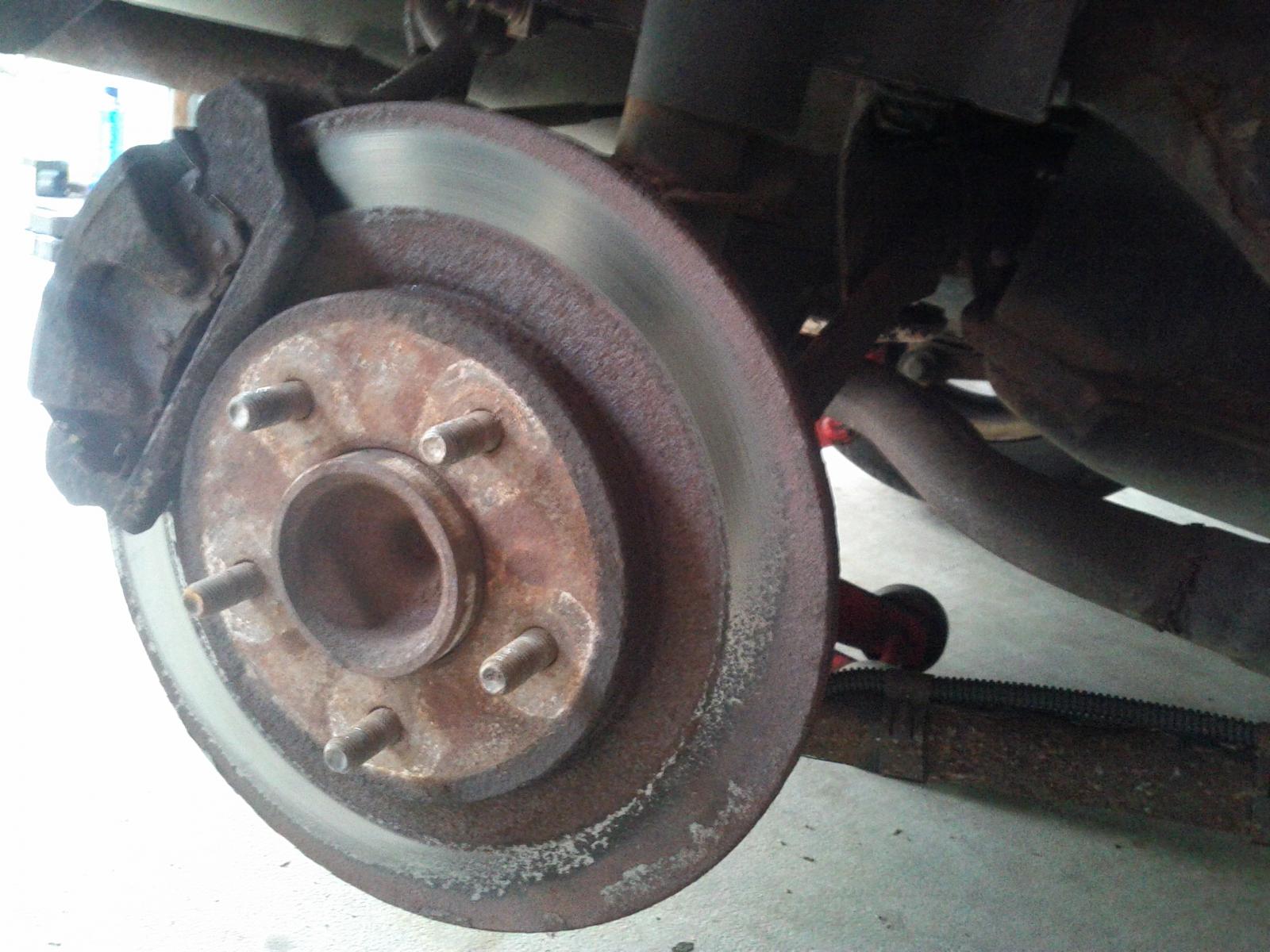

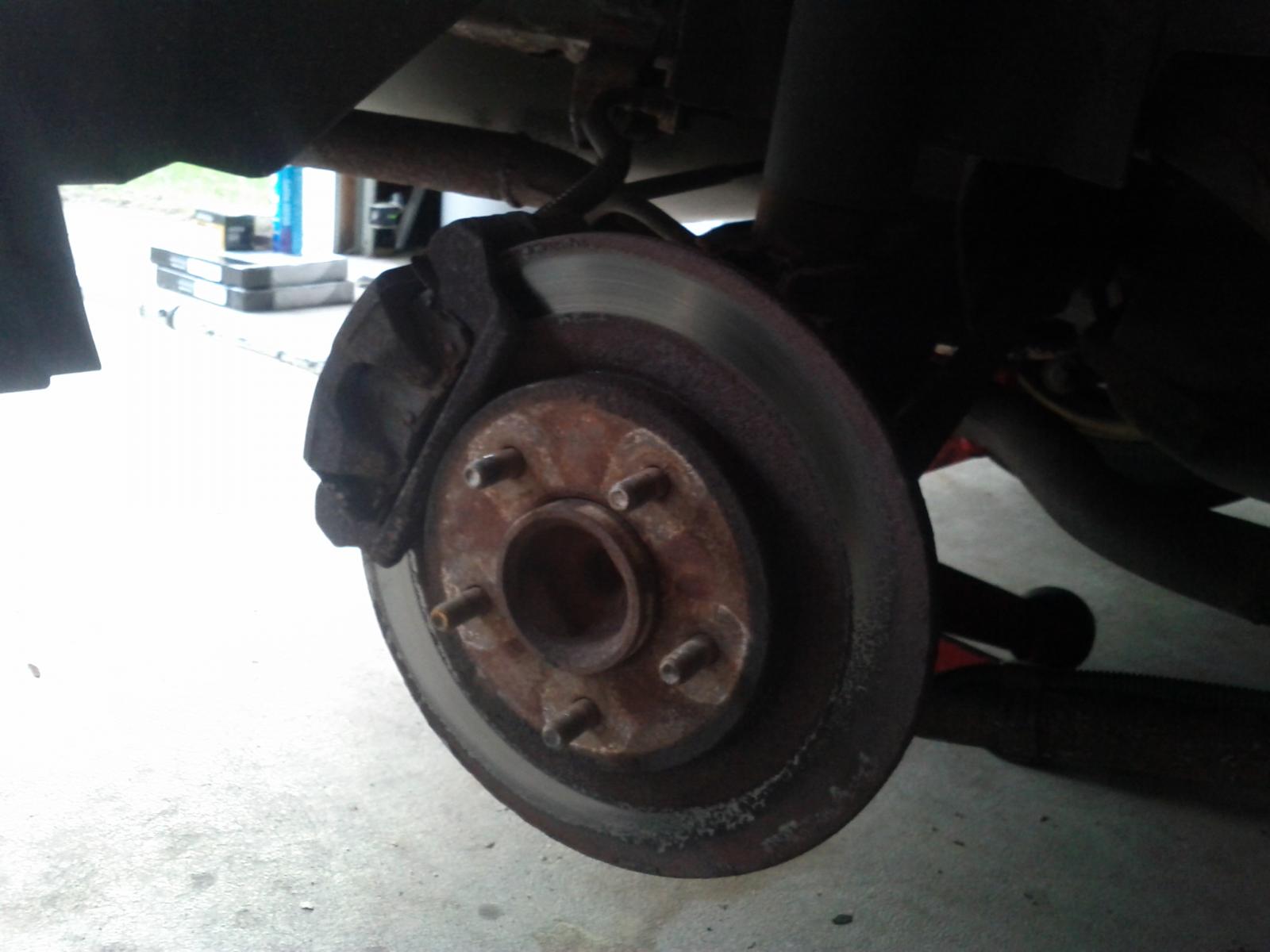

Silentkillzr Posted November 18, 2012 Report Posted November 18, 2012 Officially i hate doing first gen w-body brakes. Ever time ive done them i have ran into issues. Todays issues. I removed and installed new brakes on passenger side rear ( discovered a bad hub, will fix later ) everything works fine on this side. I removed and installed new brakes on drivers side rear... Slide pin/pivot point has seized and literally takes a hammer to move up and down. I was able to change rotors via removing the caliper with bracket. Now my drivers side rear is literally stuck from the slidepin not moving. Well the fix is for another day, i shall post results. I dont know really what todo to get it out, ill figure it out im sure. Sledge hammer or something haha Quote

Silentkillzr Posted November 20, 2012 Author Report Posted November 20, 2012 My drivers rear refuses to even come off. I can easily get the bottom sliderbolt out but the top wont give at all, i had to hammer it up just to take the brakes off and whatnot. Should i just pound it off? Quote

19Cutlass94 Posted November 20, 2012 Report Posted November 20, 2012 You got the one bolt out, thats half the battle. Now just pop the caliper straight up and puch back. But as bad as those calipers look, rusted wise, it may not be an easy chore. Quote
