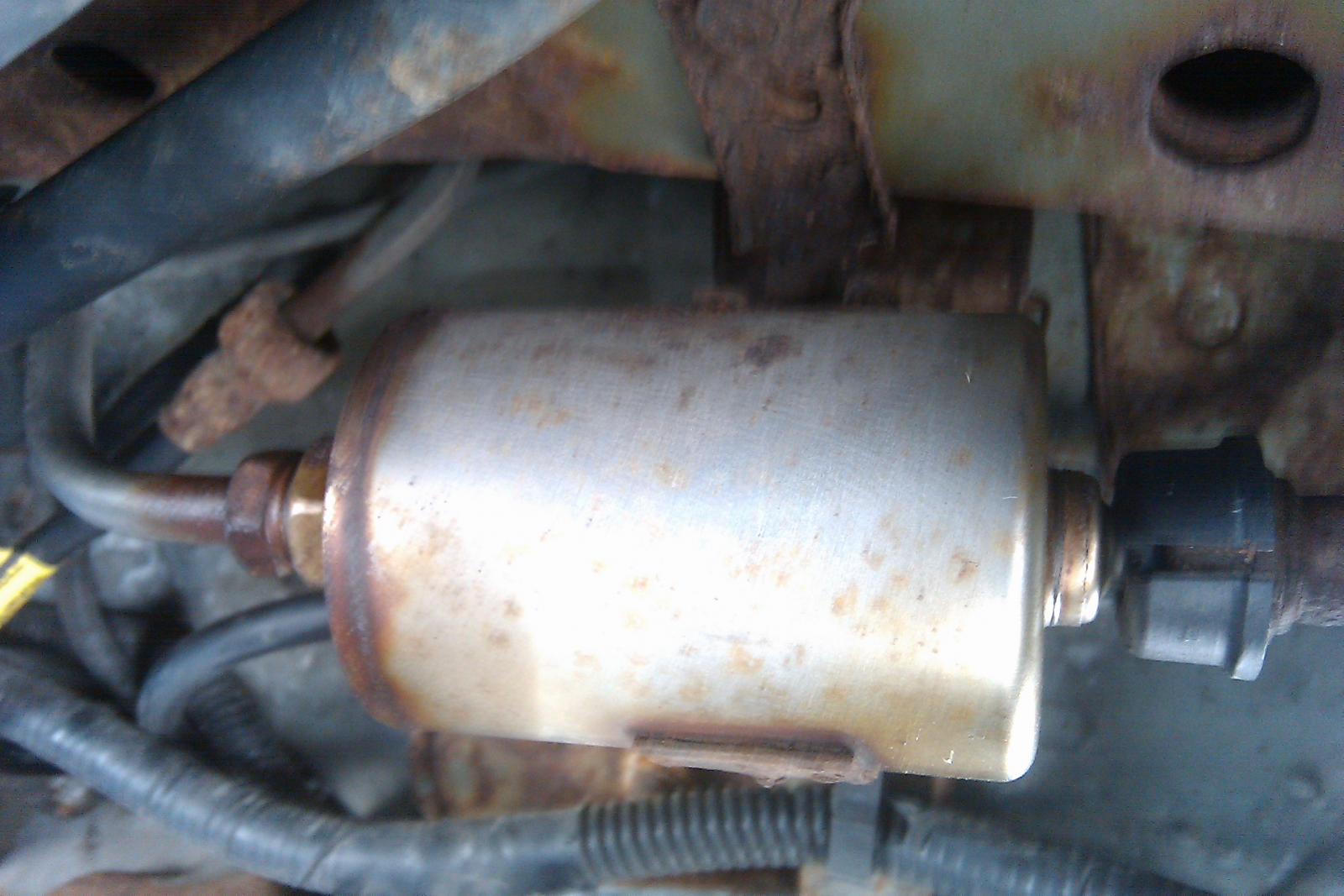

broken plastic clip on fuel filter/98 achieva

cut it off and replace it. The plastic part that was broken is part of the disconnecting mechanism. Cut the fuel filter and pick the rest of out of you lines, dont damage the lines or you`ll have a bigger job.
You MIGHT and i mean MIGHT, be able to modify it enough to run just normal rubber vacuum lines with clamps and size adapters. Wont be able to tell you for sure unitl tomorrow when i can get under my Cutlass, not an Achieva but the setup and fuel filter look looks the same. Doubt theres many dedicated Nbody forums but i havent ever had to look. Rubber hose should be fine as some of the lines dealing with fuel and fuel vapors on my car are rubber and have been for 6 years and over 80k miles.

Thanks guys, I woke up last night thinking cut it off too. W body , N body all the same but less weight lol :dance:
