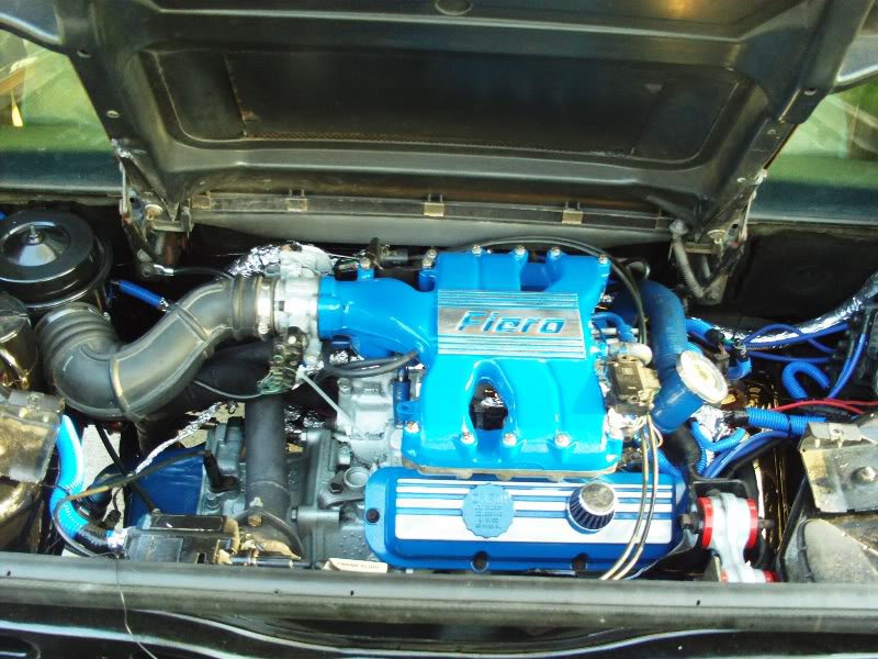

tazman11683 Posted November 13, 2012 Author Report Posted November 13, 2012 gm 3400 block with a 2.8 top end done long ago and running great note that there is no distributor and all fiero 2.8's have them thats cuz its a 3400 under there and he decided to run coil packs also the 3400 bottom end is a very common swap in the 2.8 chevy s10's Quote
