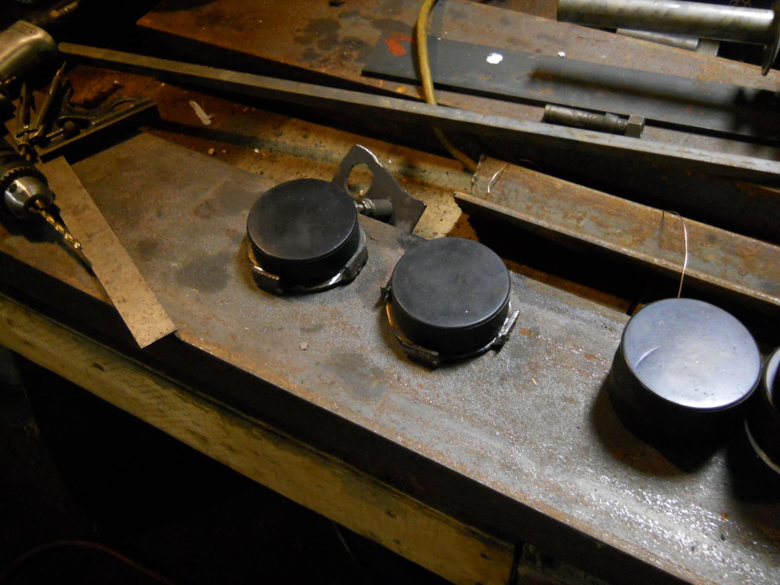

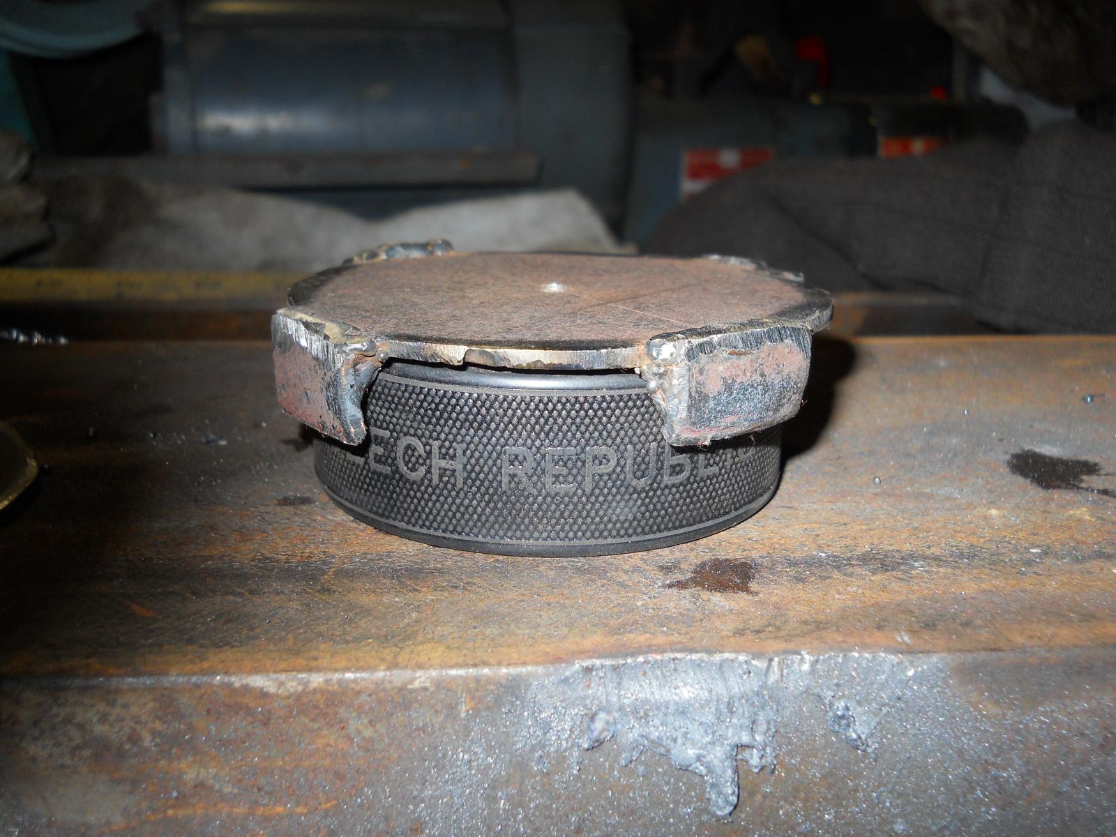

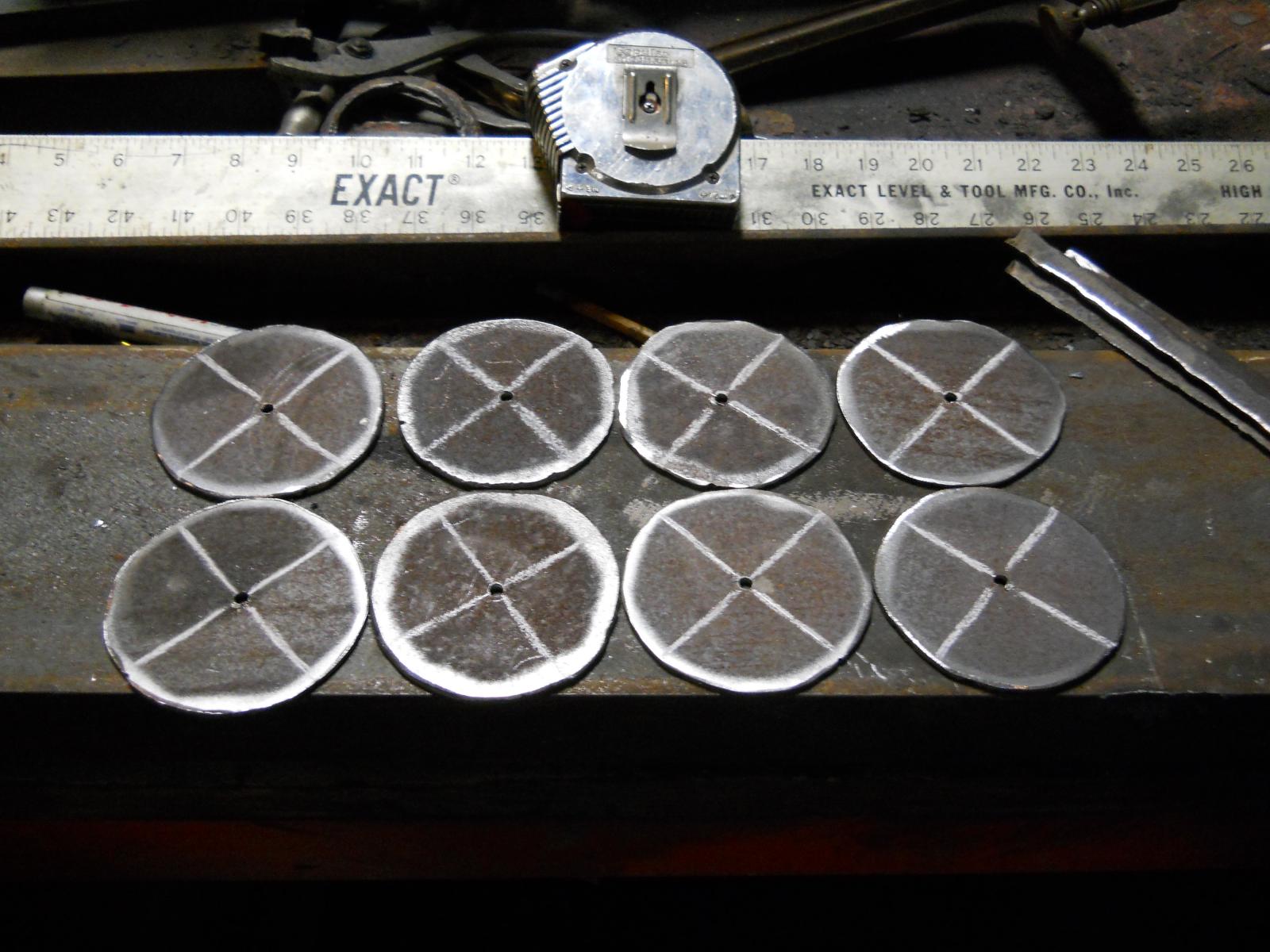

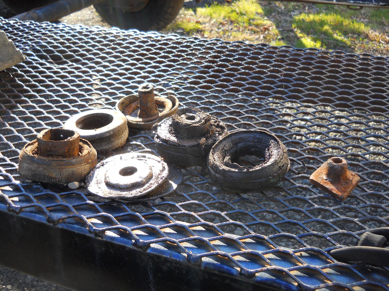

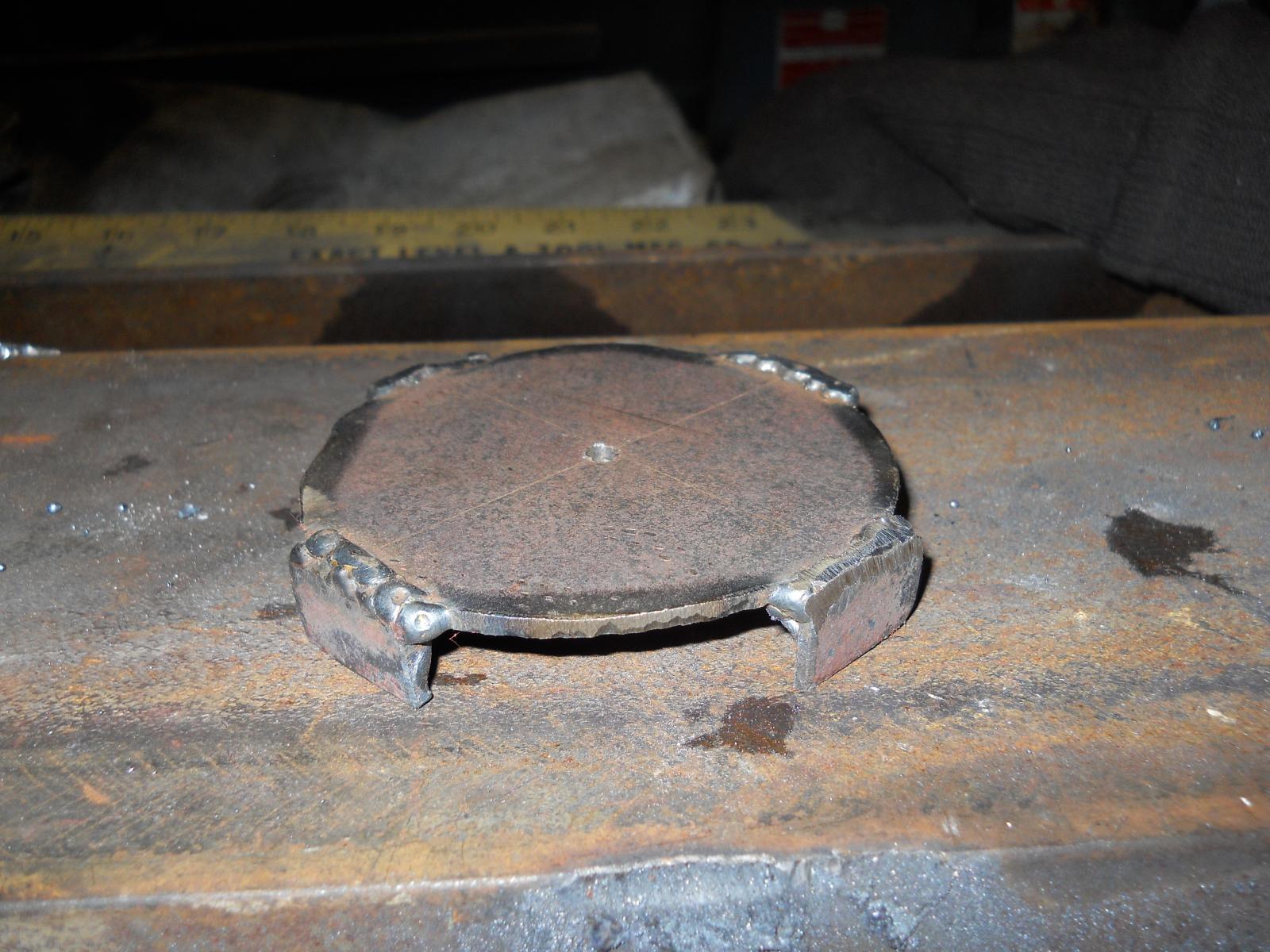

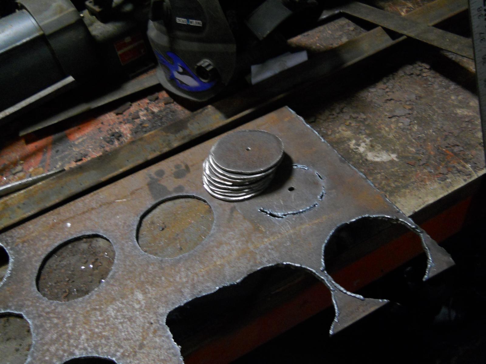

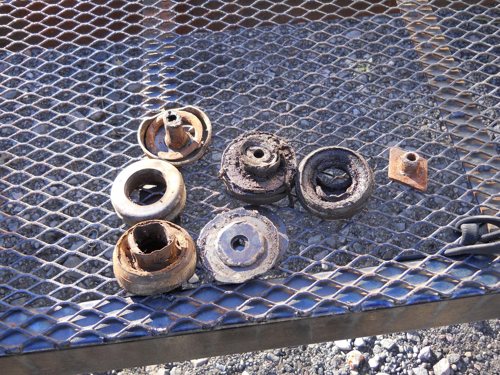

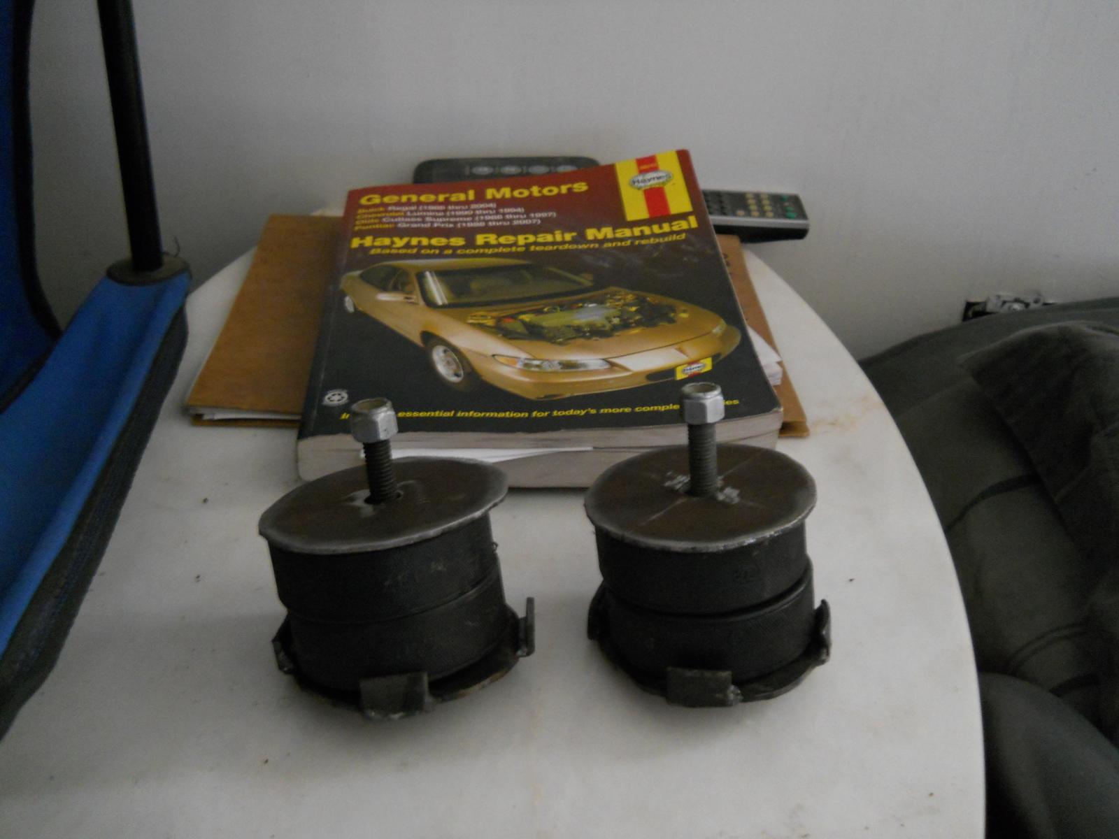

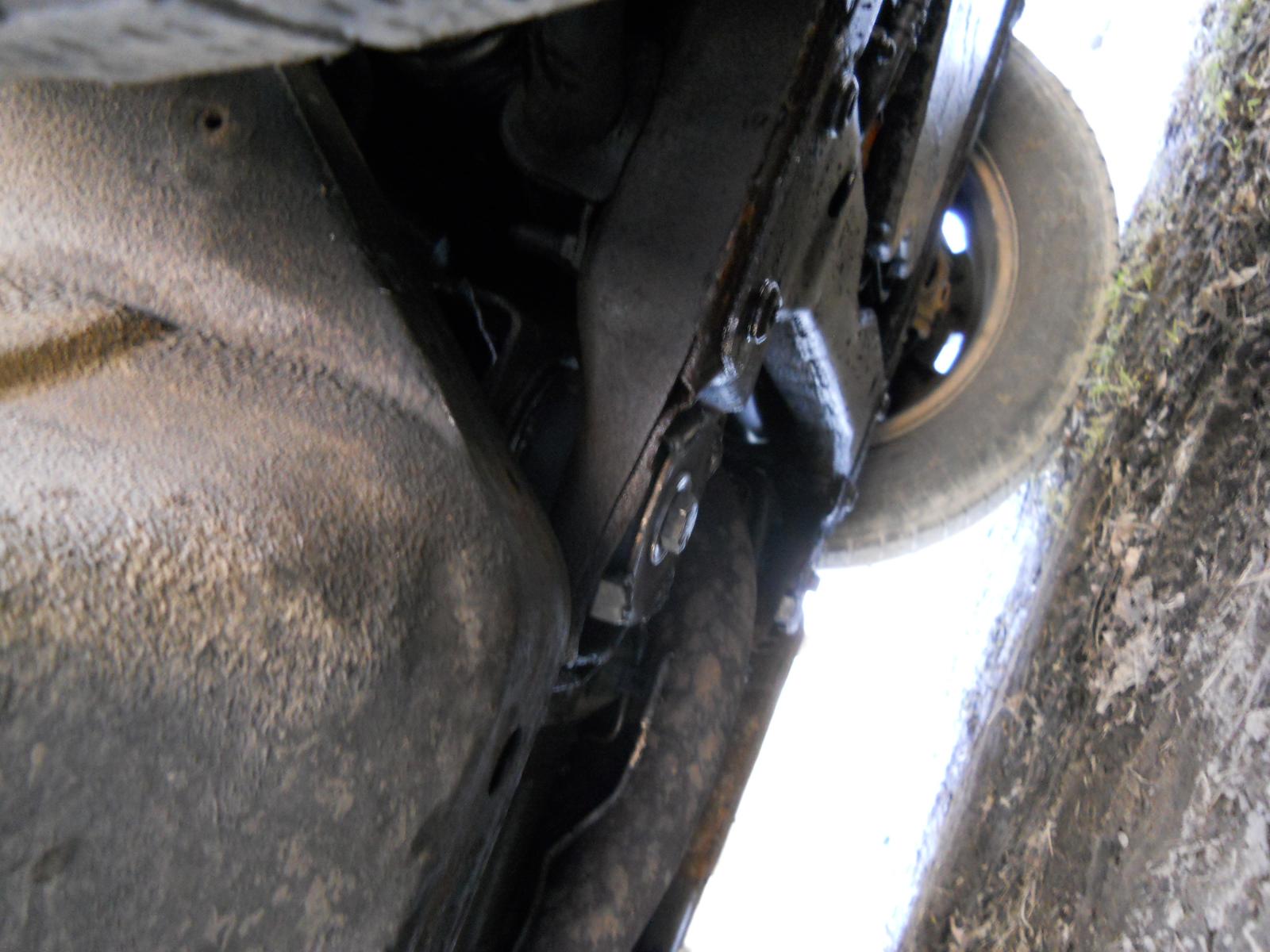

[ATTACH=CONFIG]11003[/ATTACH][ATTACH=CONFIG]11004[/ATTACH][ATTACH=CONFIG]11005[/ATTACH][ATTACH=CONFIG]11006[/ATTACH][ATTACH=CONFIG]11007[/ATTACH][ATTACH=CONFIG]11008[/ATTACH][ATTACH=CONFIG]11009[/ATTACH][ATTACH=CONFIG]11011[/ATTACH][ATTACH=CONFIG]11012[/ATTACH][ATTACH=CONFIG]11013[/ATTACH]the urethane guys didn't get back to me yet so i looked around and found some universal body mount kits from energy suspension, but since i need to drive my car.... i built these to get me through til the new parts show up( yes those are hockey pucks). that diamond shaped captured nut was stripped so the stock bolts were out of the question, but after alot of prying and swearing at the world... i got it out and now i have grade 8 1/2 inch bolts in there. i think they'll hold for now. they are definitely an improvement over the rotted stock bushings i took out.
nothing really im hoping the rubber on metal contact will be enough for now. the new bushings come with a sleeve that slides up through the urethane and the bolt goes up through that. ( i may have to modify it because the sleeve is a little smaller than the hole in the cradle)
