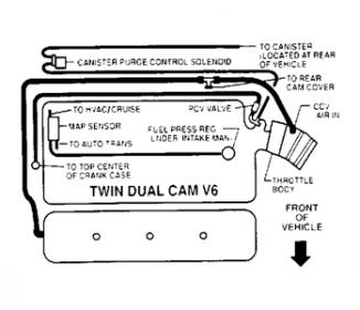

BlkndGoldCutlass Posted November 12, 2012 Author Report Posted November 12, 2012 Here is a diagram for the pcv on the 3.4 Quote

BlkndGoldCutlass Posted November 13, 2012 Author Report Posted November 13, 2012 Yeah fuel pressure is at 47 psi and looks good, Replaced the hose that the pcv valve is hooked up to cuz id looked worn. that seemed to fix a majority of it but im still concerned about the oil in the pcv valve. Quote
Night Fury Posted November 14, 2012 Report Posted November 14, 2012 Oil in the pcv valve is normal, that's what that system is Quote
rich_e777 Posted November 14, 2012 Report Posted November 14, 2012 if you had a 3100 i`d tell you to put splash shields in your valve covers but with a LQ1(your case) im not sure how the pvc system is hooked up. One end of it is going to be dumping air back into your system for consumption, the other end is going to be sucking air from your engine. Find the end thats doing the sucking and identify why/where excess oil is coming from. If its so much oil that its going to effect engine operation your spark plugs will show. Run the engine for awhile drive it down the streeet and back then let it cool enough so you can pull a plug safely without damaging the cyl. head and wipe it off on a paper towel. Identify what wiped off the spark plug. Bad idle and bad gas mileage with no codes is starting to sound like youve got internal damage to your engine. Bent valve or pushrod maybe, fingers crossed its not and im just wrong on that. Quote
