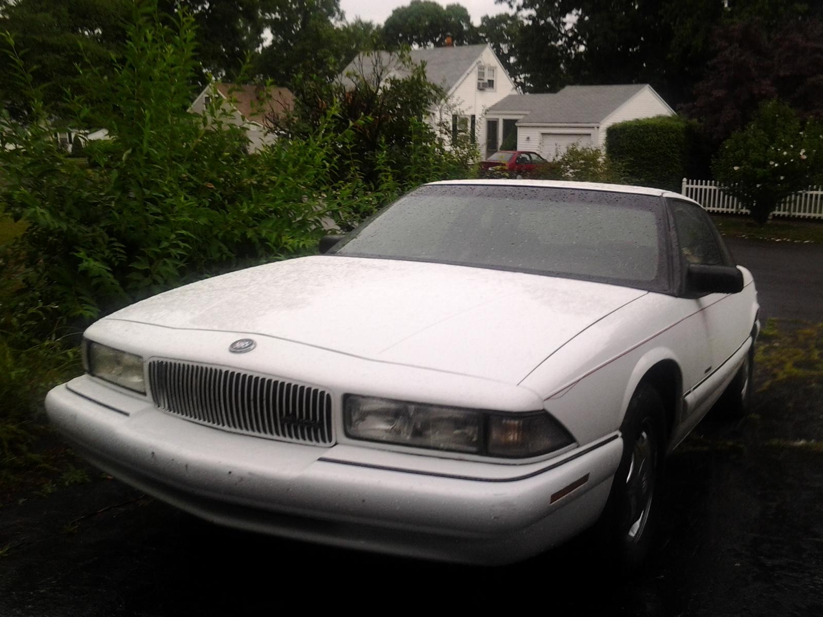

Too good to be true....my GS is really only a Custom
DOH!
I should have known when I took the test drive. But I had only ever driven Gen 1 3.8L Regal gs's before. So the gen II I bought seemed quick enough, and it was badged correctly. Even the online VIN decoder called it a GS.
I got thirty two miles per gallon driving it back from Chicago. That should have told me,. too. My two previous GS Regals never got more than twenty-six.
This is the car I replaced all the sub frame bushings on,. and the sway bar bushings. No wonder I had only a one and an eighth inch sway bar.
Now I finally got the service manual. It was a Custom, ordered with the painted grille, sport bumpers, sport wheels, FE3 suspension. Since I bought it from the second owner who had bought it for his teenager, I doubt he tried to rip me off. Probably the dealer took off the Custom stick-on emblems, and put on the GS ones.
The main difference, the one that's making me hurt inside, ( not really, just a car), is the final drive ratio. three point oh six. SlOOOOw.
I see that is possible for me, of limited skills and tools, to remove the final drive assembly from the transaxle. Now I go to search the interwebs to find out if there is somehow to change it to the FW9 option, 3.43.
Thank Goodness I didn't take it to a Buick Club meet yet. Those guys laugh you out of town if your lug nuts are the wrong type.
There's an '88 Regal Limited for sale around here for a grand. Maybe I'll hot-rod that one, and keep this one for trips. It really is quite smooth and quiet with all the new bushings, and the new hubs in the rear.
If anybody wants, I have a 1996 Service Manual for W-body's, both volumes, and would be happy to share option decoding or anything else.
and.... I think you are crying over nothing.... It is likely a GS in sprite of what you claim.... what year car are you talking about? You aren't clear....
It's the 1996, sorry if that wasn't clear. I guess it's a GS if I call it one, I suppose. But it has the option trim code Z7T, model comversion Buick Regal Custom, instead of the Z13, model conversion Buick Regal Gran Sport. And it has the taller final drive, which is what bugs me, and makes me cry.
Whatever possessed you to complain about having a proper 3.06 gear ratio with a 3800 needs to stop right now. Have you never had a 3800 before? they don't need a 3.33 like a 3.1 or 2.8 would have had. You can modify it to run with a 3.33 if you desire, but remember to utter the phrase 'becuz racecar" once you do... and then also realize you will need a custom tune to do that, too, cause your PCM will leave the trans inoperable when it sees a wrong ratio transaxle.
I am skeptical that the same code they may have used in earlier years would mean the same for ALL years. It is probably a GS under the terms of the model year is was made. find another 96 GS and get it';s spid codes and see if it is the same of not.

I did more research, and found out that the 96 GS was supposed to come with the taller gears, and the skinnier front sway bar. So, it is in fact a GS.
I didn't realize the PCM could tell the difference between the 4T60E with the tall gears, and the 4T60E with the shorter gears, though. So, I guess I'll leave it alone. Although, I watched some videos on
, and it seems that the spiders with the shorter gears are much beefier, with four cams instead of three.
My 93 GS, with the series 1 3800, was a lot quicker off the line. but it didn't get thirty mpg, either.
I'm still looking for the thicker front sway bar when I visit the only pick and pay jy near me.
I'm going to try and find a less rusty rear subframe, too. I have been reading the thread about putting adjustable gen II lateral links on. I think I could get the front ones shortened for less than the price of buying two sets of correct ones. With adjustable rear laterals, I can push out the inside bottoms of the rear tires a little, which will help. I also hear that a strut brace does make a difference in the rear.
I don't understand how to do that for the front tires, though. How do you add negative camber there? Keep in mind, please, that I can barely comprehend this article: EDIT: I found some nice looking camber adjustment mounts Here, at overkill engineering.
