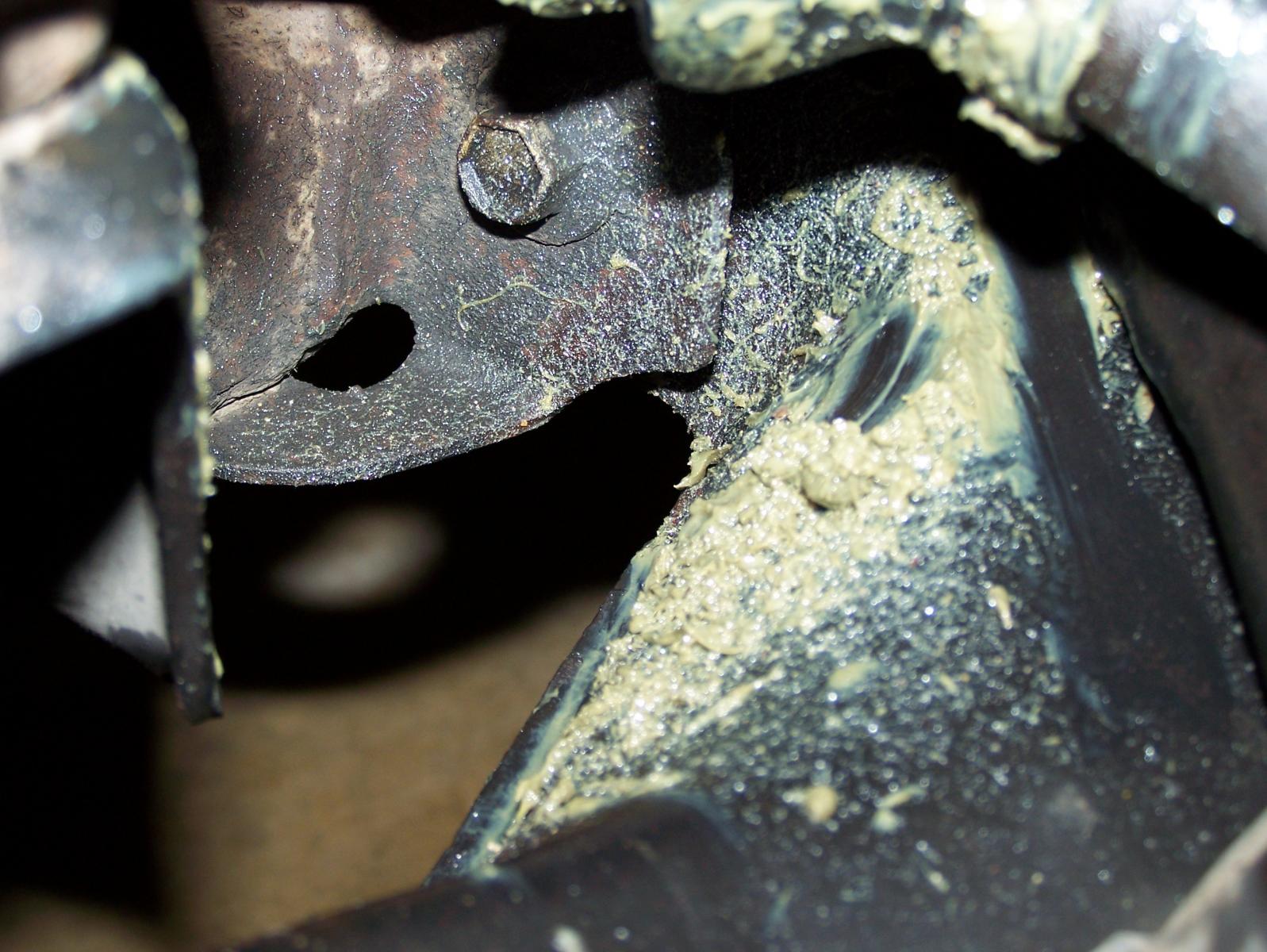

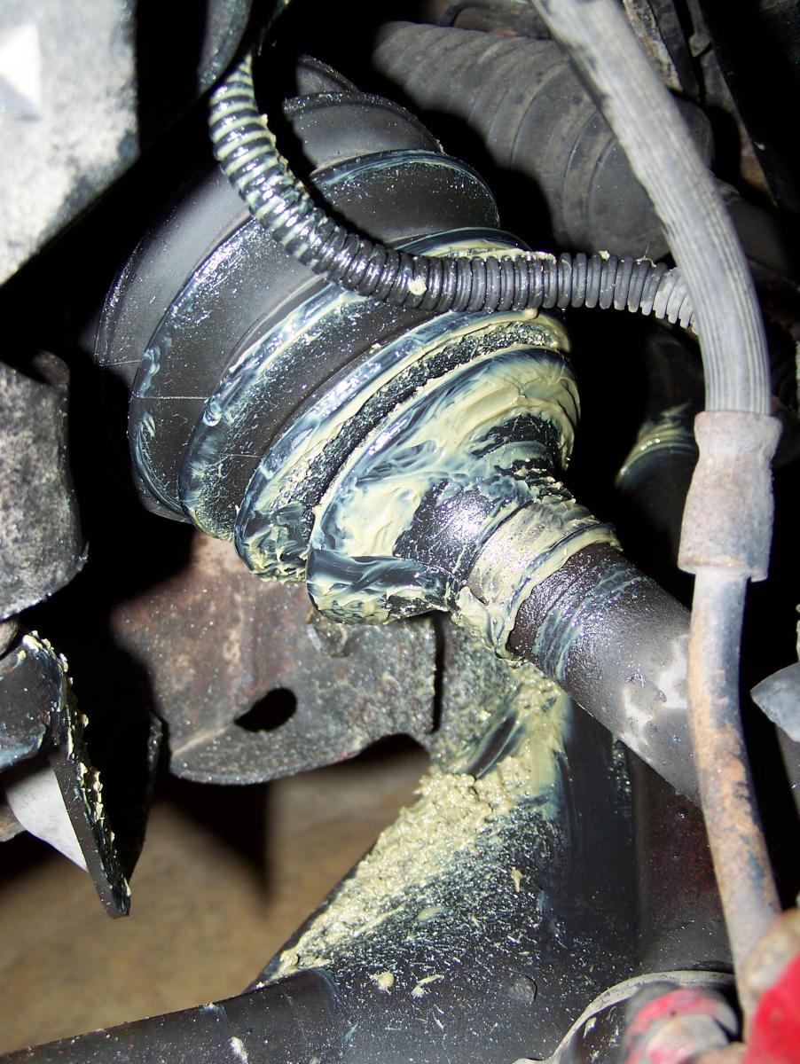

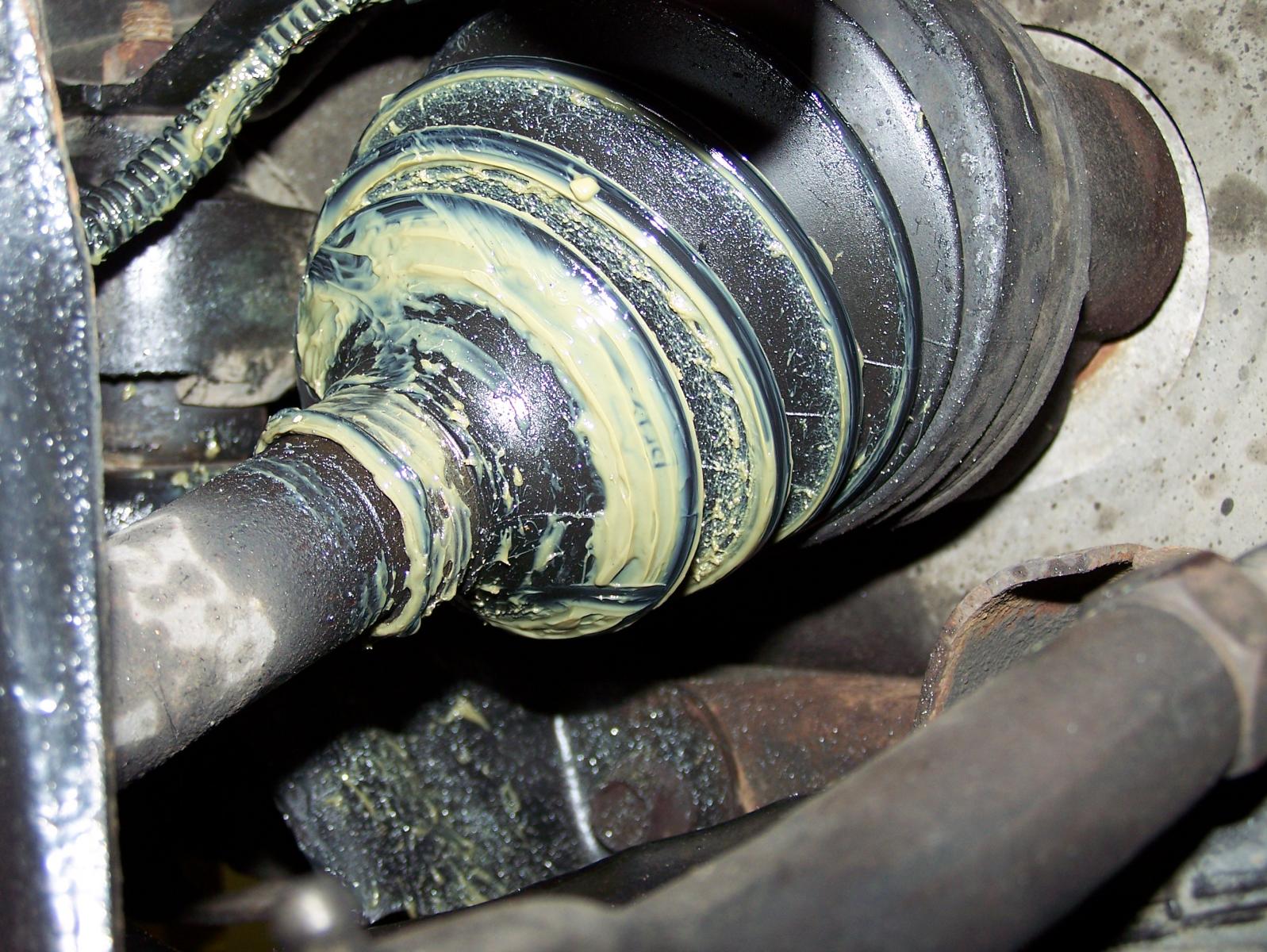

67eleanorgt500 Posted October 26, 2012 Report Posted October 26, 2012 I'm pretty sure this grease is a indication that I have a possible broken CV/Axle Boot. The grease is lime/army green and odorless. But just to be sure I have provided some pictures to help with the diagnosis. So if anyone could tell me I'd appreciate it . Quote
67eleanorgt500 Posted October 26, 2012 Author Report Posted October 26, 2012 Just found the problem. My boot is cracked around the edge resulting in the grease leaking out and splattering everywhere. Do they offer boot replacements? Or do I have to replace the whole axle? Quote
94 olds vert Posted October 26, 2012 Report Posted October 26, 2012 You should be able to buy replacement boots and put then on separately. There shouldn't be a need to replace be whole axle. Quote
