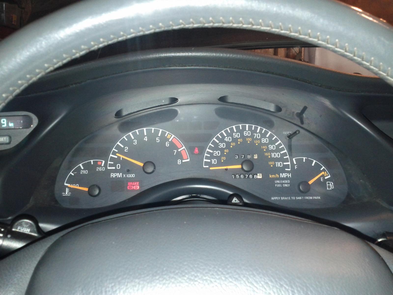

Silentkillzr Posted October 11, 2012 Author Report Posted October 11, 2012 YESSSS!!!! i got the delphi knock sensor in today, tested before install ~3900 ohms perfect, put it in, no more SES lights, car runs fucking amazing!!!! Thank you so much robert for your help, i love you. You should get member of the year for this! Quote
