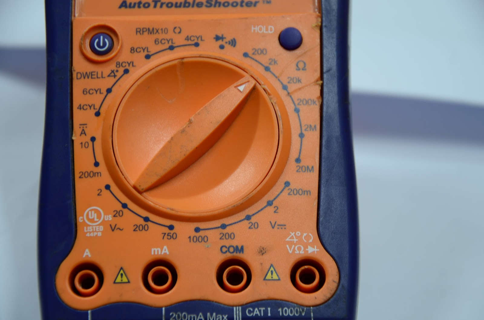

Silentkillzr Posted October 4, 2012 Author Report Posted October 4, 2012 (edited) Which multimeter setting should i use to clarify? This is the multimeter i have: Edited October 5, 2012 by Silentkillzr Quote
RobertISaar Posted October 5, 2012 Report Posted October 5, 2012 the 20K resistance setting, since the sensor SHOULD spec out to 3900 ohms. a 96-up sensor would read ~100K. Quote
