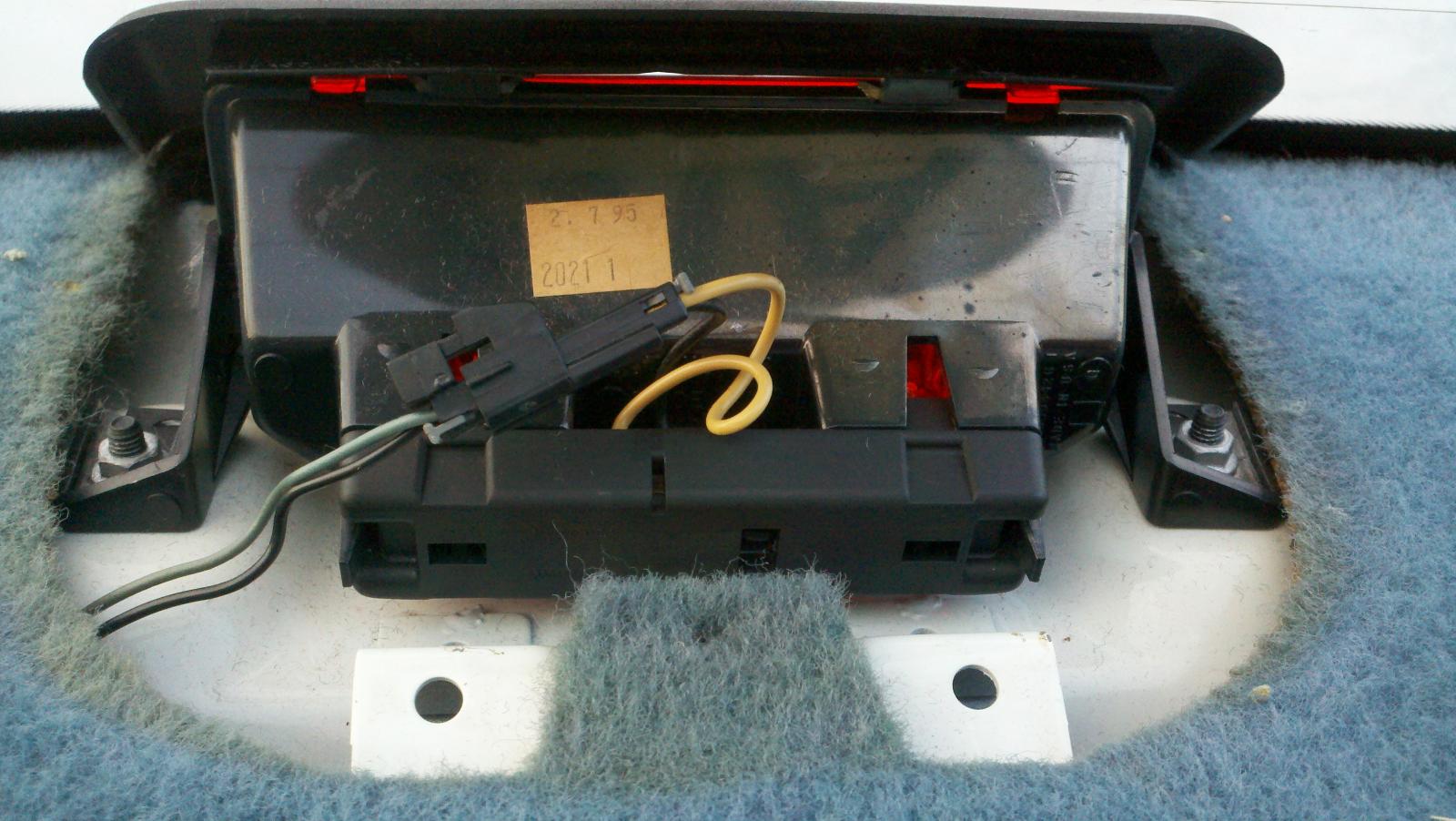

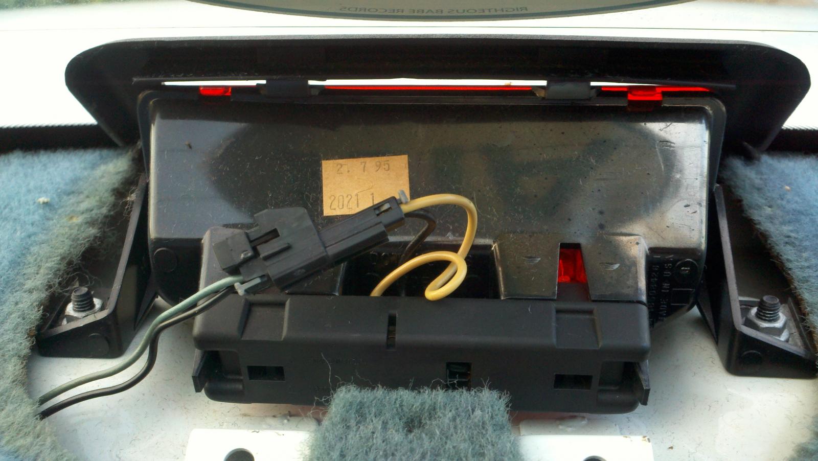

I finally figured out how to change the third brake light / high mount brake light bulbs on wife's 95 Regal.

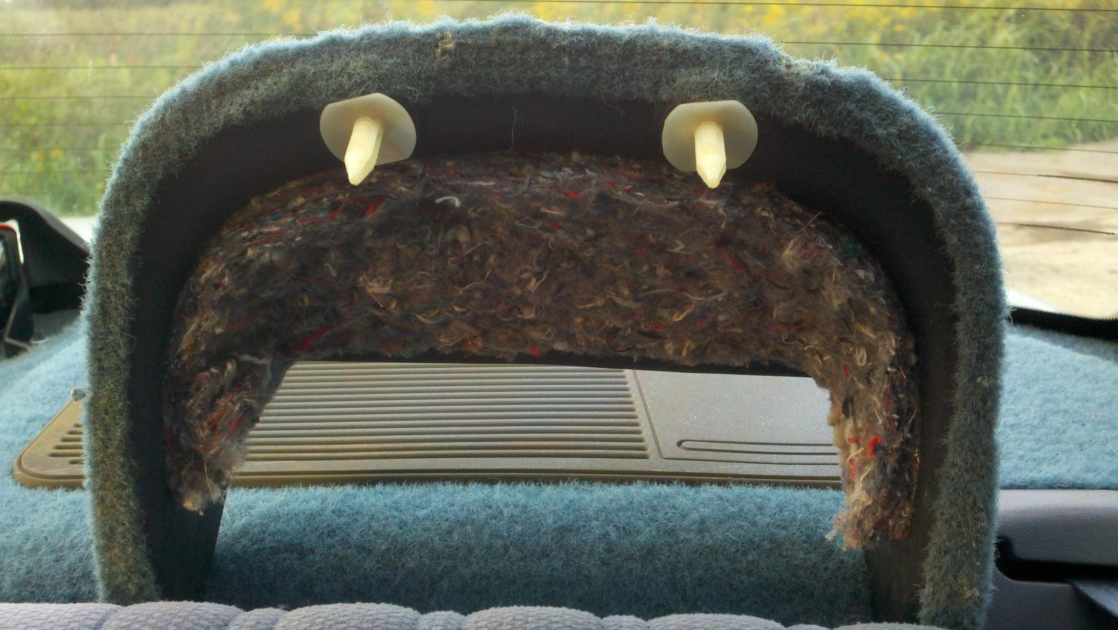

The housing is held in by two christmas tree push retainers. Just pop it up and back.

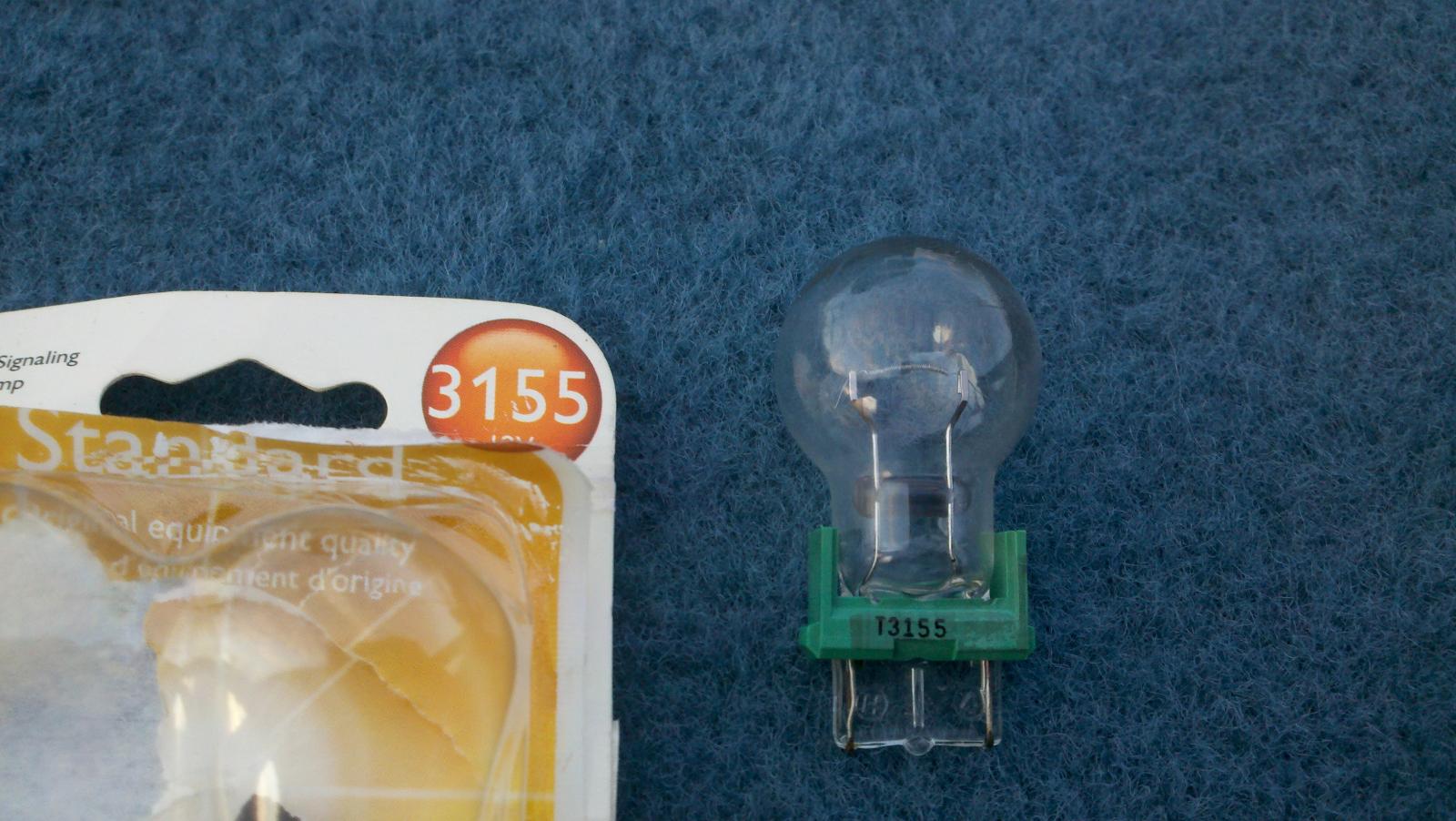

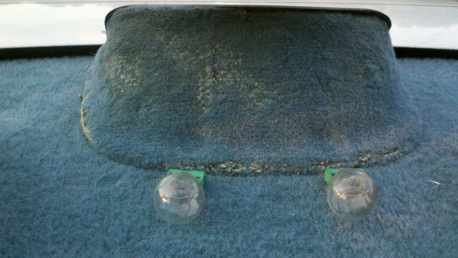

Two bulbs, 3155's.
