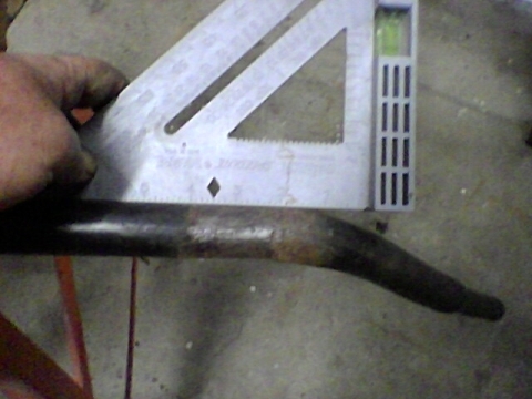

pshojo Posted October 2, 2012 Report Posted October 2, 2012 I might have one. Do you know where the measurement should be taken from? It looks like the bar changes diameter all over the place. Quote
jman093 Posted October 3, 2012 Report Posted October 3, 2012 I thought only DOHC cars have the 34mm bar. My 2.8L Cutlass was FE3 as well and had the smaller one. I don't know which got the big bar, but I know it was more than LQ1's. My brother's 3100 GP SE coupe has the same big bar as my LQ1. I just put some poly bushings on it. I reordered the same ES part number as when I did my GTP. I might have one. Do you know where the measurement should be taken from? It looks like the bar changes diameter all over the place. Yeah, it necks down out over the control arm. It's measured there in the main part of the bar where it's thickest. Quote

pshojo Posted October 12, 2012 Report Posted October 12, 2012 Ok, did some measuring both my cutlass Dohc has 36mm bars. I do have spare, but it measures 33mm . I'm going to start taking my caliper in junk yard. There is one in Dohc cutlass there , Quote
