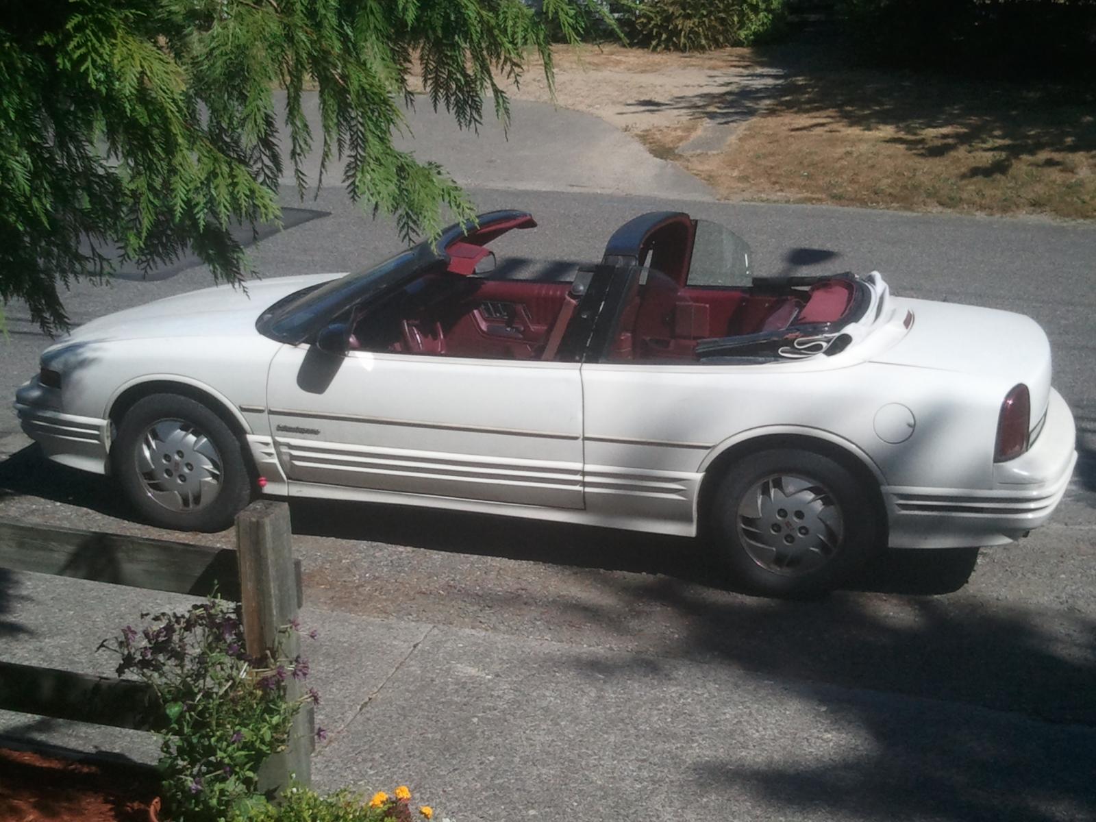

mdoffing Posted September 29, 2012 Report Posted September 29, 2012 So I recently inherited a 1992 Cutlass Supreme Convertible with the 3.1 from my grandmother and it's got this odd acceleration problem. When I press the gas pedal the car feels like its about to die (RPMs drop and engine goes silent briefly). Depending on how hard the pedal is pressed it will either die at this point or push past it and run normally. As for other problems, it's got a rough idle and I don't get very good gas mileage (well, worse than the car already gets.) With the exception of the this issue the car is in beautiful condition, and I'd love to get it back to good working order since it's such a classy and rare car. She's got about 165000 miles on her. Feel free to get technical. Here is a picture of the car because I know people will ask. Quote
94 olds vert Posted September 29, 2012 Report Posted September 29, 2012 Is it throwing a service engine soon light? That is a cool car. Nothing like dropping the top in a first gen. Quote
