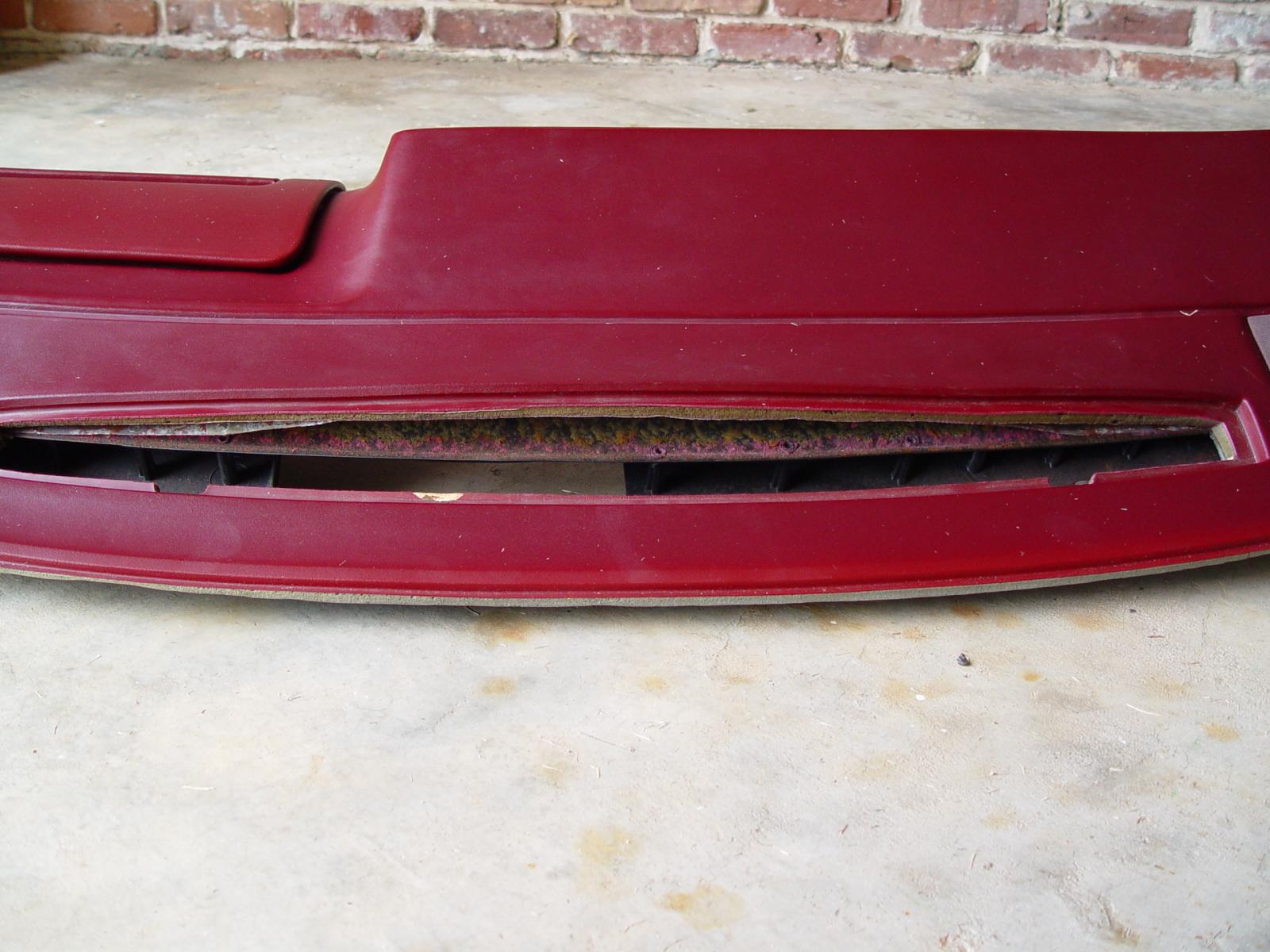

GnatGoSplat Posted September 28, 2012 Report Posted September 28, 2012 Glue doesn't really work for very long. Screws will do the trick. Here's a 12yr old pic when I did this on the 88. I've done this on all of them since. It holds up. I covered the screws with a strip of black electrical tape. You'd never notice it, even looking straight at the vent. Quote

rawdeal91vert Posted October 4, 2012 Author Report Posted October 4, 2012 GnatGoSplatt. What type of screws did you use? A self tapping sheet metal screw? Quote
GnatGoSplat Posted October 4, 2012 Report Posted October 4, 2012 Yep, small Phillips ones with countersunk heads. Quote
