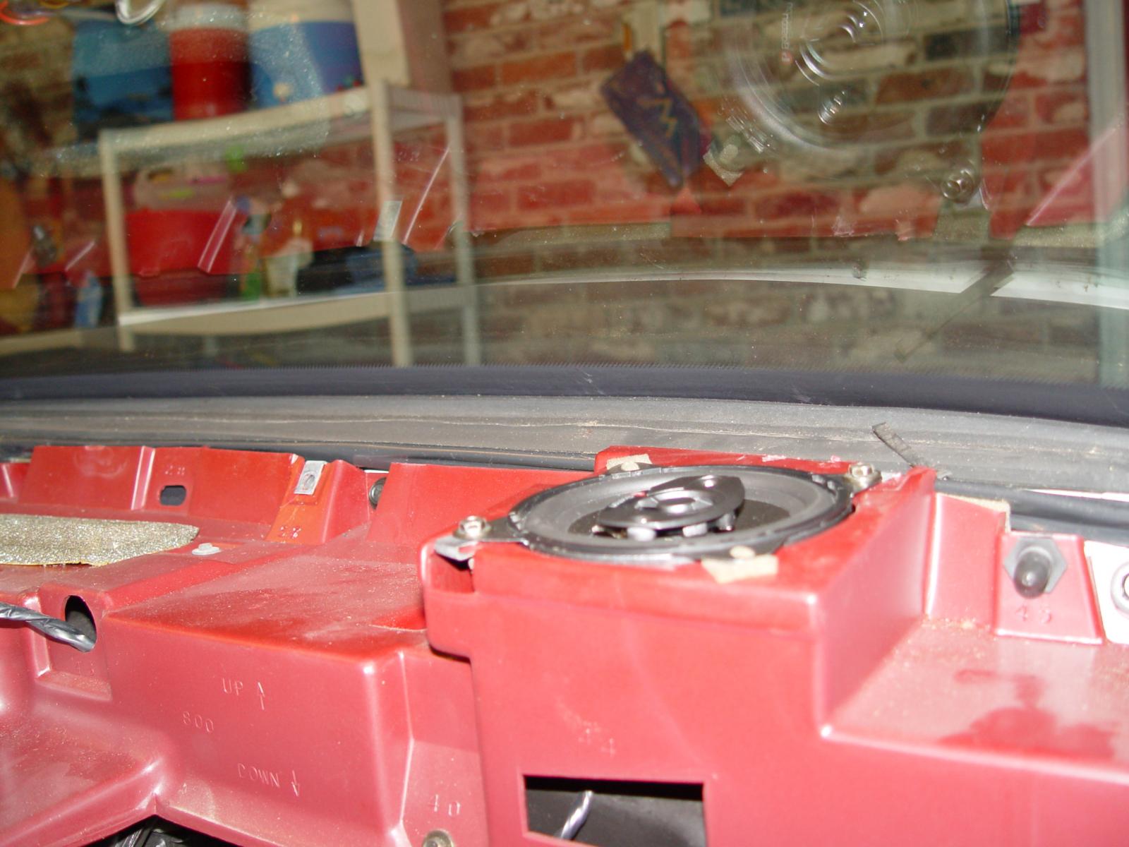

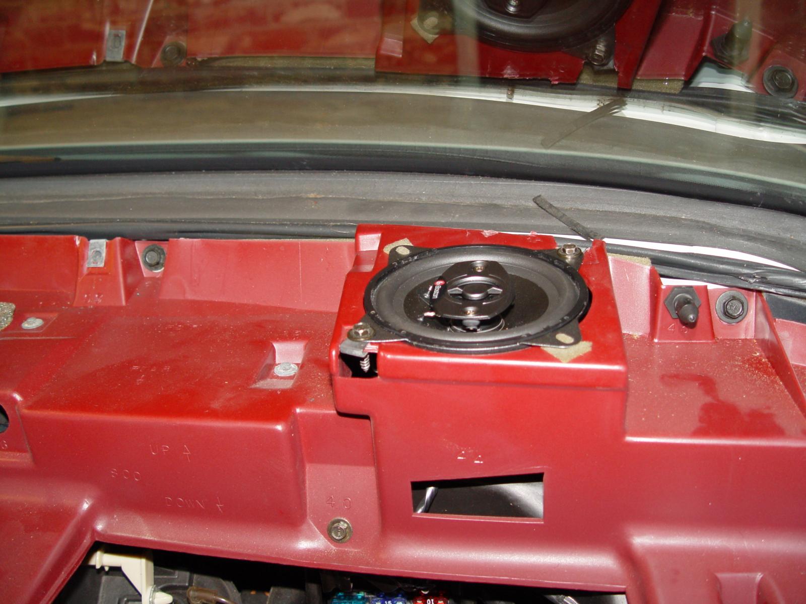

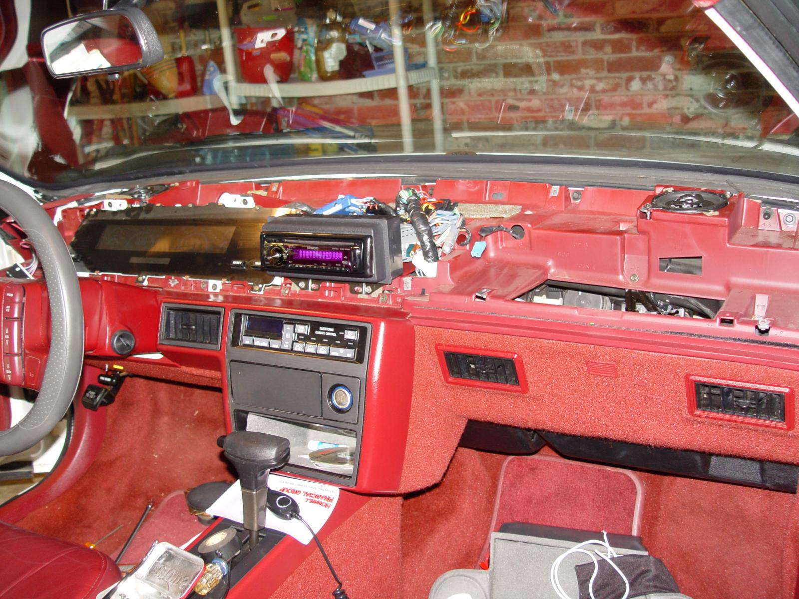

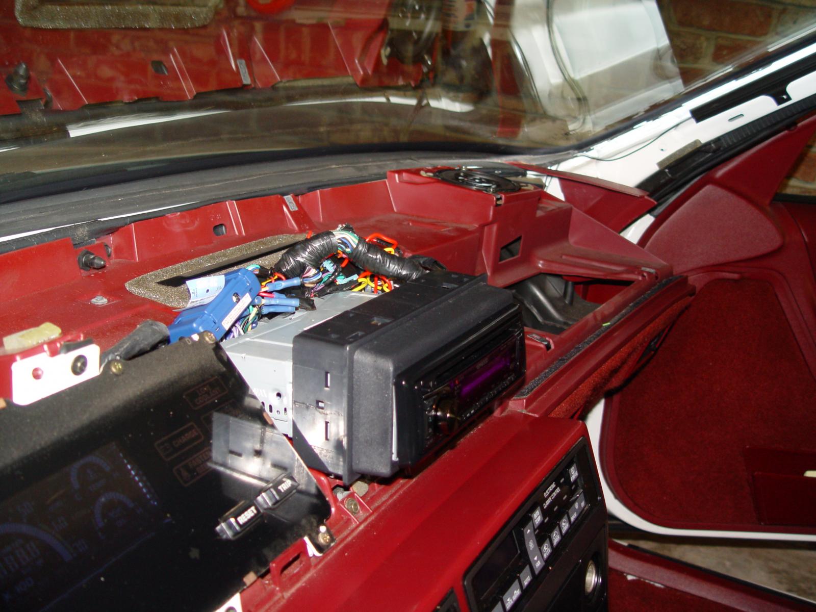

I had my dash out replacing speakers and I thought posting some photos might be helpful to someone:post-7554-143689113156_thumb.jpg
The hardest part was getting the 2 screws out that are inside the defroster vent up against the windshield. I used a 18" flexible extension on a small cordless screw driver. It was not brain surgery but it was tedious. The new Boston Aucoustics sound great up front! The hard part was guessing the polarity of the original speaker wires. The wires in the dash are not black and red. I think I guessed right because they sound good. Hope this helps somebody.
