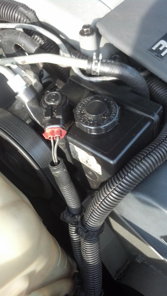

Galaxie500XL Posted September 26, 2012 Report Posted September 26, 2012 If you're planning to change the power steering pump, you're going to run into a problem... '94 and '95 LQ1 Cutlass and Grand Prix used a variable orifice pump...RPO was NV7. you probably noticed a sensor plug in the top of the pump. The idea was to create a variable steering effort, based on speed, and steering wheel angle. NO ONE carries that pump. P/N for the pump is GM Part# 26047158, and for the actuator, GM Part# 26071775, but GM discontinued the pump and actuator years ago.. They're hard to find in junkyards...in 3 years, I've found 2. NAPA told me if I would give them the old pump, they would have it rebuilt....for $250.00, and a 3-5 week turnaround. Of course, you could always put a standard pump on the car, and leave that disconnected, but since it is controlled through the ABS computer, I've been reluctant to try. BTW, if you DO use a regular pump, SAVE YOUR FLUID HOUSING. The housing is slightly different on the NV7 pump on your car, to clear the actuator...you don't want to lose that housing, if you ever found the proper pump, and wanted to switch back. I did "frankenstein" a standard pump once, by swapping all the actuator components from my bad pump to the standard pump. Seemed to work well, but it's a couple hours of work to do so, and you MUST use your original fluid housing to make it work. A little later, I found a good NV7 pump in the junkyard, and put it on the car. Quote
95LQ1VERT Posted September 27, 2012 Author Report Posted September 27, 2012 Previous owners also claimed to of had the pump replaced a time before, however it sounds like it hasn't. I also checked for the "plug" you were speaking of, but i couldnt locate it. There is nothing on or around the pump that plugs into it beside the metal lines that transfers the fluid. A picture would help some. Quote
Galaxie500XL Posted September 28, 2012 Report Posted September 28, 2012 Here's a pic from my car of the NV7 pump..hope it helps! Quote
95LQ1VERT Posted September 28, 2012 Author Report Posted September 28, 2012 Hey I really appreciate that picture! However mine isn't the original so it shouldnt hurt to put in an autozone special hahaha! Btw I still havent got around to doing the tune-up, my work schedule is all whacky. But I will keep it updated. Quote
Galaxie500XL Posted September 29, 2012 Report Posted September 29, 2012 Good luck with it...at least you know what the plug looks like....I'm flying out to Alaska on Sunday, so I'll be offline for about 10 days, but keep everyone in the loop on what happens! Quote
