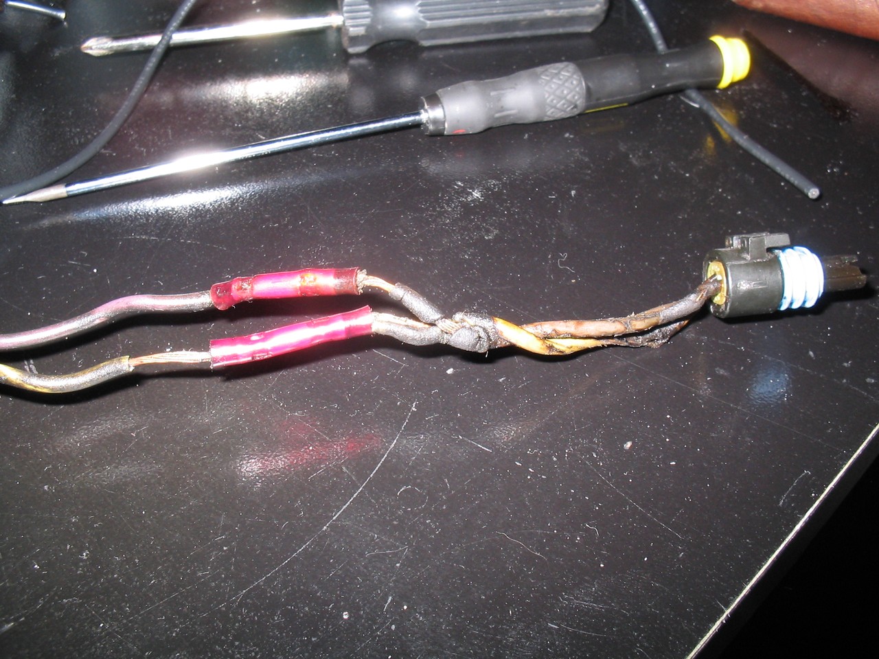

I had an issue with mine at one point. The original owner needed to have the engine replaced (drove it without oil!), and somewhere along the way the original wires were cut and spliced, and shorted out against each other or the block. They also had the wrong connectors on the ICM side and the CKP side connector tab was broken off. It had a two-pin connector and my ICM had a 3-pin plug (with the center pin unused).
So I ended up making my own, you can get both connectors for probably less than $5 shipped from mouser.com. Both ends of mine (92 Cutlass LH0) were Delphi Metri-Pack 150 series connectors. http://www.mouser.com/Delphi-Connection-Systems/Automotive-Connectors/Metri-Pack-1502-Series/_/N-1z0zlezZ1ehb5Z1yzmtmt. The wire I got from a spool of the same approximate gauge, and I also wrapped the whole thing in nylon braid for abrasion protection.
