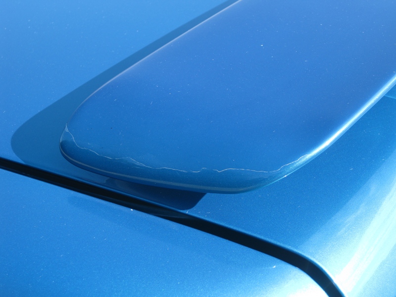

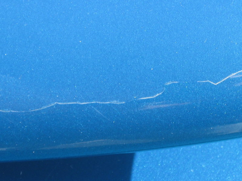

When I picked the car up last fall there was no clear left on the top of the spoiler
There was a very distinct line where it'd been

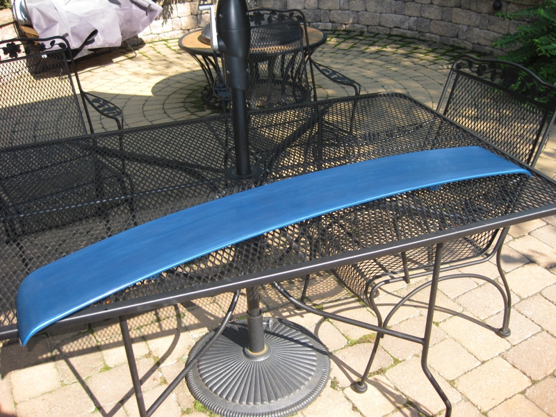

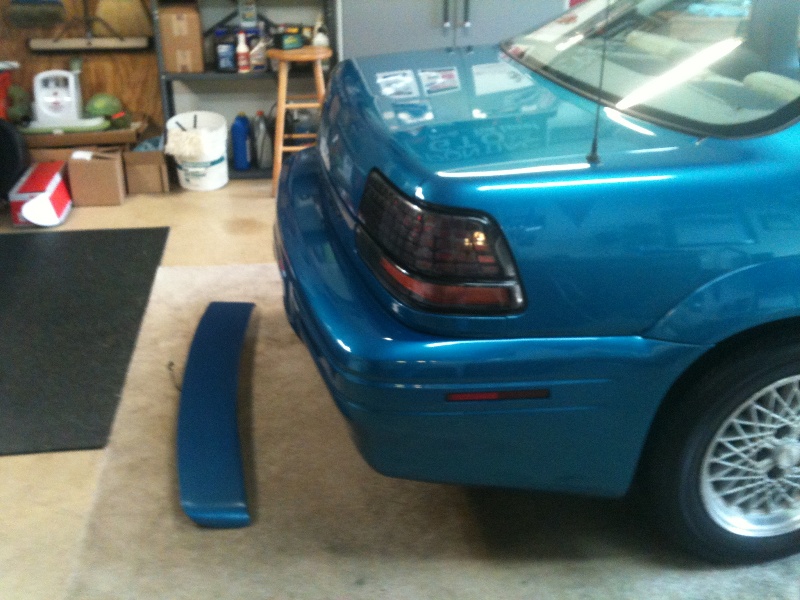

Tuesday afternoon I pulled the spoiler off.
I picked up a rattle can of clear at the local PBE store. Instructions on the can stated to use 320 grit paper to ruff the surface. I wet sanded with 400 grit and quickly realized not only was the clear gone, but most of the base coat. I went through to the primer instantly in the first spot I tried to wet sand! Very carefully I proceeded and still lightened the base coat up in spots.

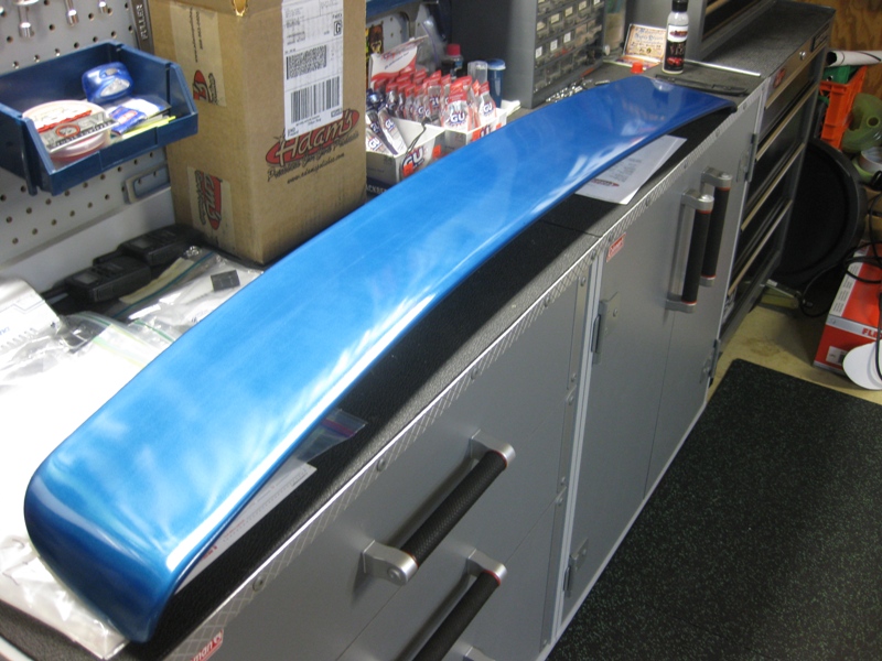

Here it is after four coats of clear were applied yesterday evening.

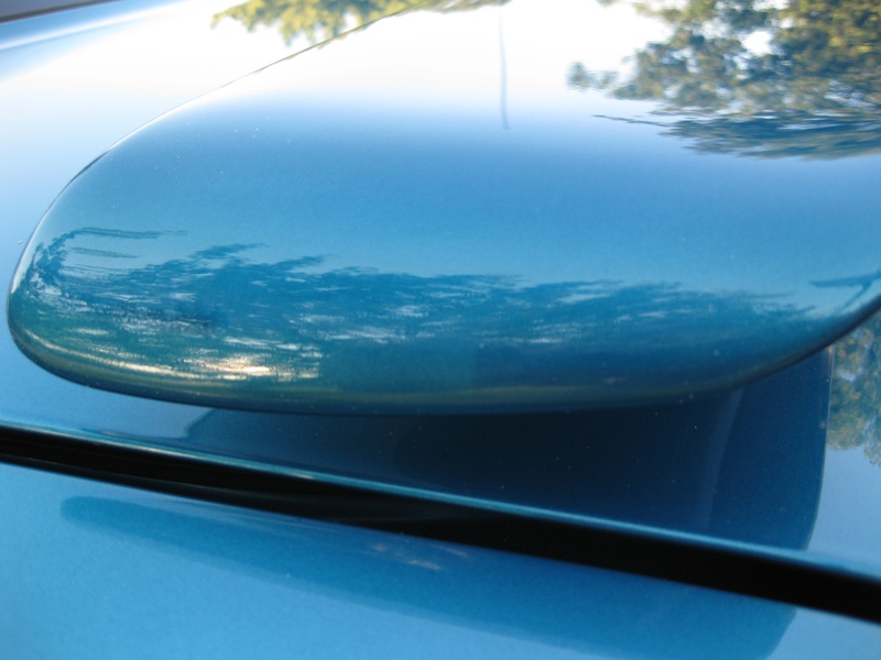

Wet sanded it this afternoon with 2000 grit then 2500 grit and finished with 3000 grit.

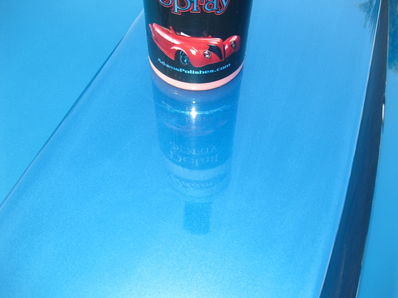

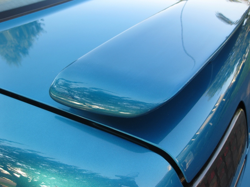

Here it is reinstalled and polished with Adam's Severe Swirl Remover on a green pad, followed by Swirl & Haze Remover on an orange pad and followed up with Fine Machine Polish on their white pad. I used the Flex XC 3401 VRG Polisher to do the work.
Yea, there's more orange peel in the spoiler than the rest of the paint, but it actually came out pretty nice for a rattle can.
