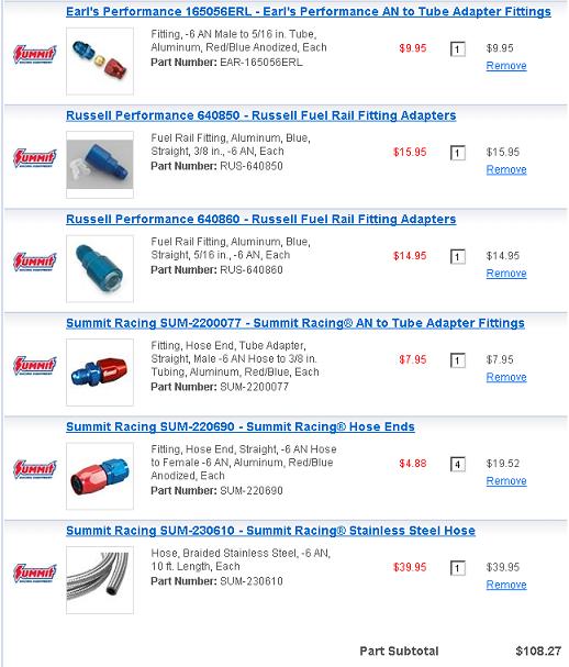

z34Phoenix Posted September 4, 2012 Report Posted September 4, 2012 ok going from a 3800 na to 3800 sc from 97... 1)pcm. you need to decide how you are going to run the swap. some people have a l36 program tuned to run boost or a l67 tuned for the 4t65e trans. -if you use l36 code you need to swap spark, fuel tables, and install a l67 MAP sensor and swap its connector on the harness -if you swap to l67 code you need to install a wire in the harness for the bbv solonoide and have to run a l67 MAP and swap its connector 2)fuel lines. some say you can rotate the l36 fuel lines and get them to work on the l67 fuel rail. but i heard this greatly increases the chance of fuel leaking and having the classic l67 fire. I am planing on buying AN fittings and building new lines. the pic below is a cart full of the pieces i will get from summit racing to do the lines. 3)engine mounts. going from an H body to W body will require different engine mounts. the lower mounts from your l36 will work fine, but the passenger side mount wont work. you will need a l67 w body mount. 4) oil pan. i don't know for sure if the H body pan will work. but if it doesn't just use the pan off of your l36. it should fit. 5) trans. I for one do not agree with needing to swap to the HD trans. i actually prefer the gear ratio on the non hd. and if you really want the hd diff then upgrade it later. you also don't hear about people toasting their diff on either of these trans. so i don't think it is a concern. the differences between the 97 l67 and 98+ are: 1)the vacuum line routing is different 2) the m90 has an additional vacuum tree near the BBV 3) i heard that the first m90's were hand matched to the rotor pack when built. Quote
White93z34 Posted September 4, 2012 Report Posted September 4, 2012 I've been using L36 lines on my swap for a few years, no problem. does not look pretty, but is functional. no leaks either. However I will be swapping on the proper lines on sooner then later, already have them just need to put them on. Quote
