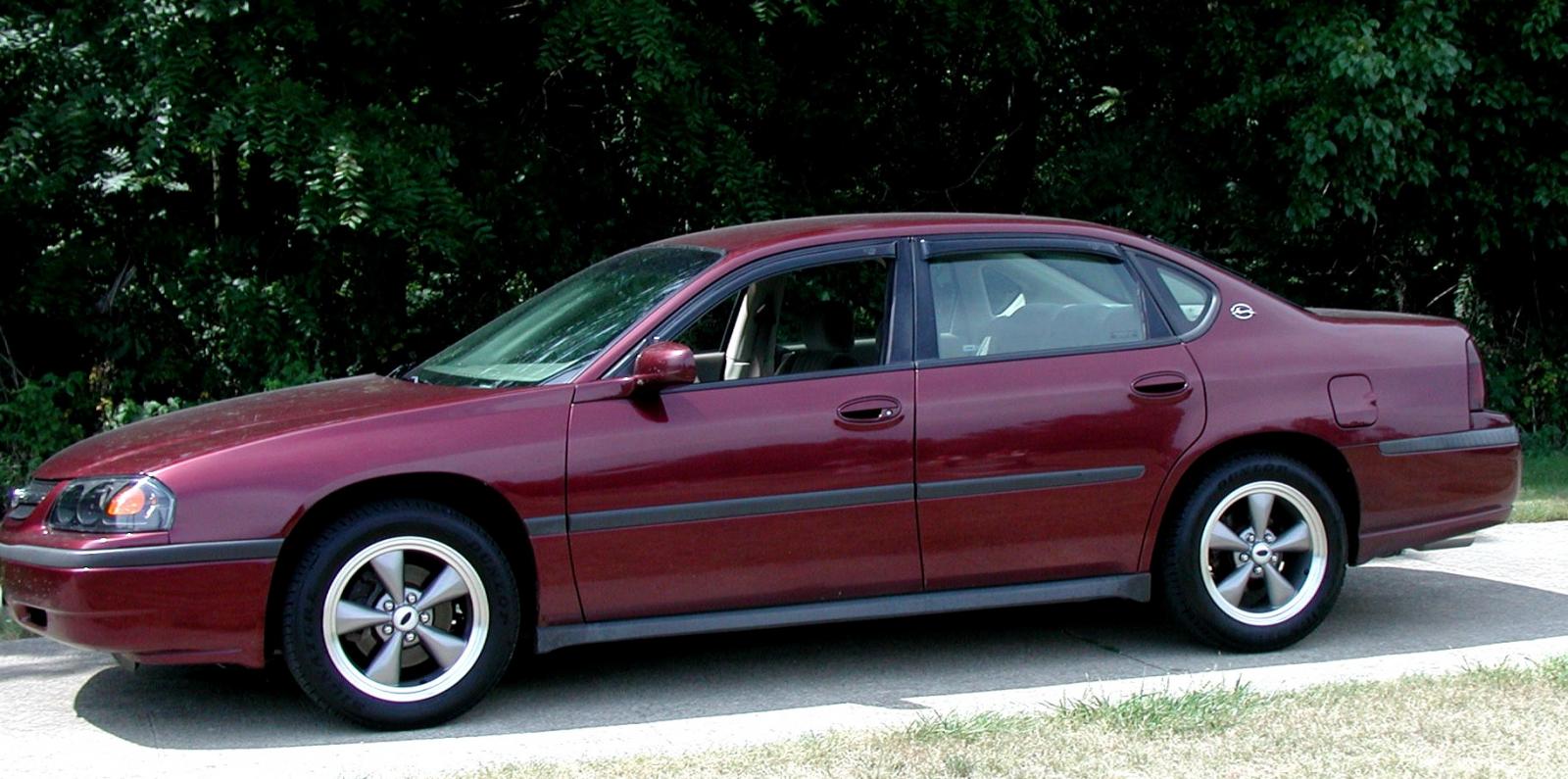

Hippie Posted August 20, 2012 Author Report Posted August 20, 2012 (edited) 1/2 away? Muscatine? that is pretty cool you are close. What do you have? definately need to meet. When will you have yours running? Are you just in collecting stage? South of Milan on US 67. MIne is my daily driver, 2001 Impala base model with factory 3800 L36. The original 3800 blew up a couple months ago right after a LIM gasket replacement thanks to a defective thermostat, brand new. It had apparently already had one (LIM gasket) before I got the car and some of the damage may have already been done. The T-stat was the coup de grace. I lucked out and found a cherry 47,000 mile replacement out of '02 LS that had been t-boned. It goes in next week for the trans work. My employment future is kind of shaky right now so I'm holding off on buying the ZZP stuff until Spring or I sell off some of my SBC inventory and my Studebaker. Edited August 20, 2012 by Hippie Quote
Euro Posted August 20, 2012 Report Posted August 20, 2012 Those Bullitts look great on there! I'd stick with the 3.29's. They're decent for highway, but not like the 2.93's are. I got a calculated 33mpg on my trip to Nebraska a couple years ago in my 2000 GT. Quote
Hippie Posted August 20, 2012 Author Report Posted August 20, 2012 (edited) Those Bullitts look great on there! Thanks. I'd stick with the 3.29's. They're decent for highway, but not like the 2.93's are. I got a calculated 33mpg on my trip to Nebraska a couple years ago in my 2000 GT. I know I said I'd love to get 28-29 MPG but to be honest mileage is not my primary concern, the car is a lazy pig with the 3.05's. To go to 3.29's requires a $$$ differential and gear swap, to go to 3.42's requires only a sprocket swap while the trans is out for other work. The difference in RPM at 70 MPH between 3.29's and 3.42's is 80 RPM or in other words at 67.3 MPH with the 3.42's I would be turning the same RPM as 3.29's at 70 MPH........... I honestly doubt I'm going to hurt my mileage, in fact I'm halfway thinking it may improve slightly. I've seen it happen a few times before, particularly on low torque engines like the 3800, the engine may be turning a few more RPM but it's not working as hard to maintain the same speed. Edited August 21, 2012 by Hippie Quote
