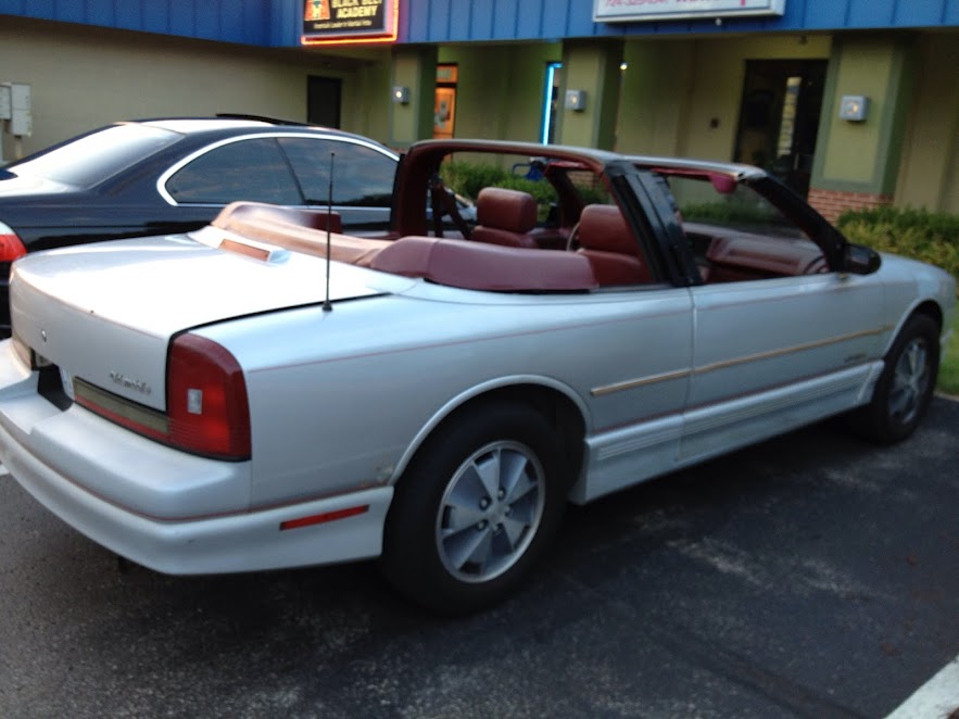

The interior pillar trim (left side of windshield) is loose. Are there clips still made to attach it back ? I have the trim piece and it is attached at the dashboard end. Just loose at the top where it meets the top trim. Thanks!
Edited by KarenL2888
You can get a clip from a Cutlass coupe or a sedan at the junkyard. I got a new clip off of a sedan, but the little plastic tabs on my convertible's A pillar that the clip had connected to had broken off. So I took some emblem adhesive and glued the clip where it should go and let it dry overnight before reinstalling it. It has been on for a couple months now without coming loose.
Did the same thing, used Gorilla Glue to hold the clips.
Same here. Glass shop broke both sides when the windshield was replaced. Fixed it with glue a year and a half ago or so- no problems.
