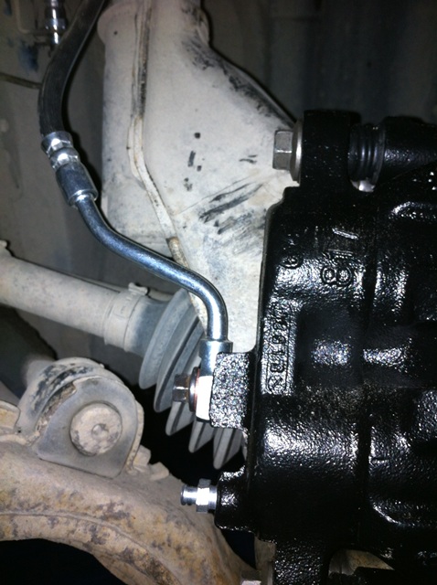

It was time to replace the front brakes (judging by the shudder). I decided to go all the way, and got new calipers, rotors, pads, and soft lines from Napa.
Everything seemed to go about as smoothly as I expect when working on the car, and the biggest PITA was when I had to grind a bit of metal from the bottom of the knuckle so that the bottom caliper bolt would line up with the bracket hole.
Cleaning the dirt and rust up took the most time to do, but when installing the new parts everything fit, didn't (appear to) leak and got torqued correctly. I bled each caliper until I saw clean solid fluid, and the damn pedal was squishy throughout and after the whole procedure. (By squishy I mean it went all the way down to the floor with slight resistance)
At this point I have no brake pressure, which I don't understand, since fluid was pushed from each caliper, so there is fluid getting to the calipers. I checked the fluid level before and after bleeding each caliper, so I know there was never a lack of brake fluid throughout the bleeding procedure.

You can have air in the MC, Delco ABS (you don't have one), the lines, the calipers. First thing to make sure is that the bleed screws are all near the top for any caliper or brake cylinder. If not, it's likely installed on the wrong side (if that's possible with your make/model).

Thanks Joe, you answered the question. Went back and looked the calipers over after reading your post. Guess what I found?
Obvious that the bleeder valve should be on top, now that you brought it to my attention.
Looks like you need to swap front calipers left to right
First Guess: Having to grind the knuckle was your warning that you were installing the calipers incorrectly.
True dat Schurkey, unfortunately I think what happened was that I was so worried about 1. making sure the important areas were clean of dirt and rust, and then 2. getting the project done quickly so I could study for a final the next day. Also I was stressing about not cracking the hard lines and getting the bolts all torqued correctly. Ended up missing the big picture, but at least the situation was simple to fix once the problem was pointed out, and I got a 85% on my final the next day (had to drive my uncle's cobalt ss though, it was rough).
Yeah the grinding thing, I guess I thought that the calipers had a slightly thicker casing than the ones they were replacing. Live and learn.

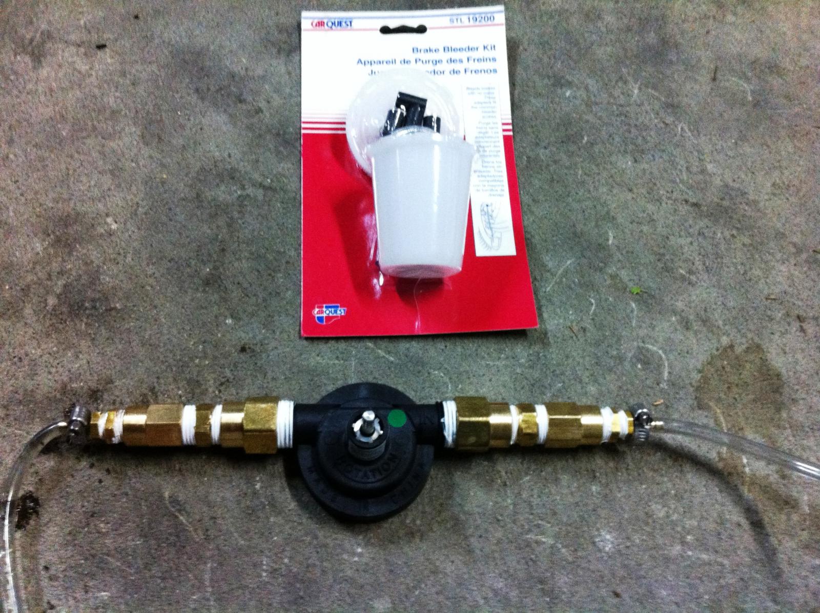

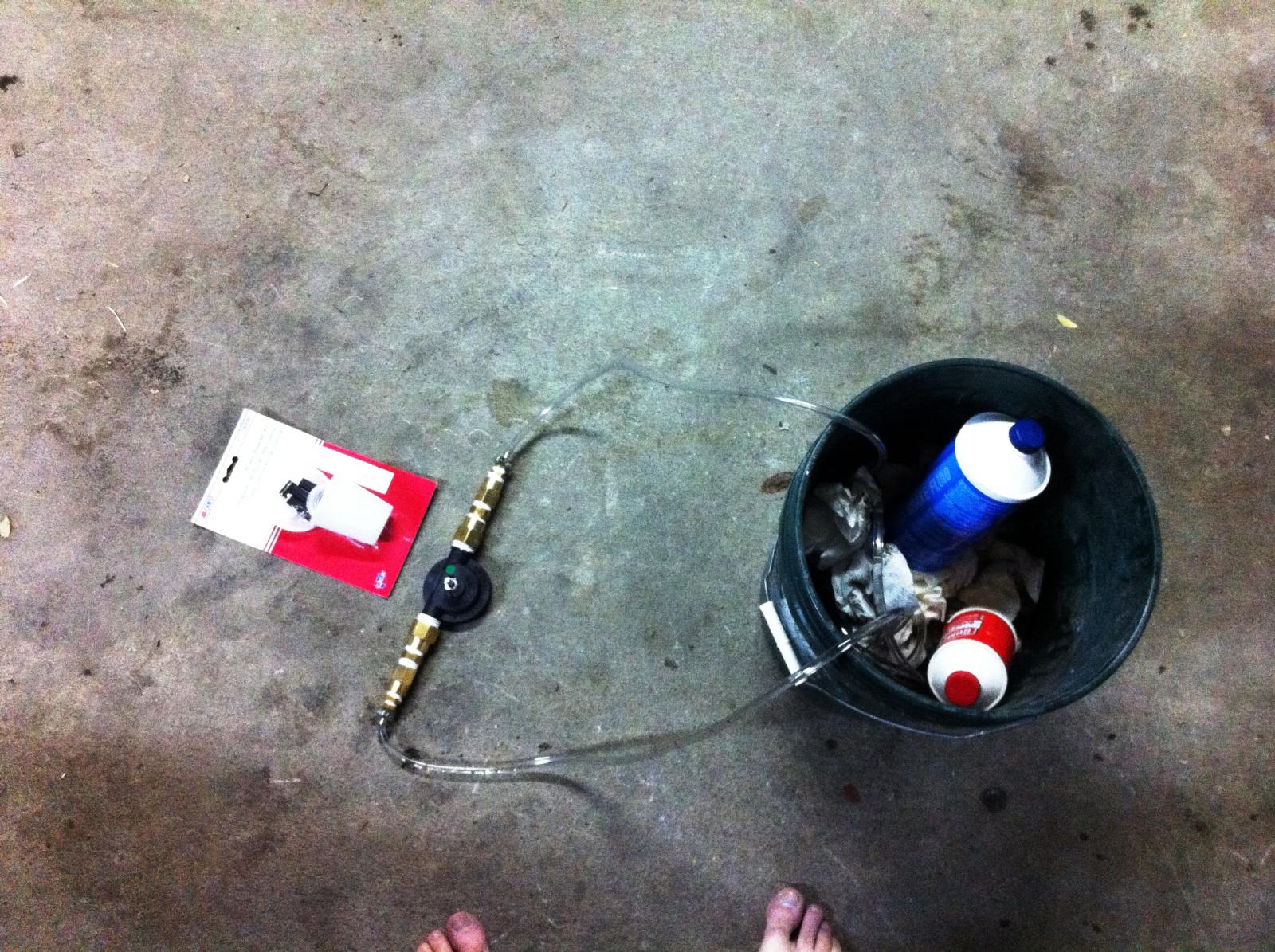

When planning the project, I priced a couple bleeder tools, but they were either too expensive or too cheap, so I went to Home Depot and bought a drill-actuated pump, about $20 worth of fittings that reduced the inlet and outlet from 3/4" to 1/8" o.d. Got a couple 10 ft. rolls of 1/8" tubing and a couple hose clamps. I figured I could achieve a "el cheapo's" version of what they do at the lube-shops - suck the air/fluid out of the bleeder, then let the outlet line pump the fluid back into the master cylinder after removing enough to ensure all new brake fluid in the system. Some old fluid would be left of course, unless you could do all four lines simultaneously, but in theory you could just let the pump run for a while, and eventually the suction would get all the air out of the line without draining the m.s.
I measured the length of the line on either side of the pump so that there wouldn't be a ton of excess fluid in the pump and line between the bleeder and the m.s., but allowed me to position the pump where I could reach it and keep an eye on the return (at the m.s.). Thing worked great when I tried it on the reversed caliper setup, pulled lots of old fluid out (which I dumped) until it all ran clear. Didn't use it after switching the calipers around, just stuck a piece of tubing over the bleeder and had my sister pumping the brakes while I opened and shut the valves.
