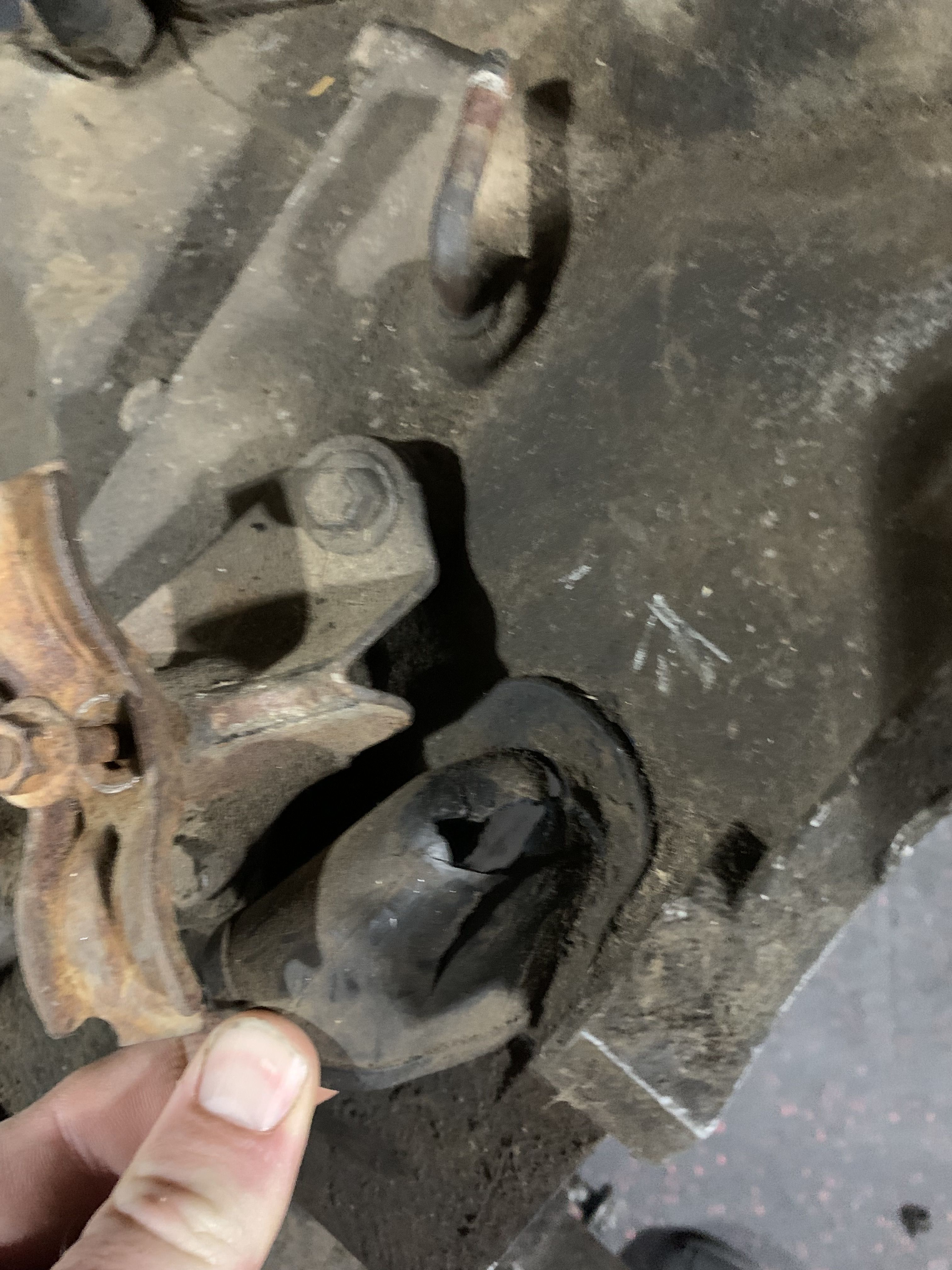

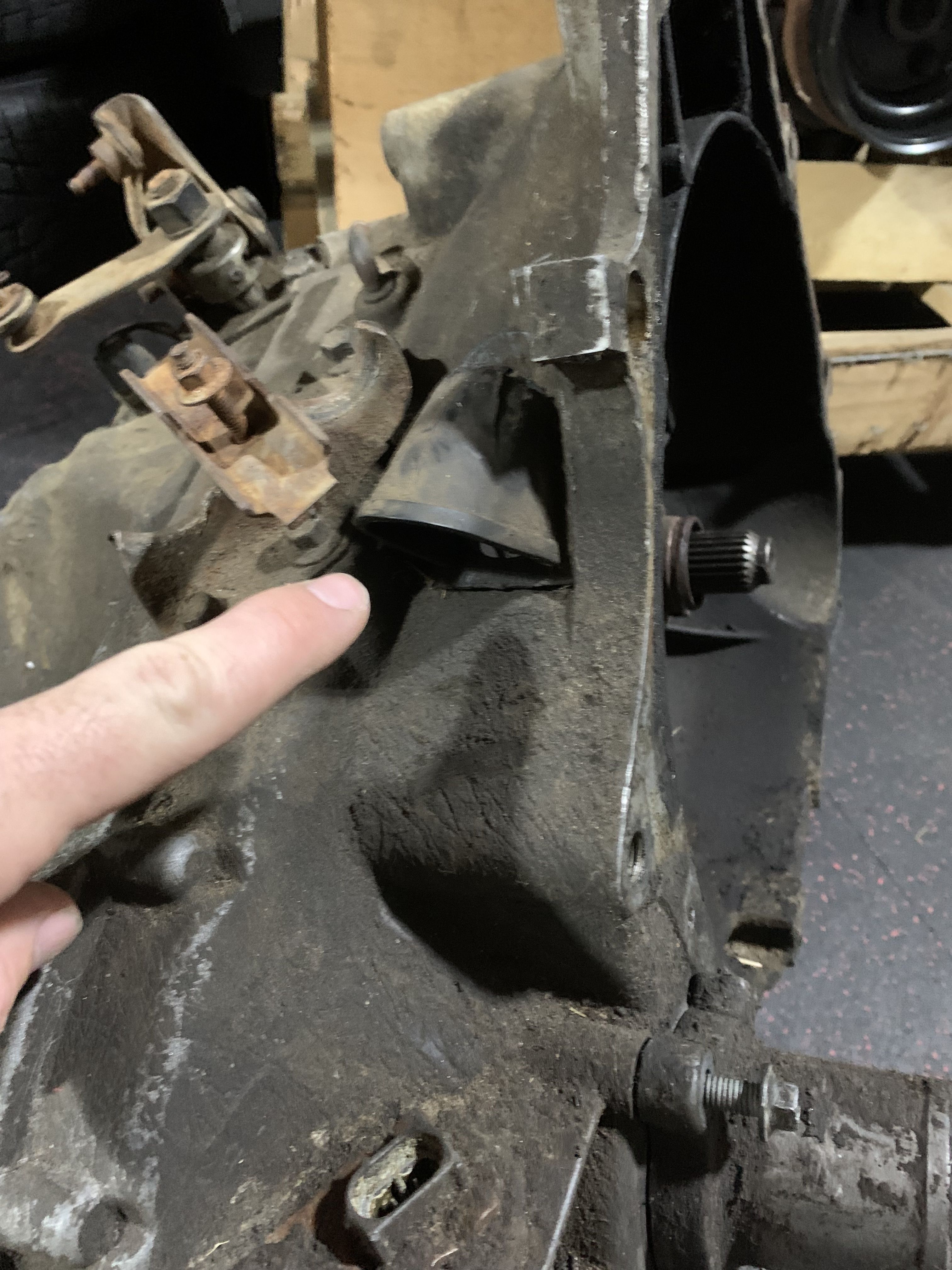

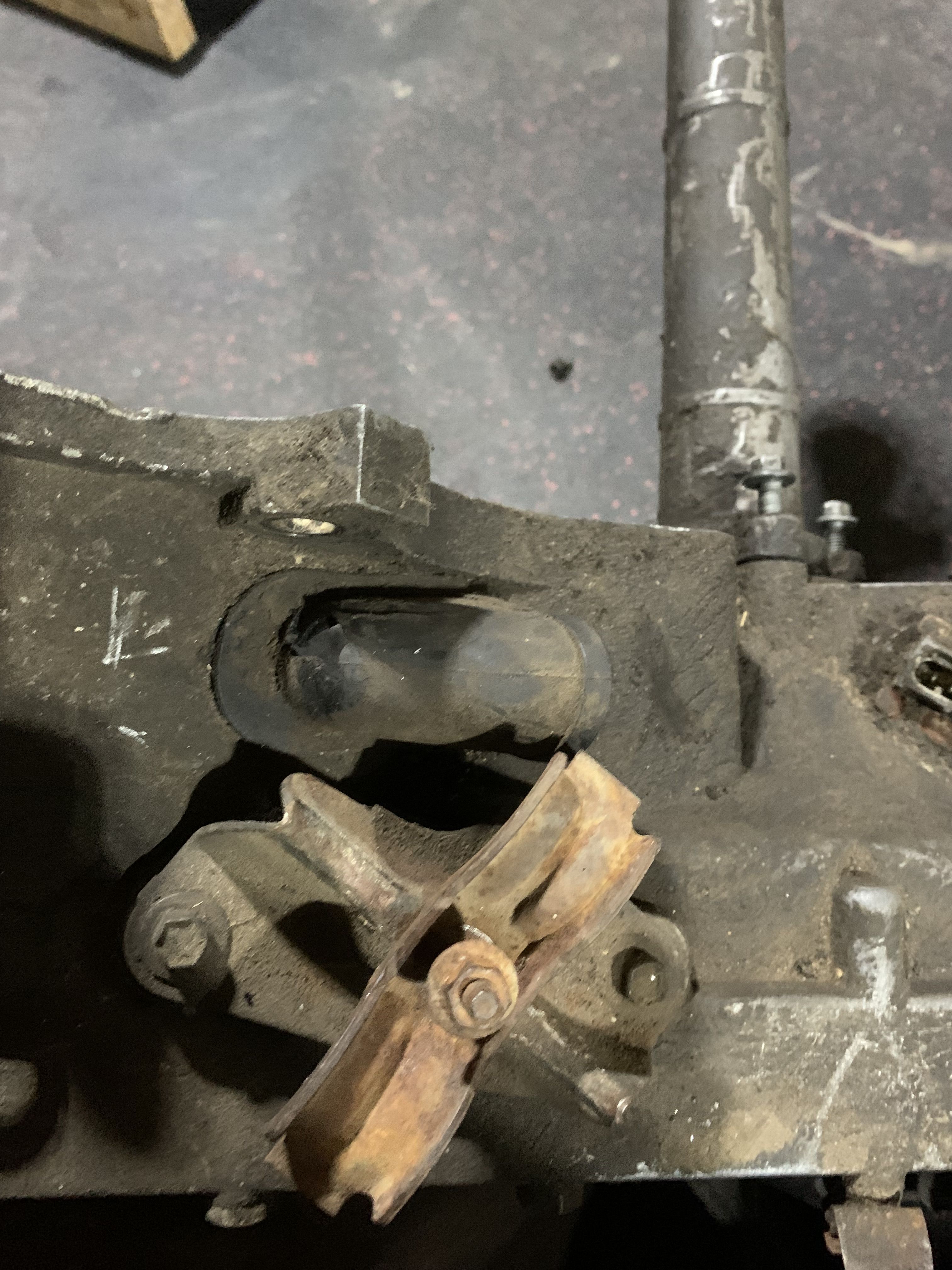

SuperBuick Posted September 22, 2024 Report Posted September 22, 2024 On 7/4/2023 at 3:38 PM, GTP091 said: Finally sourced a set of new hydraulic lifters for the engine rebuild. Engine tech and a Timing chain set. Bringing this topic back to the top. So much useful searchable info here, so much better than facebook @GTP091 how is your swap going? @White93z34 @55trucker do you guys know if the getrag 282 transmission mount (part Pioneer 622620 ) will work on the 284? On my car which is a factory 284 car, there is also this circle black plastic thing on the bottom that looks like a mini hockey puck… thats all cracked up and needs repair/replacement. The transmission case has a rubber vent looking thing on top (almost like a shark fin but which air flows through) - does a 282 have that also? Mine is all ruined - not sure what it does or if its needed. I will post pics when I get back home. I have many more questions on the “manual swap” because in order to convert my Satanic / Powermaster brake system to normal brakes, I basically have to undergo the same work with regards to the firewall plate - and that seems to be the hardest and least documented part of the job. I will have one powermaster brakes/manual firewall plate, and another vaccum brakes/automatic firewall plate to work with. Quote

SuperBuick Posted October 7, 2024 Report Posted October 7, 2024 On 9/25/2024 at 12:19 AM, SuperBuick said: Awesome - I will post in the am! This is the “shark fin” piece… Quote
55trucker Posted October 7, 2024 Report Posted October 7, 2024 That rubber shield covers the air inlet port for the clutch housing. SuperBuick 1 Quote

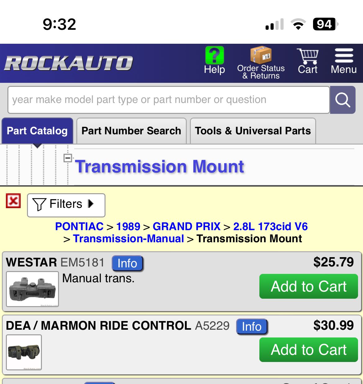

SuperBuick Posted October 9, 2024 Report Posted October 9, 2024 On 9/24/2024 at 11:39 PM, Bake82 said: A 282 mount will work with a 284. It’s slightly different but has been done in the past. post a pic of the 284 rubber piece. I’ll have a look at my 282 for comparison. So I bought the 282 mount and I can see absolutely no way to make it work on the 284. The 284 mount has bolts that go through it and mount into the side of the transmission, with studs down and into the cradle. The 282 mount has studs up into the bottom of the transmission, and studs down into the cradle... Quote
Bake82 Posted October 10, 2024 Report Posted October 10, 2024 15 hours ago, SuperBuick said: So I bought the 282 mount and I can see absolutely no way to make it work on the 284. The 284 mount has bolts that go through it and mount into the side of the transmission, with studs down and into the cradle. The 282 mount has studs up into the bottom of the transmission, and studs down into the cradle... Sounds like you got an auto mount instead of a manual trans mount. Viewing rockauto the olds cutlass manual mount shows an auto mount under the manual trans option. I found the right ones under a 89 Grand Prix. Screenshot below. SuperBuick 1 Quote
