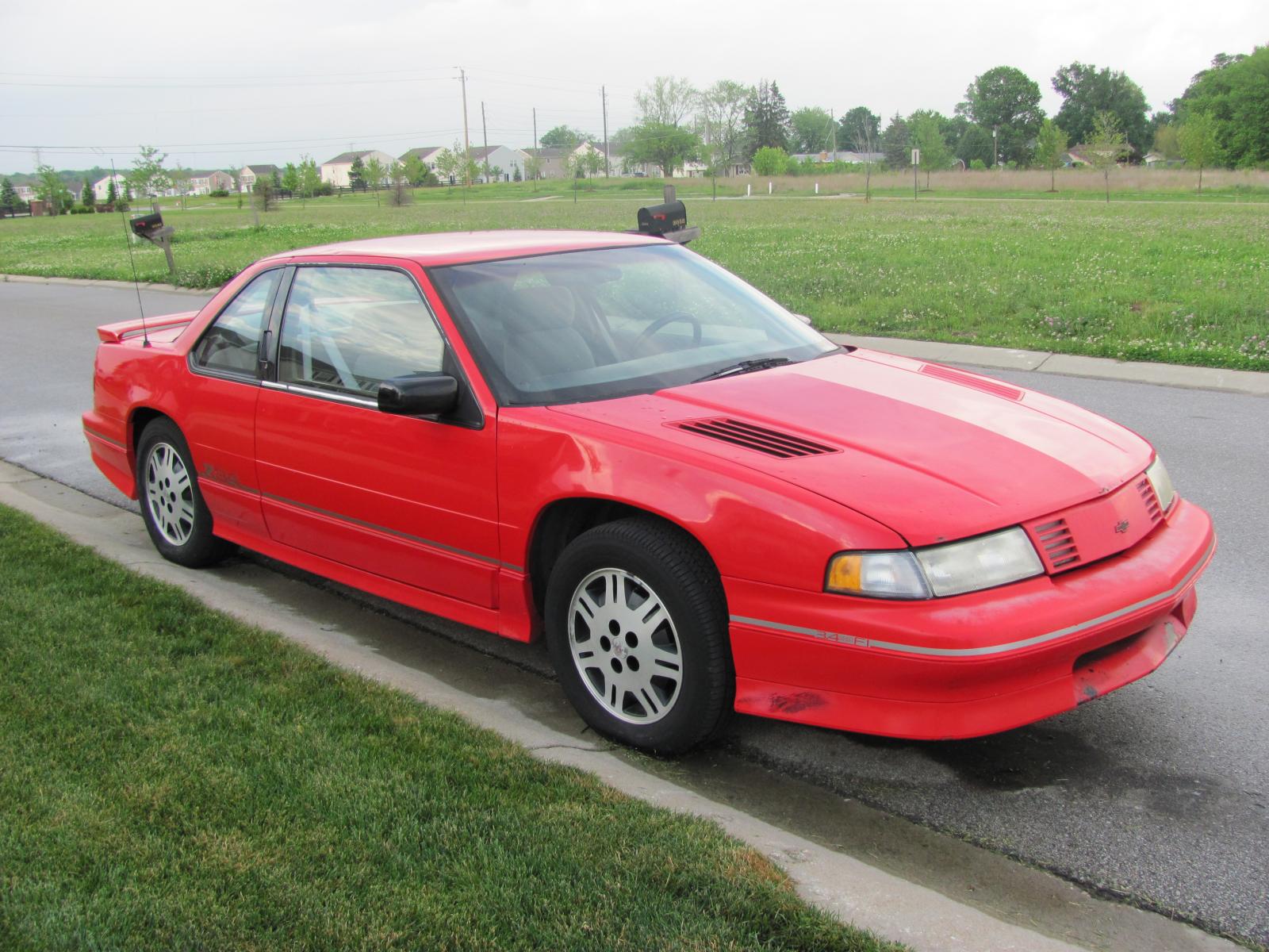

seanwil12 Posted July 28, 2012 Report Posted July 28, 2012 I have a 93 Lumina Z34 as a new Project Car. She isn't running so well and so I have turned to this forum for maybe some questions as to why. I let her sit for about 2 weeks and now she's not even starting. Just turning over. I'm going to take this time to check the Injectors and Intake Manifold to make sure it's all in proper working condition. I am also interested to see what else is going on with the luminas and w-bodies. Names Sean. I'm 21. In college and have a full time job. Only time I ever have is when I have my weekends completely off. I would really like to get my Z34 going. It would mean so much to me as I absolutely love the car and it rides so nicely. I love cars, I'm a GM and a Mopar guy. I'm kind of a big geek as well so if you have any computer questions feel free to ask those! Well it's pretty early so I may as well just call it a day and see if I can't get more sleep. Tell me whatcha think! Sean **Don't mind the mess** LOL Quote

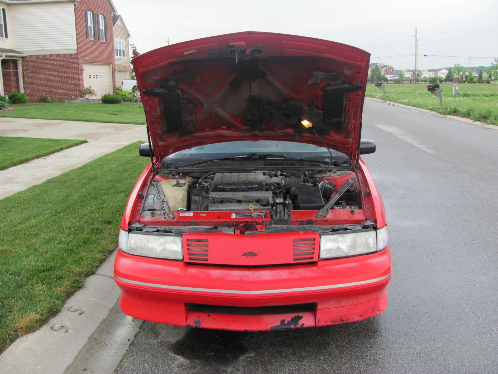

94 olds vert Posted July 28, 2012 Report Posted July 28, 2012 Welcome to the forum. Lot's of good info on this site for these cars. Your Z34 looks pretty good. Don't see any major rot on the body panels. Quote

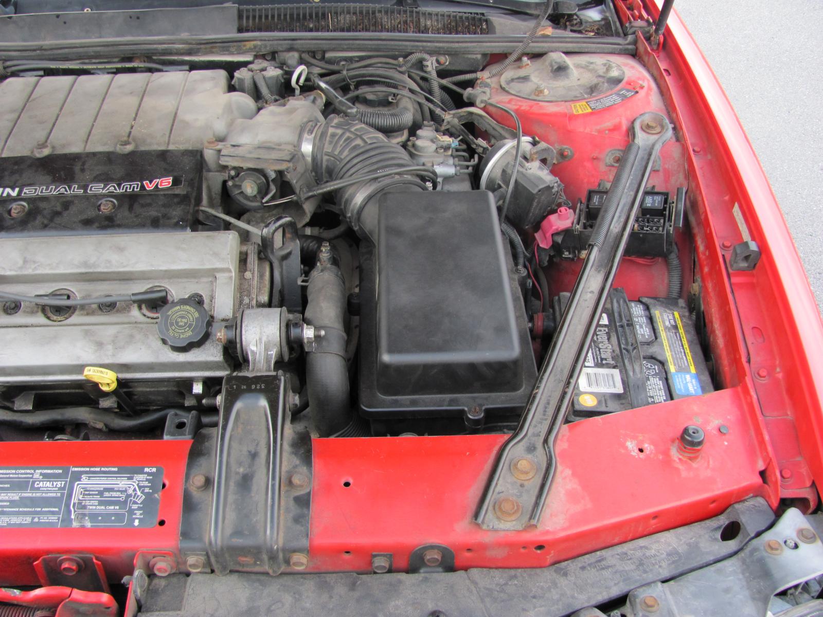

seanwil12 Posted July 28, 2012 Author Report Posted July 28, 2012 Well here are the things ive done and tested: Replaced all the spark plugs coil packs and wires. Everything is sparking like it should. Checked fuel pressure all is good there, fuel pressure is at a steady 45 PSI. My next project is removing the intake manifold and replacing the gaskets and cleaning the inside of the manifolds with Carb & Choke cleaner to remove any carbon build up and replacing all the fuel injectors. I do believe the fuel injectors are to blame. If sitting for 2 weeks it will refuse to start for awhile and gradually come back to life and while idling the front 3 cylinders to not fire accordingly but under throttle they fire just fine. Which leads me to believe I have bad injectors. One can hope! Quote

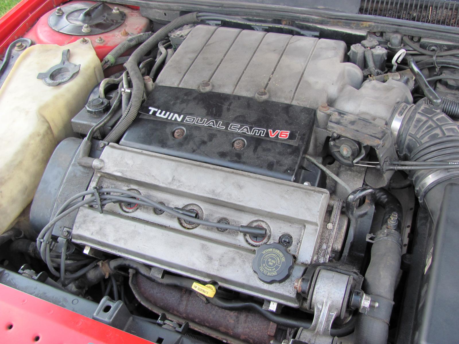

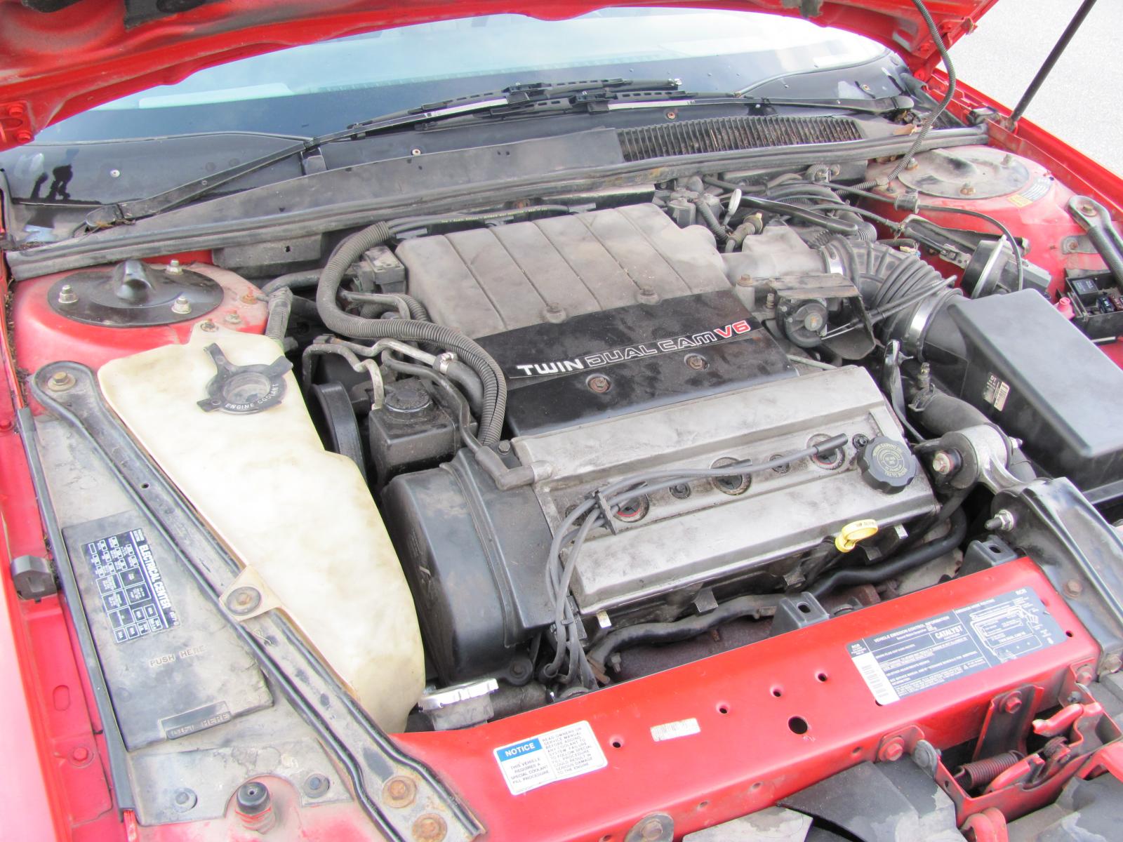

seanwil12 Posted July 28, 2012 Author Report Posted July 28, 2012 I guess I should upload a Pic of the engine eh? Quote
AL Posted July 28, 2012 Report Posted July 28, 2012 If you pull your intake, grab a multi meter and ohm out the injectors Quote
