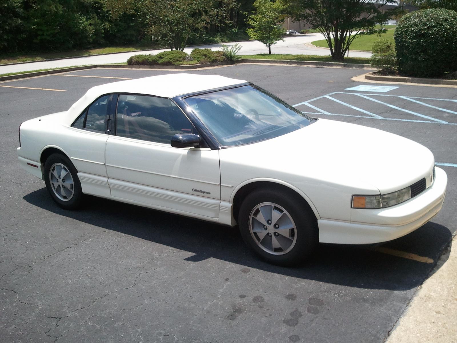

rawdeal91vert Posted July 23, 2012 Report Posted July 23, 2012 Morning All, My 91' suposedly has the "Corvette Suspension".... at least that is what the original owner told me. Reguardless the car handles better than anything I have owned include my Volvo 960. Original owner said he bought it with an upgraded suspension a $2800 option in 91'. The car is a one owner with 72,000 miles. How can I find out from the vin # or looking underneath to find out what I have. Or did all convertbles ship with the same set up? Thanks Quote

94 olds vert Posted July 23, 2012 Report Posted July 23, 2012 Compnine.com Put your vin into that website and it will give you a breakdown of your rpo codes. My guess is that you have the FE3 suspension on your car. Quote
rawdeal91vert Posted July 23, 2012 Author Report Posted July 23, 2012 What is an FE3 suspension? Quote
94 olds vert Posted July 23, 2012 Report Posted July 23, 2012 FE3 suspension is the sportier version of suspension for our cars, I believe you get higher rate(stiffer) front springs, stiffer monoleaf spring, 34mm anti-sway bar up front and -sway bar in the rear. BTW I love your car. Quote
