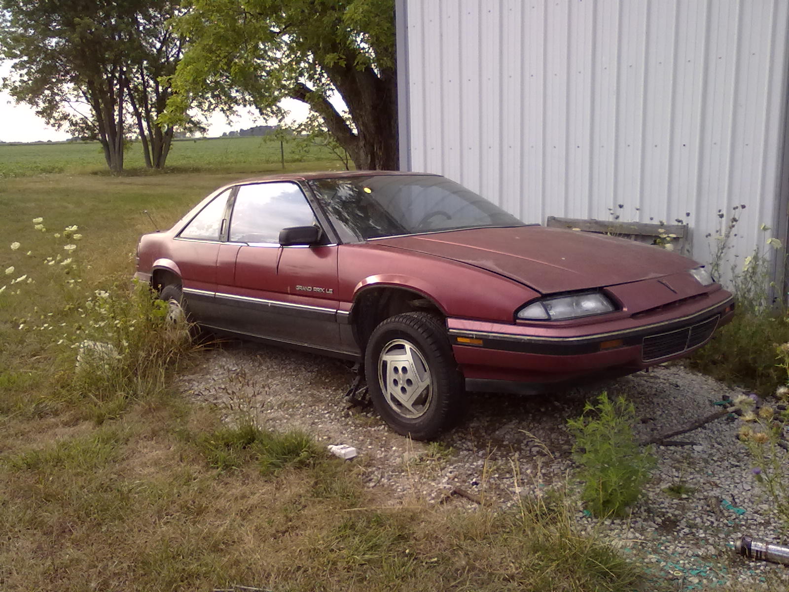

mreverest72 Posted July 23, 2012 Report Posted July 23, 2012 Thinking of buying this car for my daughter to get by on but the guy tells me he has replaced the oil pump and the oil pressure sensor and it still loses oil pressure after it runs for ten minutes or so, then it dies. Anybody got any ideas? Is this worth me paying $200 for? I am a pretty fair mechanic but I have not run into this issue as I am not a gm guy normally. By the way it does have a rebuild title because the front end was wrecked. Quote

RobertISaar Posted July 23, 2012 Report Posted July 23, 2012 for $200, you could make a profit scrapping it, let alone parting it out or just fixing/driving it. it shouldn't stall due to lack of oil pressure unless the only way the fuel pump is being powered is via the oil pressure switch, which means the fuel pump relay is bad at the very least. Quote

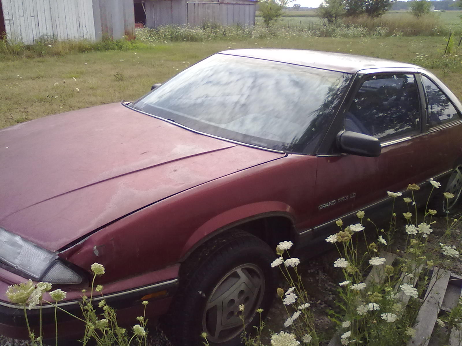

Hippie Posted July 23, 2012 Report Posted July 23, 2012 (edited) If it's not rotted out underneath it's worth $200 even if it didn't run and good used 3.1's are CHEAP, CHEAP, CHEAP so I wouldn't even bother with the 2.8. Looks like it needs some serious TLC though, that hood's makin' me sea sick but hoods are easy to replace. Had a gray '88 Coupe like it, nice car but hated the digital dash, I'm a product of the Musclecar era, I gotta have needles to watch. it shouldn't stall due to lack of oil pressure unless the only way the fuel pump is being powered is via the oil pressure switch, which means the fuel pump relay is bad at the very least. Good point, I believe the fuel pump is wired through the pressure switch so that would make sense. Edited July 23, 2012 by Hippie Quote
mreverest72 Posted July 23, 2012 Author Report Posted July 23, 2012 If it's not rotted out underneath it's worth $200 even if it didn't run and good used 3.1's are CHEAP, CHEAP, CHEAP so I wouldn't even bother with the 2.8. Looks like it needs some serious TLC though, that hood's makin' me sea sick but hoods are easy to replace. Had a gray '88 Coupe like it, nice car but hated the digital dash, I'm a product of the Musclecar era, I gotta have needles to watch. Good point, I believe the fuel pump is wired through the pressure switch so that would make sense. Do you think I could just bypass the oil pressure switch so it doesn't do that any more? I forgot to look at the mile but the interior is in pretty good shape. I don't want to do an engine swap if I can help it. Quote
Hippie Posted July 23, 2012 Report Posted July 23, 2012 If it has a new sending unit and it's still showing a pressure drop it probably actually is losing oil pressure when it warms up. You could probably keep it running longer than the 10 minutes by bypassing the switch but I wouldn't want to bet for how long. See if the seller will let you hook up a mechanical gauge in tandem with the factory gauge, that will tell the tale. Quote
