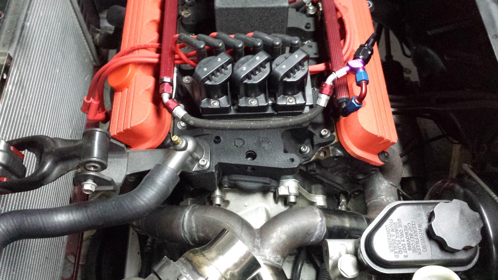

Miko K Posted May 31, 2014 Report Posted May 31, 2014 This is what I'm talking about- exit dead center between the front and rear heads, then use a U-bend to go back towards the firewall and back into the stock exhaust. Only the crossover pipe needs to be reworked, which is easy and cheap, any decent exhaust shop can do it if you bring them the mandrel bends. Notice the magic marker line near the merge- this is how close it was to the center of the engine. Later I moved some pipes and got it to be exactly in the center. I will post a video soon, need to weld 1 more resonator in place. Quote
