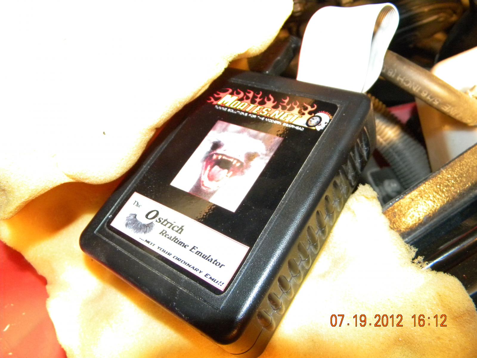

redgrandprix Posted July 13, 2012 Author Report Posted July 13, 2012 well the screen hookup goes up into the center console dash area maybe something to do with info center that is no longer there? the usb goes into the firewall torwards the engine bay with a big blob of hot glue or something. Quote
Turbo v-sick Posted July 13, 2012 Report Posted July 13, 2012 well the screen hookup goes up into the center console dash area maybe something to do with info center that is no longer there? the usb goes into the firewall torwards the engine bay with a big blob of hot glue or something. The previous owner probably used an emulator for tuning purposes. http://www.moates.net/ostrich-2-0-the-new-breed.html Quote
redgrandprix Posted July 14, 2012 Author Report Posted July 14, 2012 where would the emulator be located if there is one? Quote
Turbo v-sick Posted July 15, 2012 Report Posted July 15, 2012 where would the emulator be located if there is one? Try looking by the pcm for the other end of the usb cable. More than likely the emulator has been removed and the tune has been burned onto the chip. Quote
redgrandprix Posted July 20, 2012 Author Report Posted July 20, 2012 i found it its an ostrich maybe an orginal but its under the black shroud in my engine bay on the passenger side ill post pics later Quote
Penglii Posted July 20, 2012 Report Posted July 20, 2012 awful nice of them to leave it there for you! Quote
redgrandprix Posted July 20, 2012 Author Report Posted July 20, 2012 yea i'm pretty happy, i just need to figure out what software i need and where to get it and how to use it. Quote
RobertISaar Posted July 20, 2012 Report Posted July 20, 2012 you can get all of it from moates.net. guess you got an almost $200 gift. Quote
redgrandprix Posted July 20, 2012 Author Report Posted July 20, 2012 i guess, they have it wrapped in like a foam padding and stuffed behind a small overflow tank. kind of a weird spot. Quote
