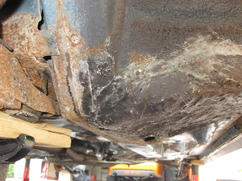

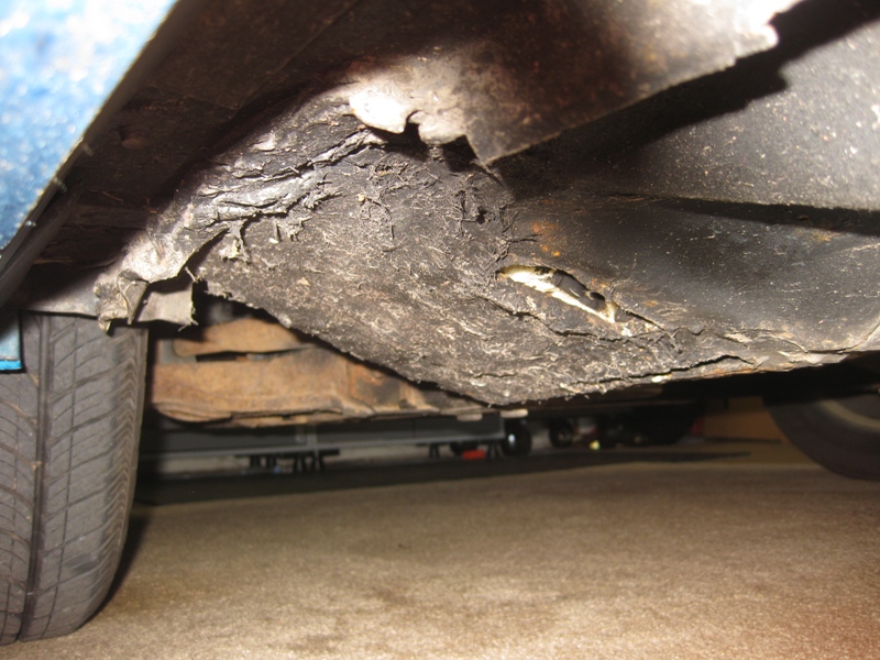

This came out from underneath:

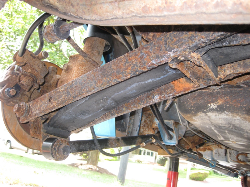

I hosed out the underside at least three other times trying to remove all the dirt, once with the wheels off and placed her up on jack stands. Seems the last owner must have lived on a dirt road. They had it for 14 years! Dirt, gravel and rust was coming out from everywhere.

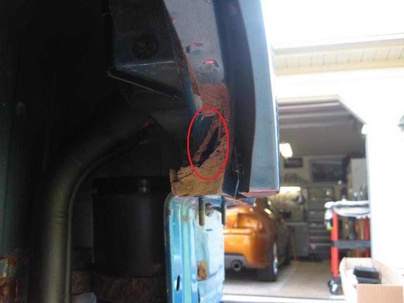

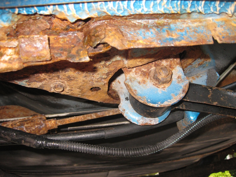

I also found this repair I somehow missed when looking the car over.
Its located right behind the drivers side front wheel. It held up fine all winter and still appears pretty good and solid.

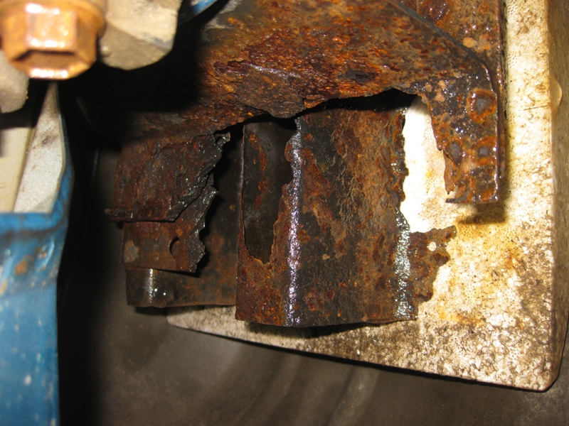

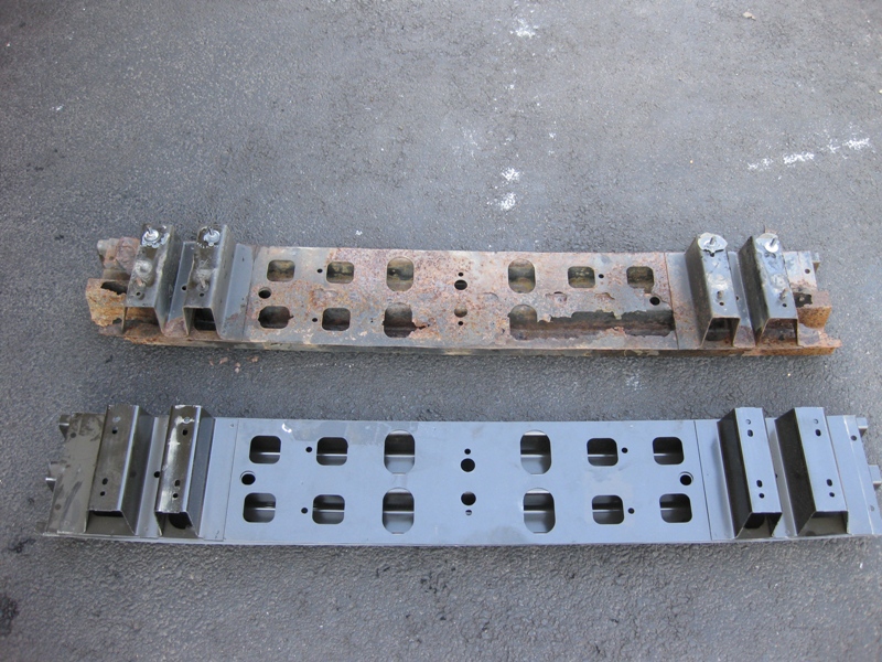

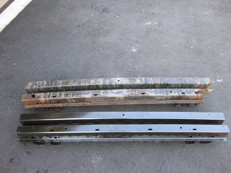

Then I discovered the rear impact bar was rotted away to just about nothing:
My local Buick/GMC dealer was able to find me a brand new one for $185, I bought it and the wheels started spinning in my head!

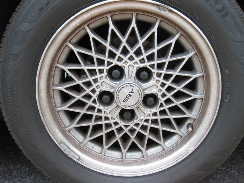

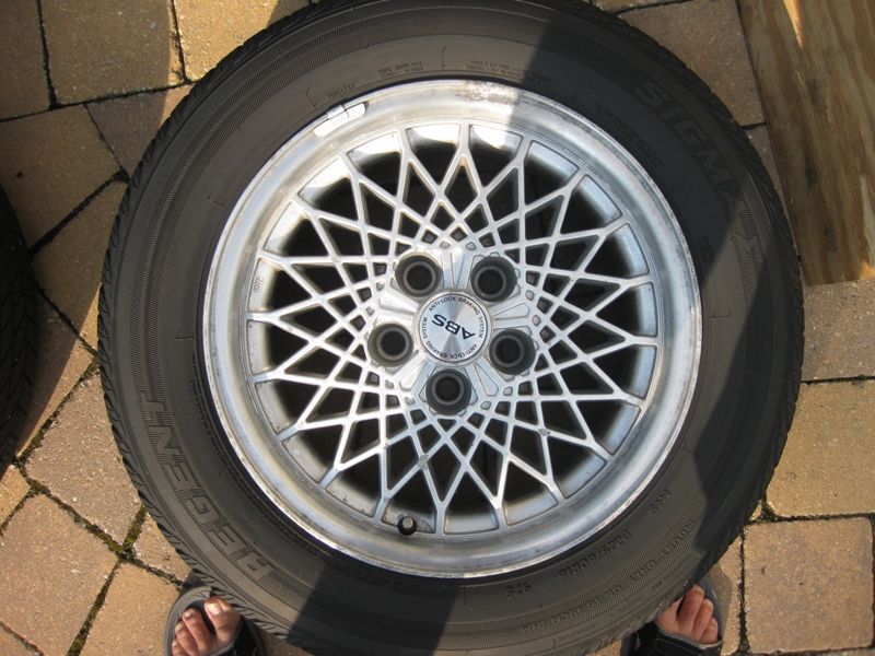

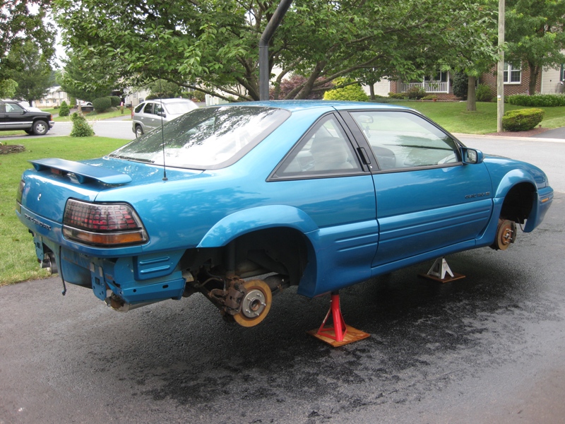

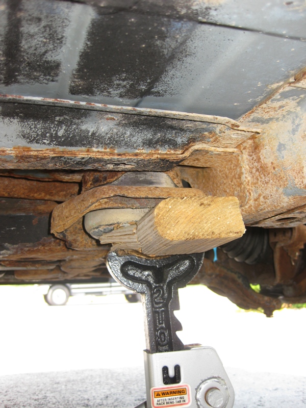

My daughter was out of school and our family vacation was complete. Arrangements were made for she and my wife to share my wifes car. Friday June 29th I started. I put the car up on jack stands and removed the wheels. While the wheels were off I did my best to clean them all: front and rear of all four wheels.
Before:
After:
They're going to need more work but they're much better. I used Adam's Wheel Woolies to clean them, the small and medium sizes fit pretty nicely within the Crosslace. Before another set of tires go on these wheels I'll probably sand/polish the lips and use sticky weights instead of the nasty hammer on type. I also took the right rear out to have a slow leak around the bead repaired. I polished out the area where an old hammered on weight was on the repaired wheel/tire and it came out pretty nice.

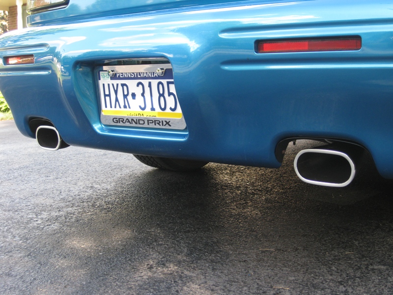

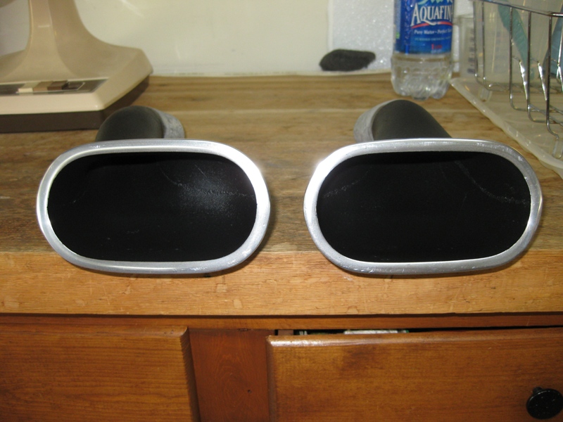

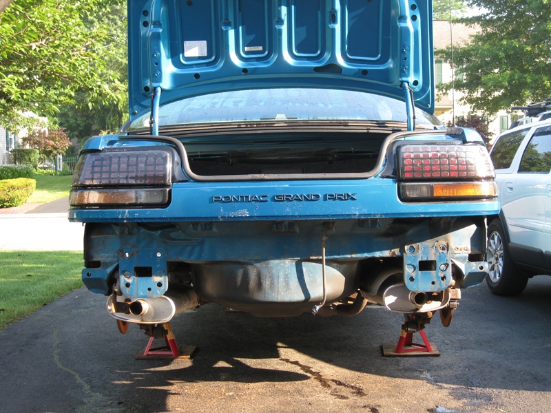

Next, in order to remove the rear bumper to get to the Impact bar it appeared easiest if I removed the exhaust tips. So while at it I took care of them. Sanded the lips with 400 grit progressively down to 2000 grit paper and polished them with two different polishes, again my choice was an Adam's product: Metal Polish 1 & 2. Taped off the polished lips and sprayed the insides and outsides with High Temp Black Satin Stove paint.
Off came the bumper cover and Impact bar
Old vs. New

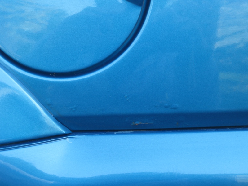

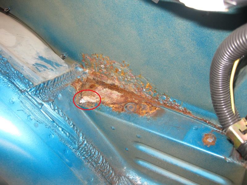

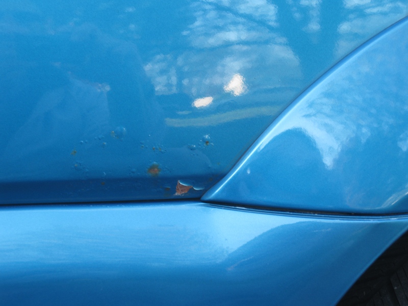

The two rust spots in the rear quarters
Right side:
Left Side:

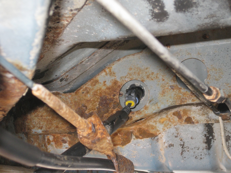

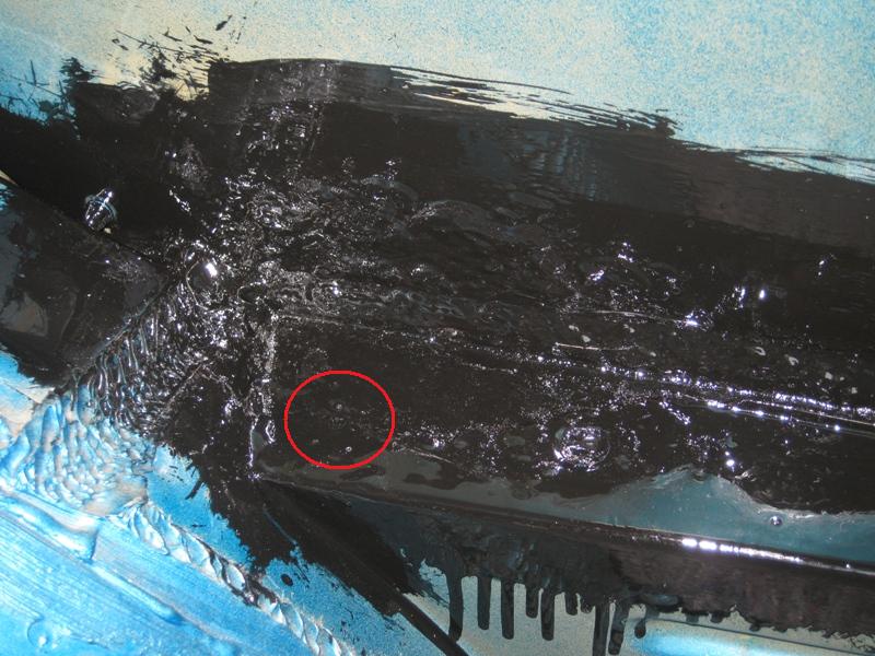

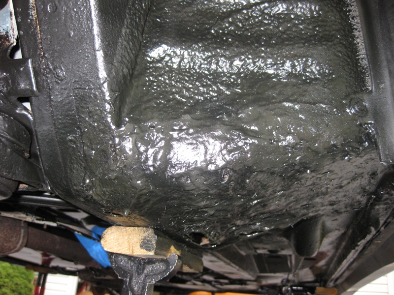

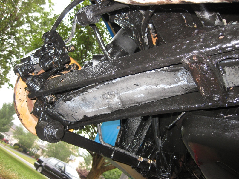

There was one other hole I found in the underside of the drivers side rocker panel back near the rear wheel well I took care of. I'll jump ahead here for a moment, the POR-15 is a rust encapsulator, it works best when applied directly on rust. The repair spots were cleaned and etched then had two coats of POR-15 applied. I then filled the voids in the left quarter pane and rocker panel with foam insulation, and top coated the foam once dry with another two coats of POR. Lastly I leveled all three with JB Weld and another two coats of POR.
Saturday I again cleaned the entire underside of the car. This time with the POR-15 Marine Clean, alkiline cleaner and brushes to scrub. This stuff is strong, I mixed it 5 parts water to 1 part cleaner.
This came from the back 1/3 of the car
Sunday I used the acidic POR-15 Prep & Ready to etch the metal in preparation for the paint. The instructions said something about protective clothing, it was hellish hot out so I'd just spray myself with the hose when my skin would start to itch too badly, LOL!
I did wear an old pair of glasses and a pair of shorts that were to go in the trash when the job was done as well as latex gloves.

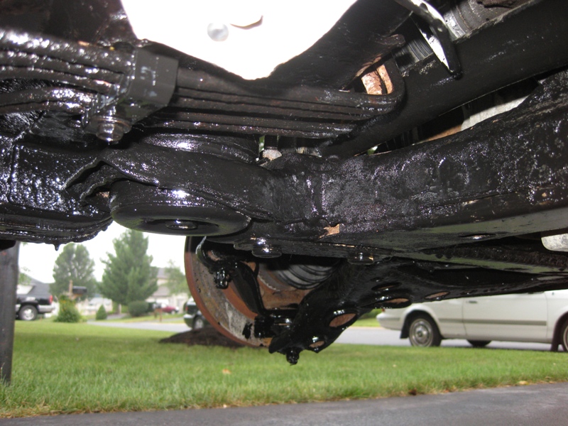

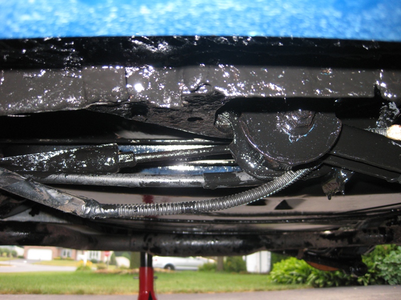

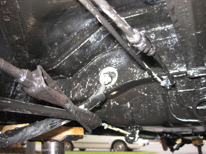

I used brushes to apply the POR-15 not a sprayer. Monday, and Thursday evenings I painted. All day Wednesday the fourth both Michelle (my daughter) and I painted. Friday I took the afternoon off work and a buddy came over to help me for about 3 1/2 hours. Saturday morning I finished up the painting. There will probably be some future mechanical issues, like needing new bleeder nipples next time the brakes need bleed. The drivers side of the car was by far the worst. I've got to figure that not only was the car never garaged, but that it had to have sat on a dirt or gravel driveway.
Check out these before and afters:

Repaired spot behind the left front wheel

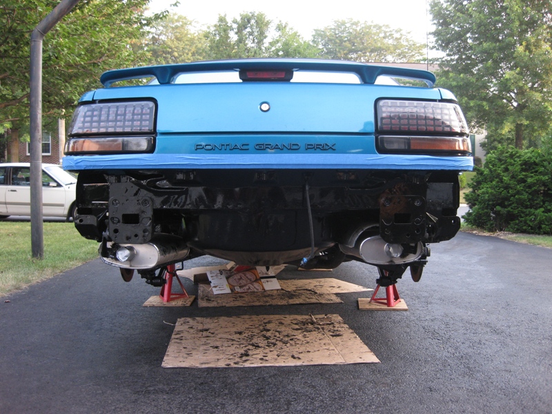

Sunday I got the car all back together and on the road!

It's actually supposed to stop rust. With traditional type paints you have to sand down to good solid bare metal and prime before you paint, then the paint you apply over top of the primer over time will pull in moisture, bubble up and eventually flake back off to start the rusting process all over again. This stuff is supposed to dry best at 80% humidity and cure over time as it gets wet. Once good and cured you can hit the stuff with a hammer and it wont chip or flake off. The paint stuck best to rusted metal and paint underneath that had no clear coat on it.
I'm in a GTO club and several of the guys that have restored old classic Goats have used this stuff with great success on old rusted frames and other parts so I figured I'd give it a try on the GP. Prep work was still pretty time consuming to throughly clean and etch the metal: it took two full days, but there was no need to sand to bare metal, just wire brush and scrape any flaking paint or rust. I bought one gallon of each but could have gotten away with two quarts of the Marine Clean since you cut it 5:1. The Prep & Ready and POR-15 Rust Encapsulator both required almost the full gallons of each.

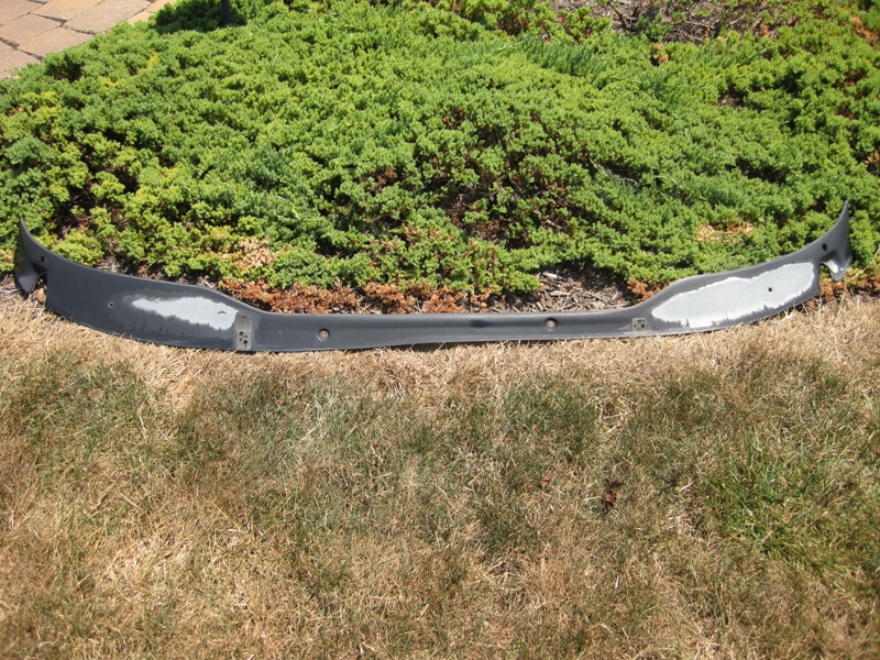

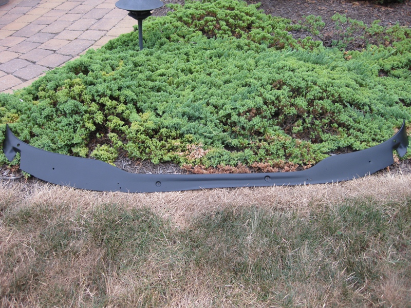

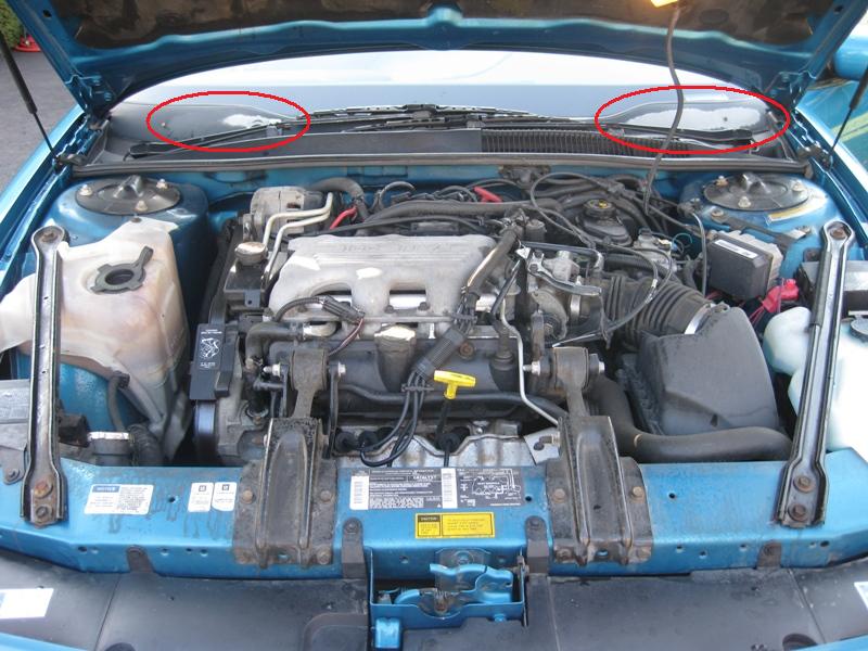

Pulled the cowl off Thursday evening:
All Cleaned and prepped:
Wire brushed all the rust and sanded to scuff with 400 grit paper.
Two coats of Adhesion Promoter and three nice wet coats of Black Trim paint:
I'm working on the adhesive right now to reattach the plastic trim strip along the upper edge. Hope to have it back together early this afternoon.
