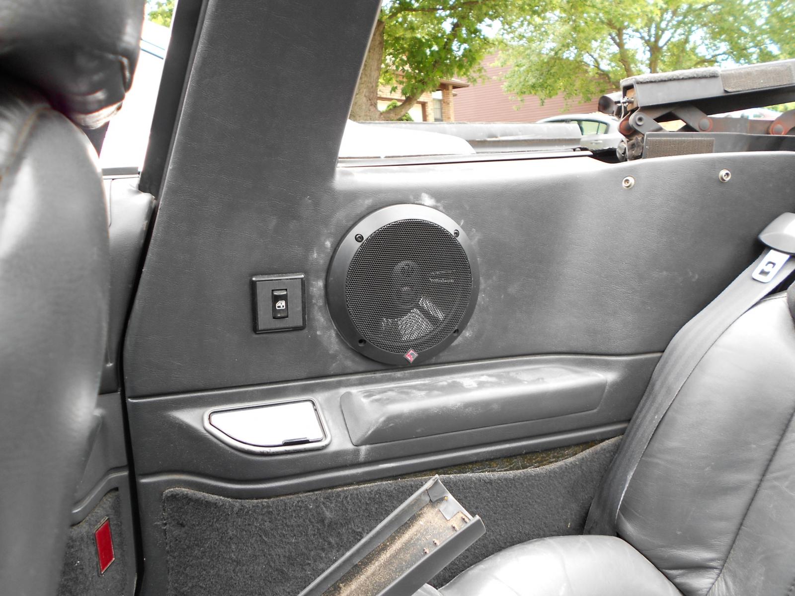

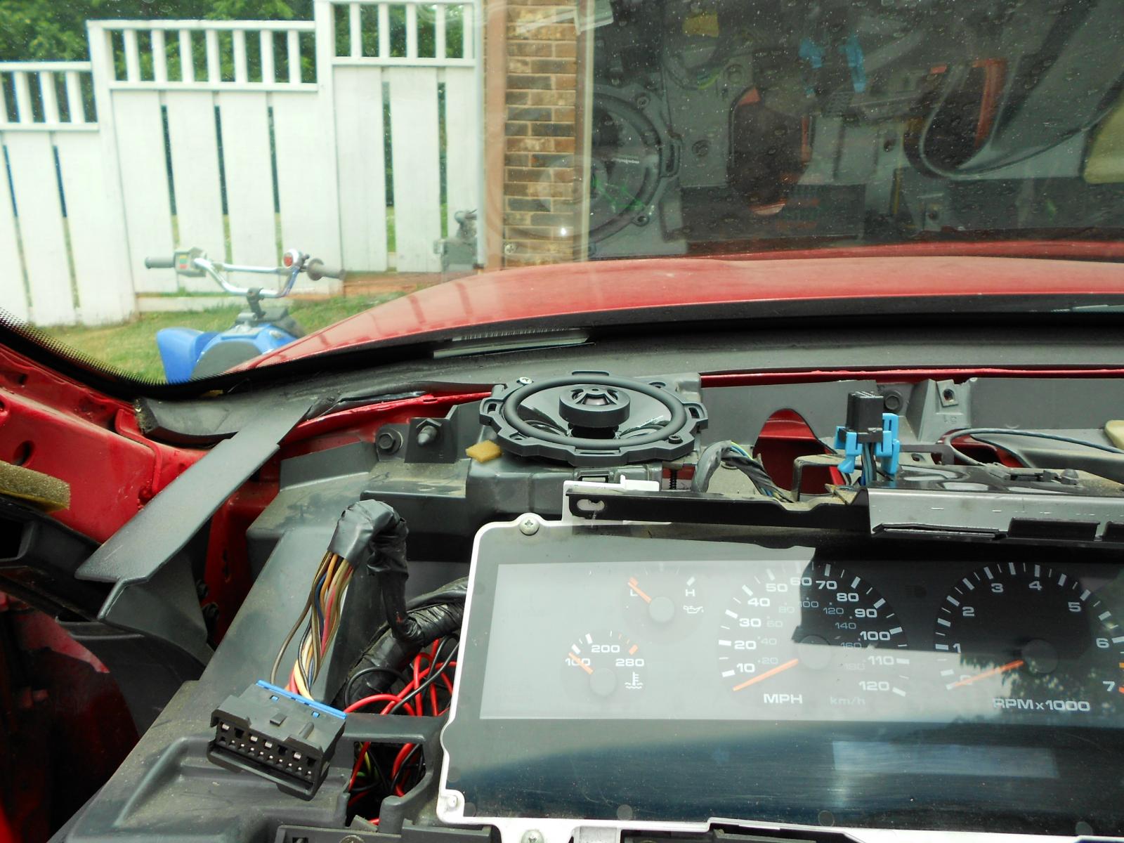

Jack, here is what I did. I talked with Crutchfield less than 2 months ago. They were wrong. I installed Rockford Fosgate Punch Series speakers in my dash, front doors, and rear panels.
This is the speakers.

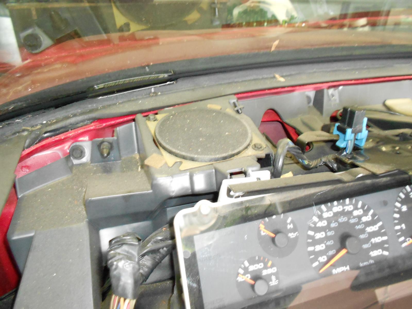

Here is the stock speaker that was in my dash.

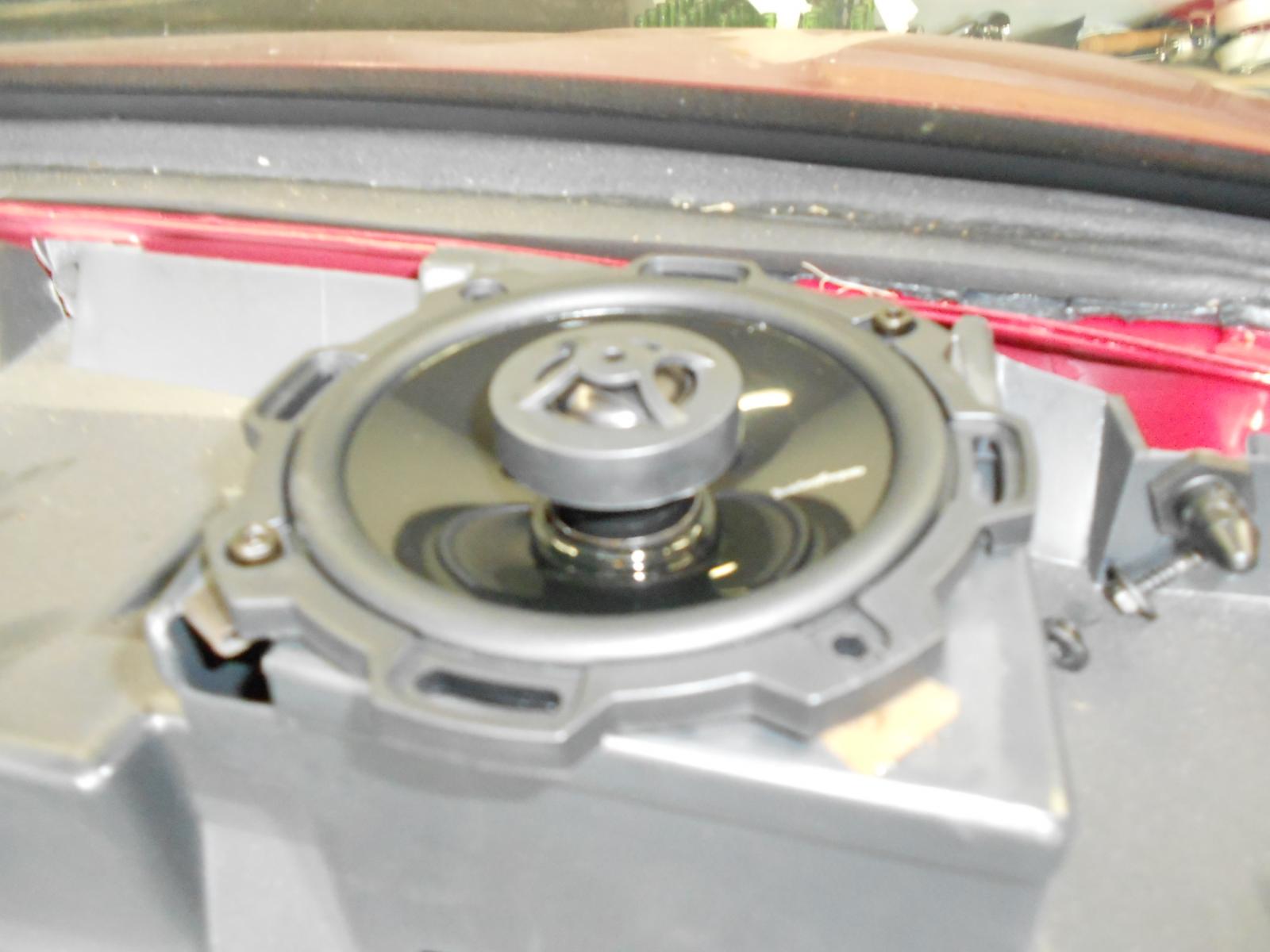

Here is the two installed in my dash. You can install a speaker that is higher than 1/8". They are way higher than that. You have plenty of room. The only problem I had was with the driver side because the speaker was on an angled part of plastic for the cluster. But I have since fixed that.

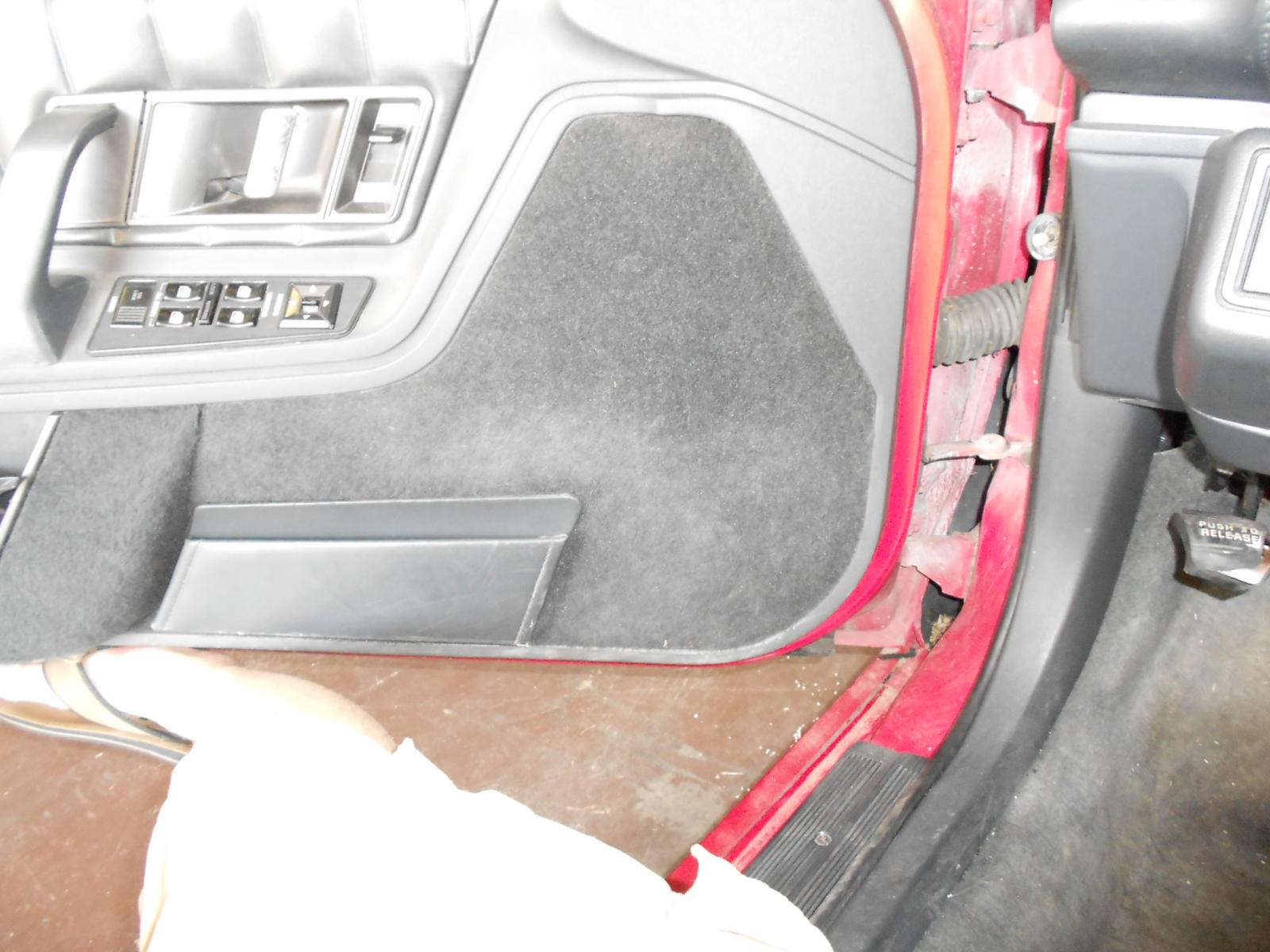

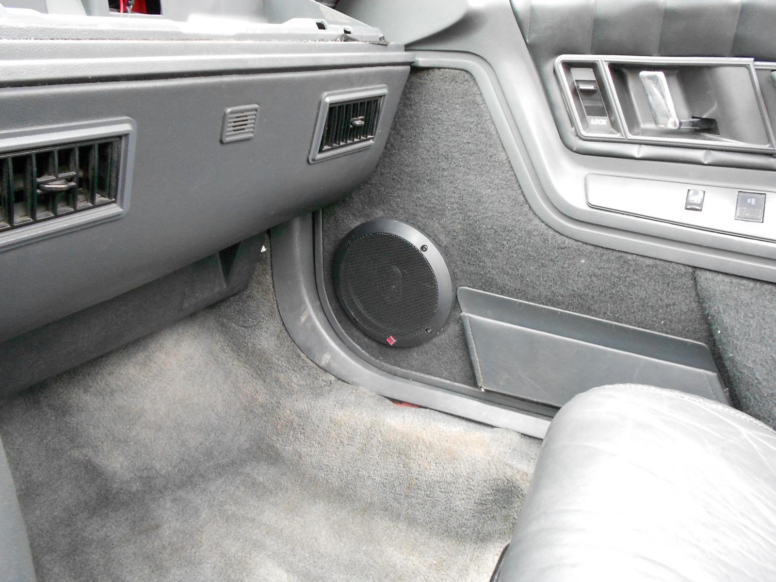

Here is my door before and after the install. There is no speakers in the doors of the 94 Cutlass. But, if you go to Crutchfields site it says that there are speakers there and that they are 6.5". They are wrong. I know from experience. Also the last picture is the speakers I had to cut to fit in my rear panels. Crutchfield said 6.5" would fit, I had to cut for them to fit. But, the car sounds GREAT! And I am still running a stock head unit for now.
