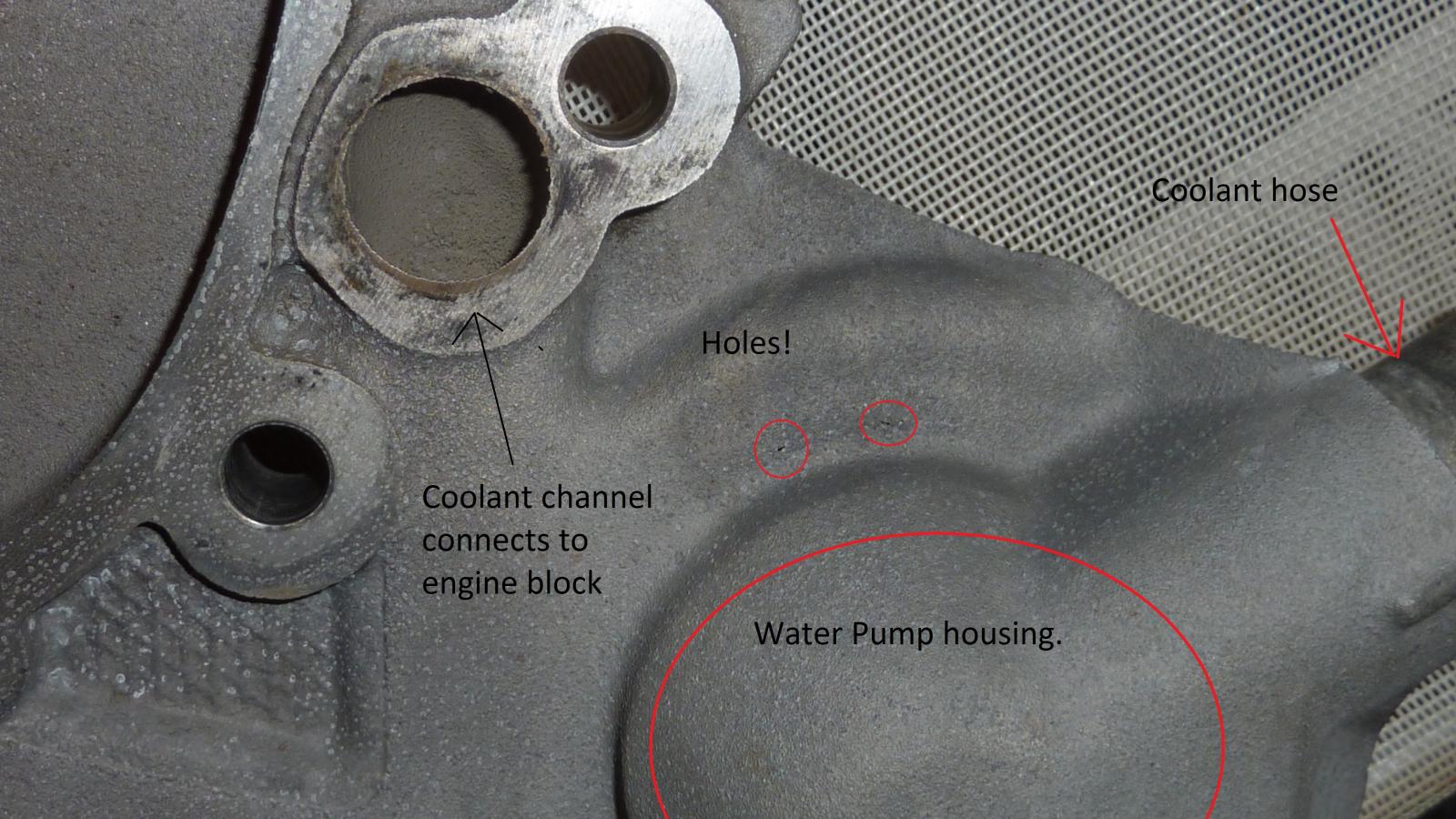

DaveB Posted July 2, 2012 Author Report Posted July 2, 2012 Found the offending area. Good news really because it means the head gaskets and lim that I did last year are probably fine. I wonder if QuickSteel would be a good permanent repair.. I would like to avoid buying a new one. Ideas? Quote
ricklovin93 Posted July 2, 2012 Report Posted July 2, 2012 Wow I have never seen that before maybe try welding a few beads over those holes, or go to the junkyard and pick up another one Quote
DaveB Posted July 6, 2012 Author Report Posted July 6, 2012 I thought about repairing it too but when I stuck my finger on it it pushed straight through. Junkyard part came today, hopefully it fits. FYI, it was caused by a bad water pump that was collapsing and the pulley was rubbing on the outside and now I know that it was also rubbing on the inside. Quote
