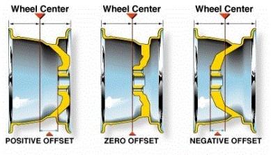

white4d96 Posted June 30, 2012 Report Posted June 30, 2012 BBS, as in the wheel company? Honestly you would have to just look up bolt pattern, width and offset. Look for an 8 inch wheel, 5x115mm, and...+20 offset? Quote

wickedbuick Posted June 30, 2012 Report Posted June 30, 2012 The rims in that link won't work. You'll need 5x115 bolt pattern like stated above. Look up wheel offset to understand how it works. Like above, +20 offset should be good, but not the only size that will fit. Its basically where the hub mounting surface is in relation to the center of the rim. Quote
