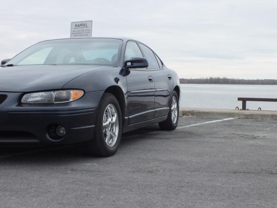

I've included a picture of the car so you guys can see it
