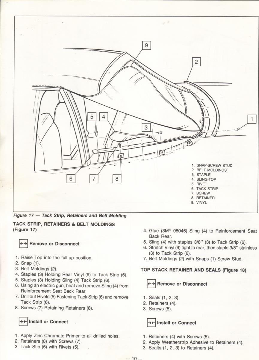

1988PhantomFE3 Posted June 11, 2012 Report Posted June 11, 2012 You're not suppose to sit on it like a carnaval ride when you put it up! JK, there is another thread already here about this same issue...GOOD LUCK VERT Bud! PS I have something from GM about the 1988 Indy 500 Cutlass Supreme Convertible top and HUD, should I post it? Quote

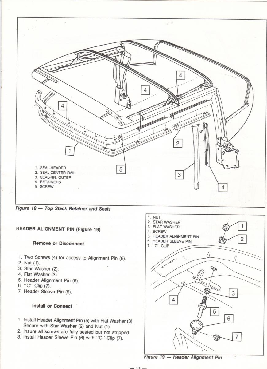

1988PhantomFE3 Posted June 11, 2012 Report Posted June 11, 2012 Cover page. I can scan the whole pamplet if anyone is interested. I'm not sure about copy right laws, but I'm use to living on the edge... I even rip off those tags on my pillows and matresses! < criminal gangsta ! Quote

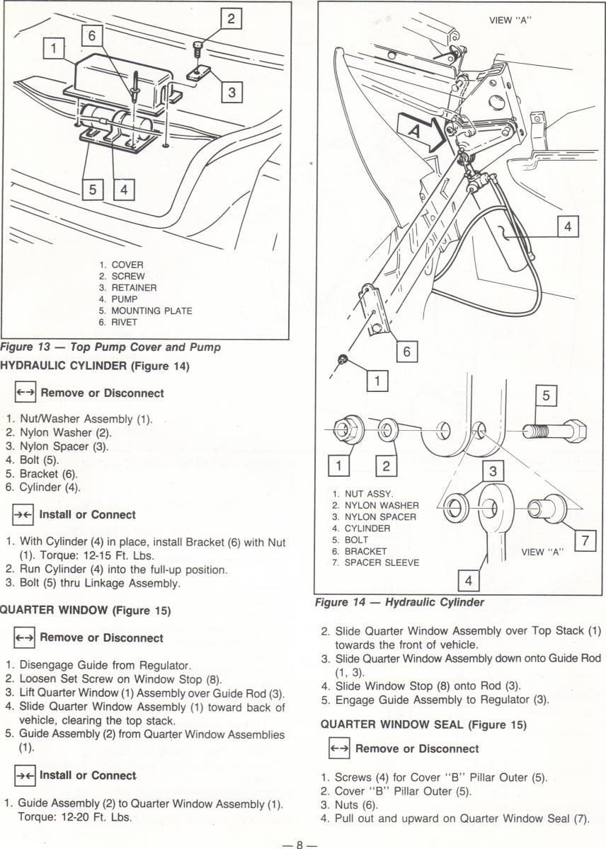

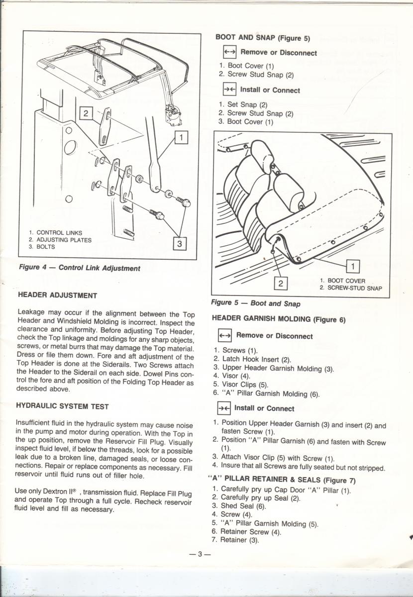

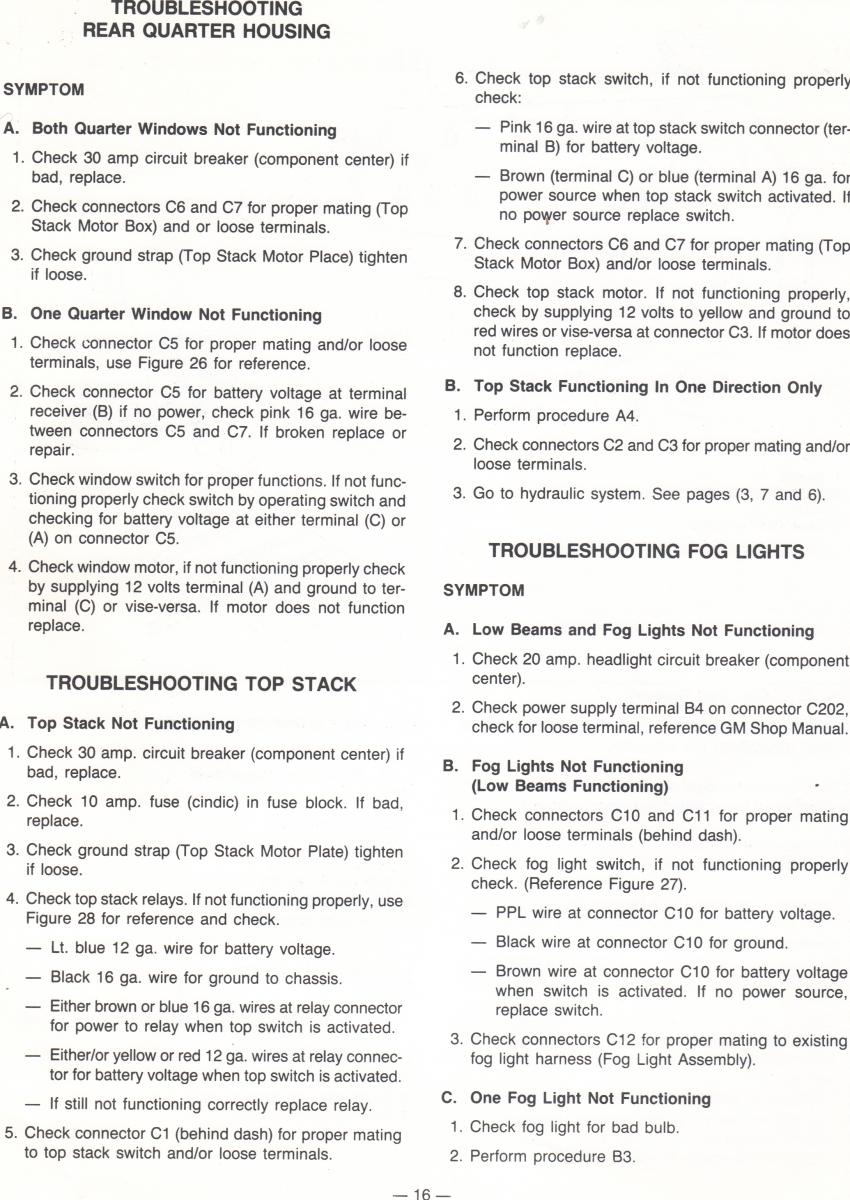

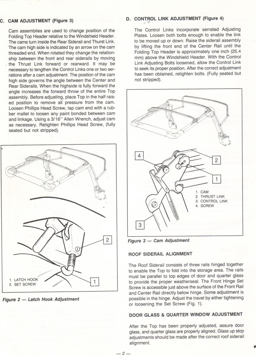

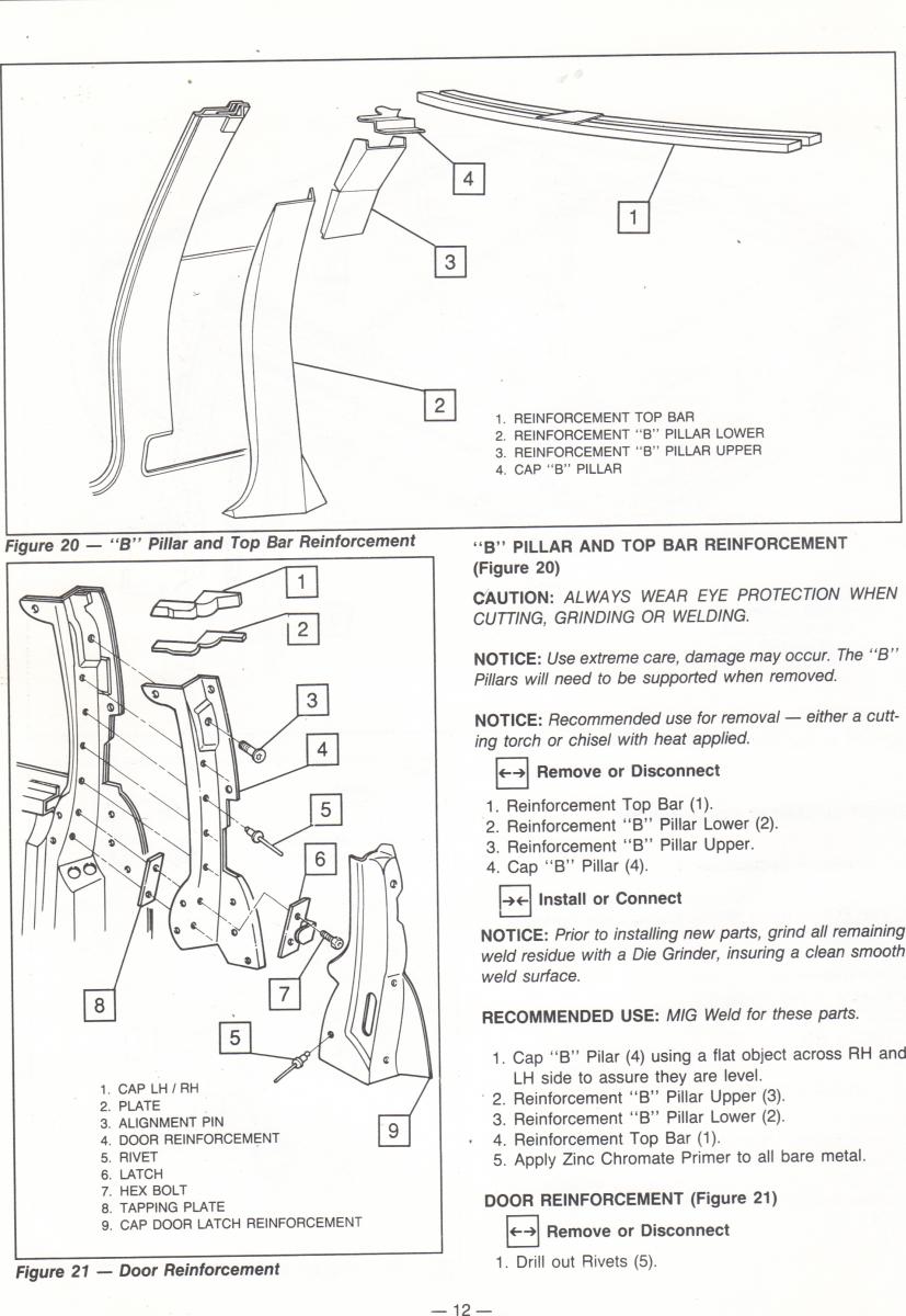

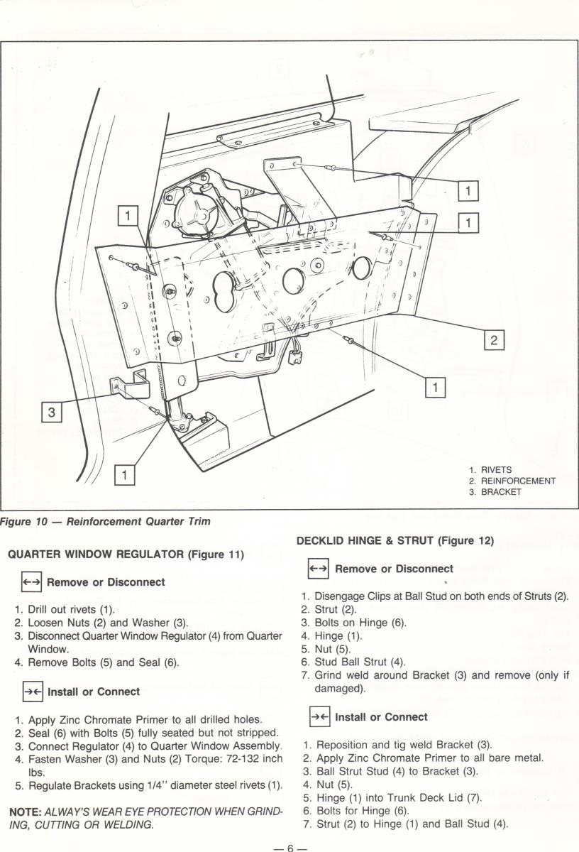

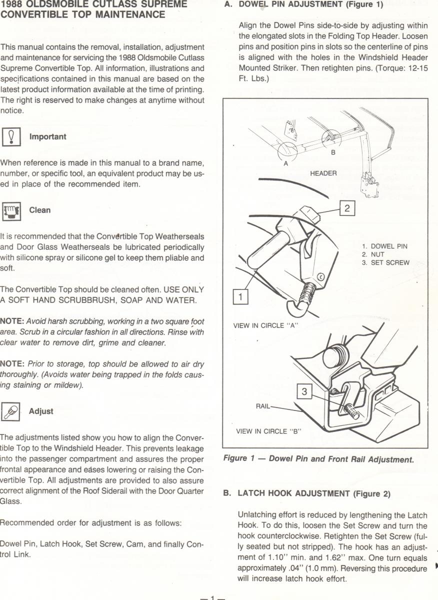

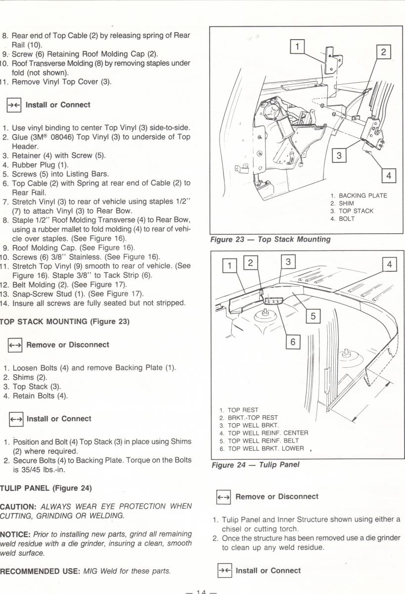

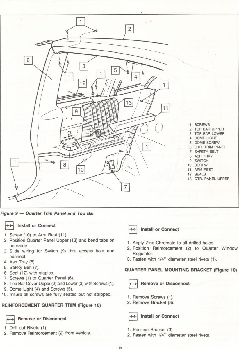

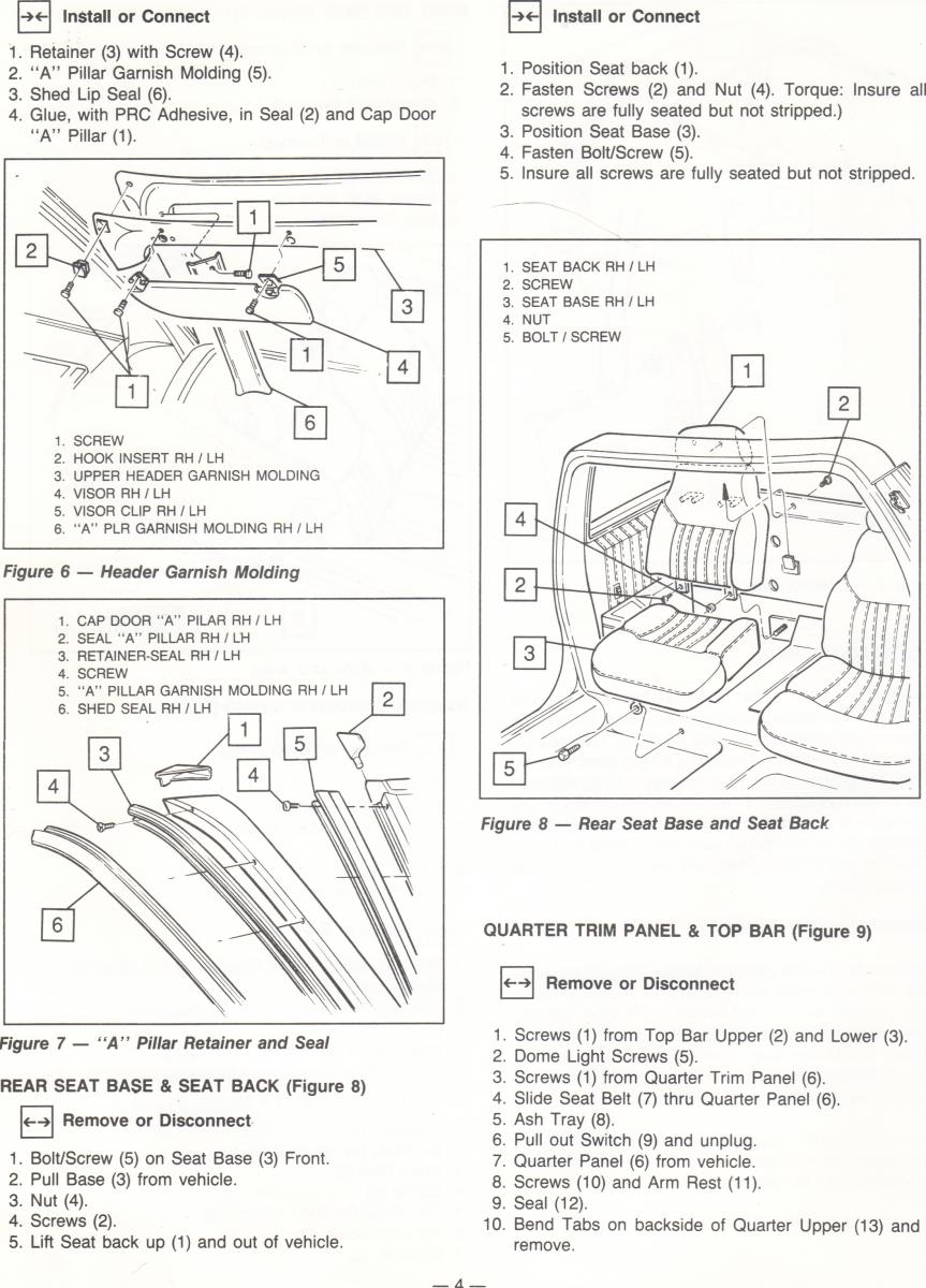

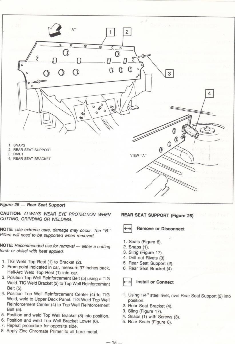

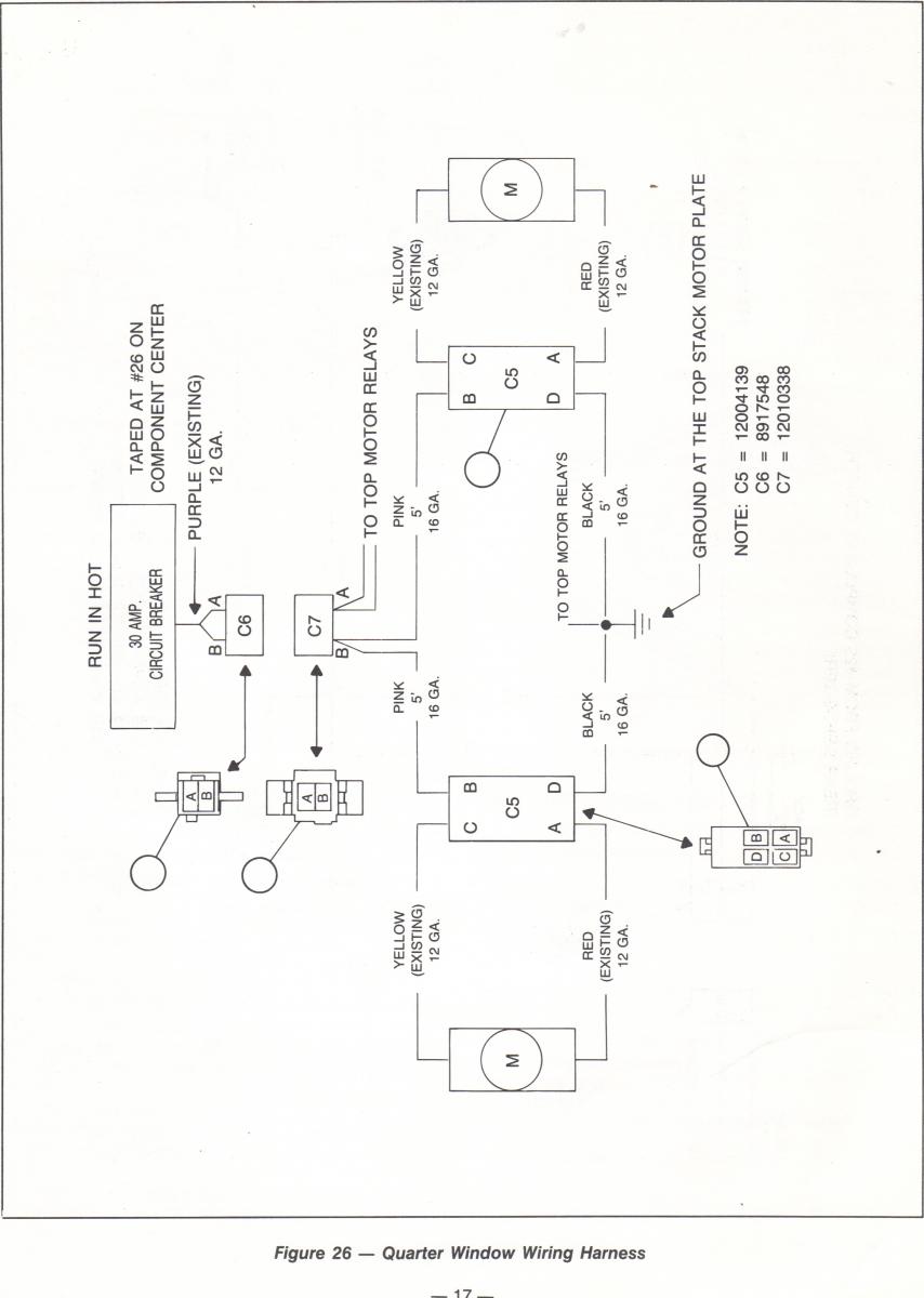

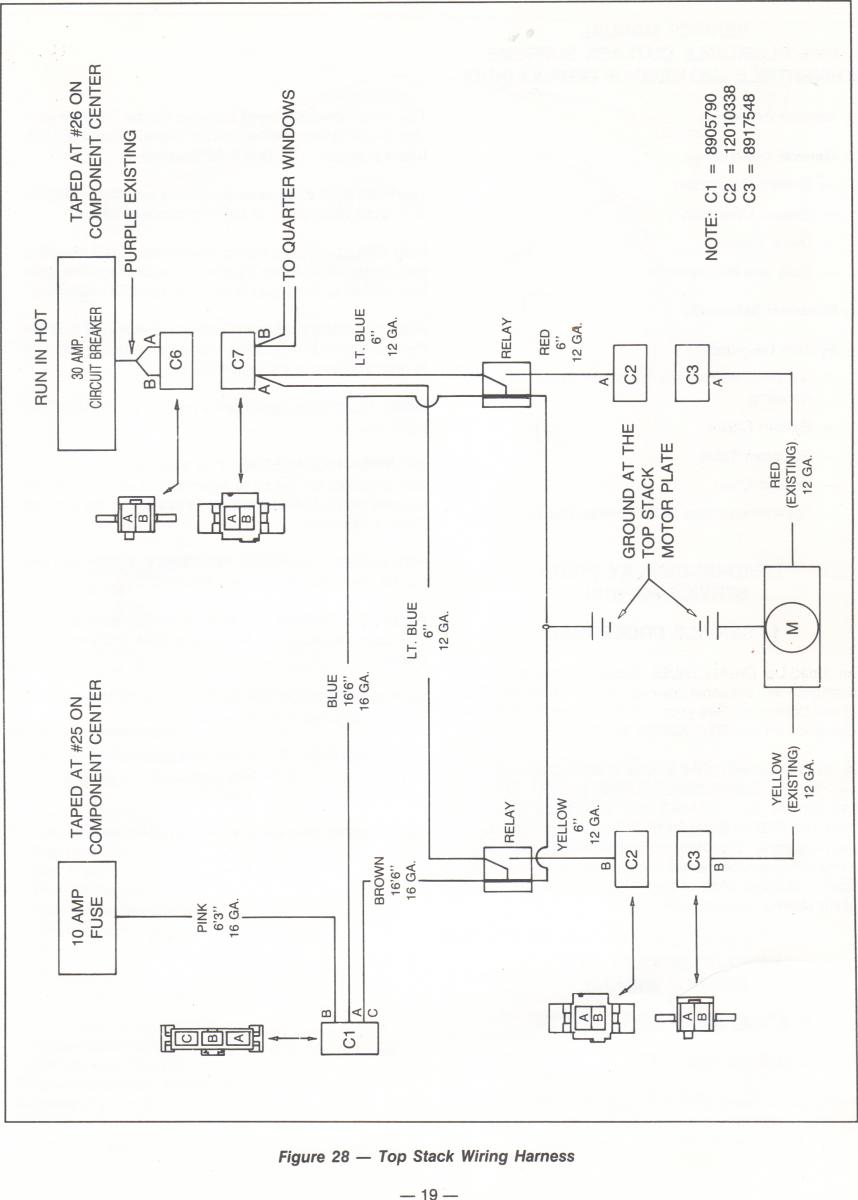

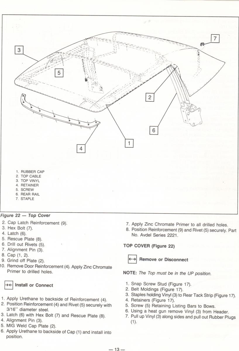

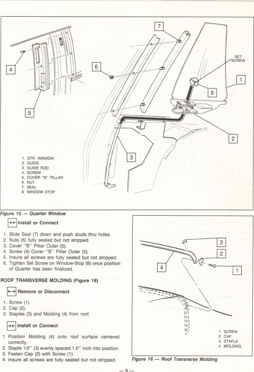

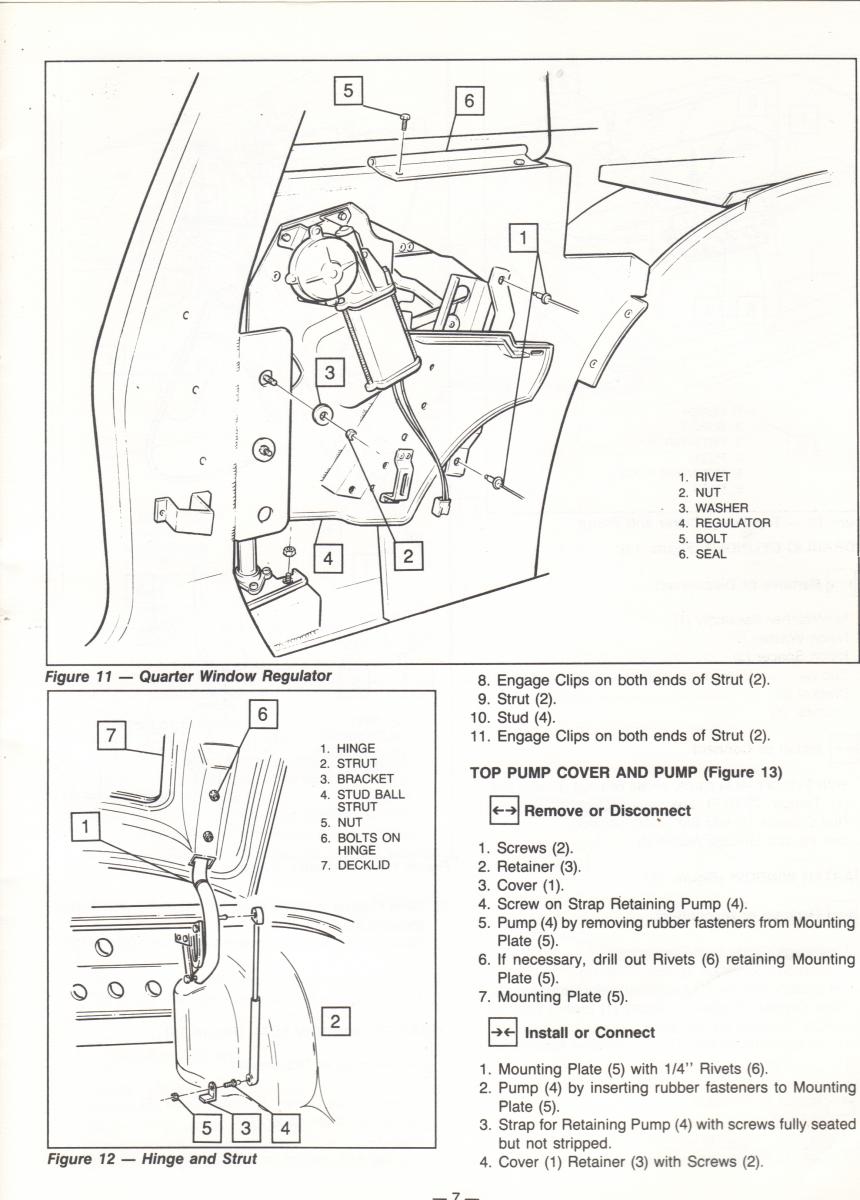

1988PhantomFE3 Posted June 14, 2012 Report Posted June 14, 2012 not sure if this is the same as later years, but here the whole pamplet from start to finish Quote
1994RedVert Posted June 14, 2012 Report Posted June 14, 2012 1988PhantomFE3, Can you keep uploading that book? Would love to have the whole thing! Your the man. Thanks for this. Quote
