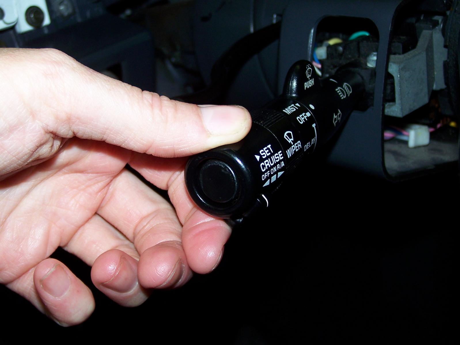

67eleanorgt500 Posted June 8, 2012 Author Report Posted June 8, 2012 The lever has nothing to do with it. Its the inside peices in the column. The turn signal switch can be bought from anywhere, napa, vatozone. If you want to spend the dealer money then go ahead. But a regular show can do it. And it being the same process for aalot of cars I am sure most know what they.re doing. I've never changed anything around or in the steering column before. So I probably wouldn't know what i'm doing. I mean I'm mechanically inclined but there is no where near the steering column I can get to. No screws or anything. There is no switch it's the lever that you move up and down to signal with Quote
67eleanorgt500 Posted June 8, 2012 Author Report Posted June 8, 2012 Here is what I'm talking about. In the picture I have my hand on the turn signal lever. Quote
67eleanorgt500 Posted June 8, 2012 Author Report Posted June 8, 2012 How do I go about to replacing it myself? Do I need to disassemble the steering wheel? Can someone walk me through replacing the lever? Quote
