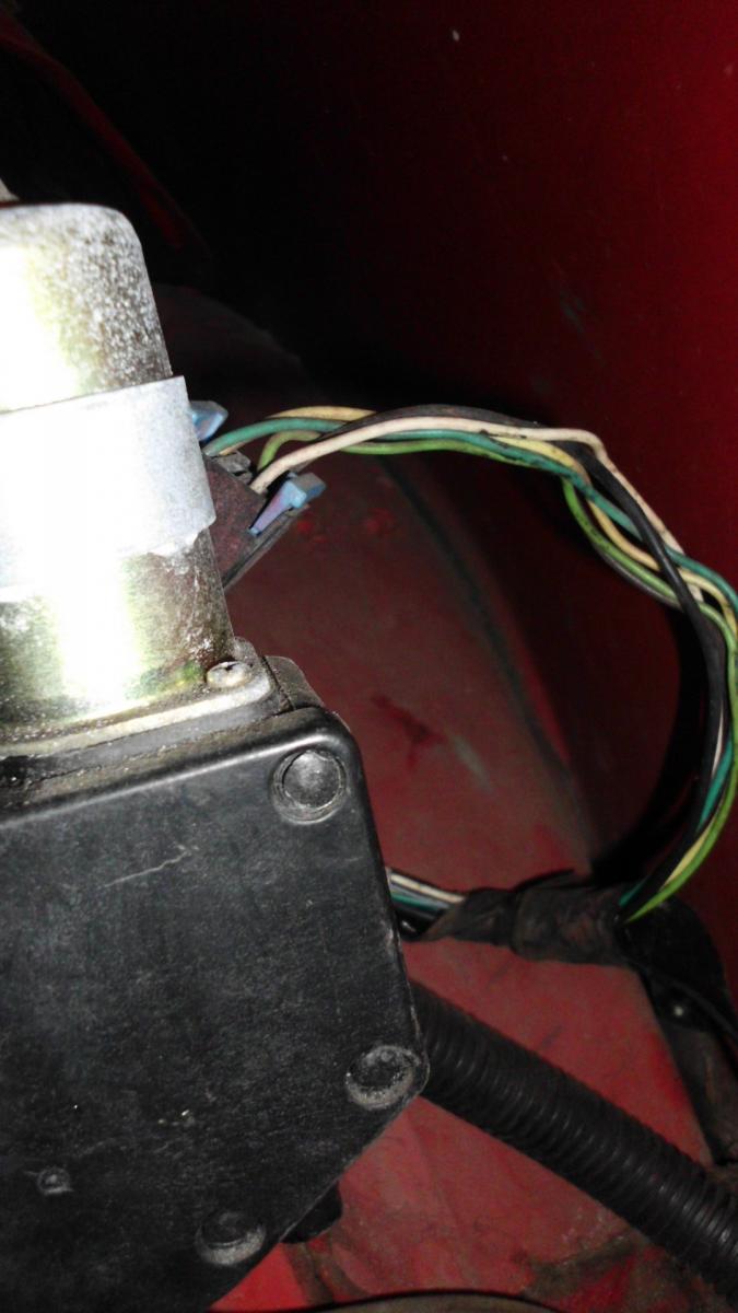

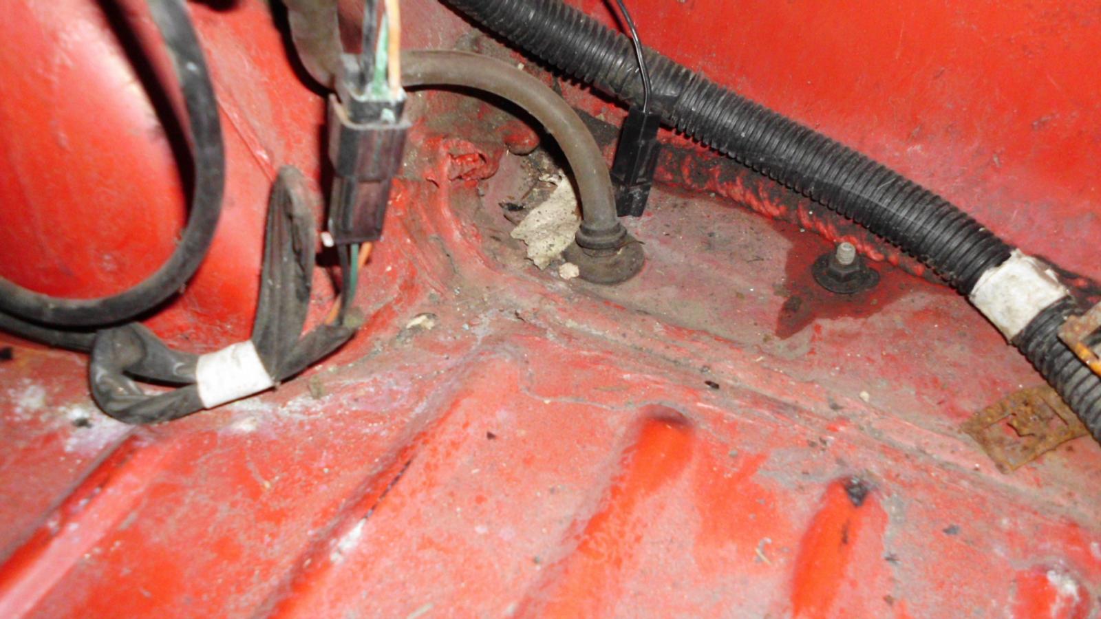

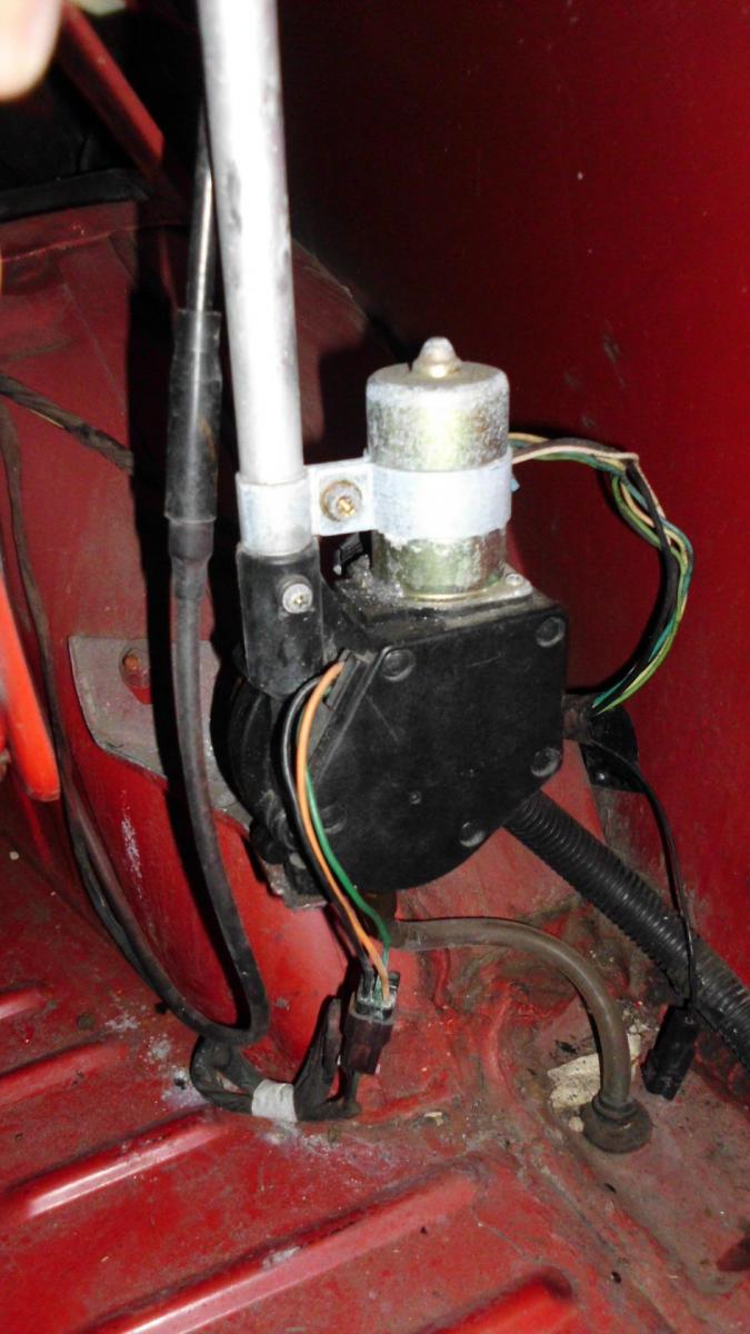

1988PhantomFE3 Posted June 5, 2012 Report Posted June 5, 2012 (edited) Here you go buddy, pics from our 1994 CS Vert edit; ignore the top/back connector, it's for something else and was just stowed there. I thought it hooked up to the antenna, but I just checked and it does NOT!!! It's the connector closest to the fender in pic#2. The only connectors are the coax and the one in the close up pics#1 & 3 Edited June 5, 2012 by 1988PhantomFE3 Quote

1994RedVert Posted June 5, 2012 Author Report Posted June 5, 2012 Here you go buddy, pics from our 1994 CS Vert edit; ignore the top/back connector, it's for something else and was just stowed there. I thought it hooked up to the antenna, but I just checked and it does NOT!!! It's the connector closest to the fender in pic#2. The only connectors are the coax and the one in the close up pics#1 & 3 This was exactly what I was looking for. Now I need to see if I can order that gromet. You guys are awesome! Plus I just wanted to see how the thing hooked up. I have a bunch of wires back there and didnt' know if they hooked up to the antenna or not. Quote

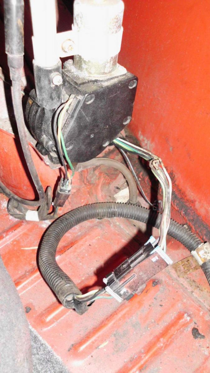

1988PhantomFE3 Posted June 6, 2012 Report Posted June 6, 2012 I pulled out that other connector that was by our power antenna, does your big connector look like this one 1994Red Vert? Quote

1994RedVert Posted June 6, 2012 Author Report Posted June 6, 2012 I pulled out that other connector that was by our power antenna, does your big connector look like this one 1994Red Vert? No, it is actually towards the top where the antenna is screwed in. It is a pretty big connector attached to the part the antenna mast goes into. Quote
