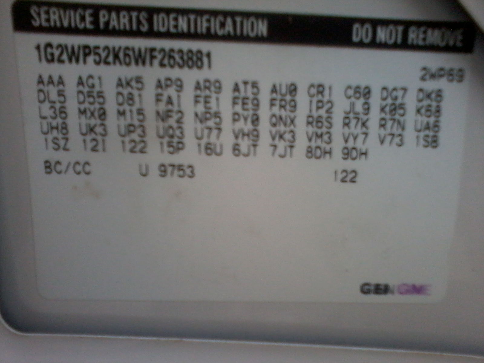

Well I need a new high presser steering line in my 98 GP GT. And there are 2 different lines one with Variable Assist and one with out. So I would like to know how to tell if I have the Variable Assist in my GP or not. Thanks
Look at the build tag under the trunk lid. If your car has it, it will have the code 1SC.
"1SC - WIDETRACK PREMIUM PACKAGE * POWER SUNROOF * FULL OVERHEAD CONSOLE DELETE * LUMBAR, DRIVER SEAT POWER * PREMIUM LIGHTING PACKAGE * CARGO NET * LEATHER WRAPPED STEERING WHL WITH RADIO CONTROLS * MSVA VARIABLE ASSIST STEERING * ANTILOCK BRAKING SYSTEM 1SZ - VALUE GROUP SAVINGS"
Here is what I found on the trunk. I bleave mine doesn't have the variable assist steering.[h=1]post-7407-143689101577_thumb.jpg[/h]
