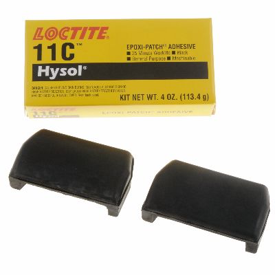

wickedbuick Posted June 19, 2012 Report Posted June 19, 2012 I thought someone mentioned a different style isolator and figured this must be it. Dorman p/n 31066 and its $25 http://www.autozone.com/autozone/parts/Dorman-Leaf-Spring-Insulator/1991-Buick-Regal/_/N-itcyeZ8ijxo?itemIdentifier=365532_13921_2826_ Quote
mhildebrand Posted June 19, 2012 Report Posted June 19, 2012 Has anyone used the Dormans? My isolators are ready to be replaced now, and if the moogs are damaging the monoleaf, i dont really want to use them. Quote
