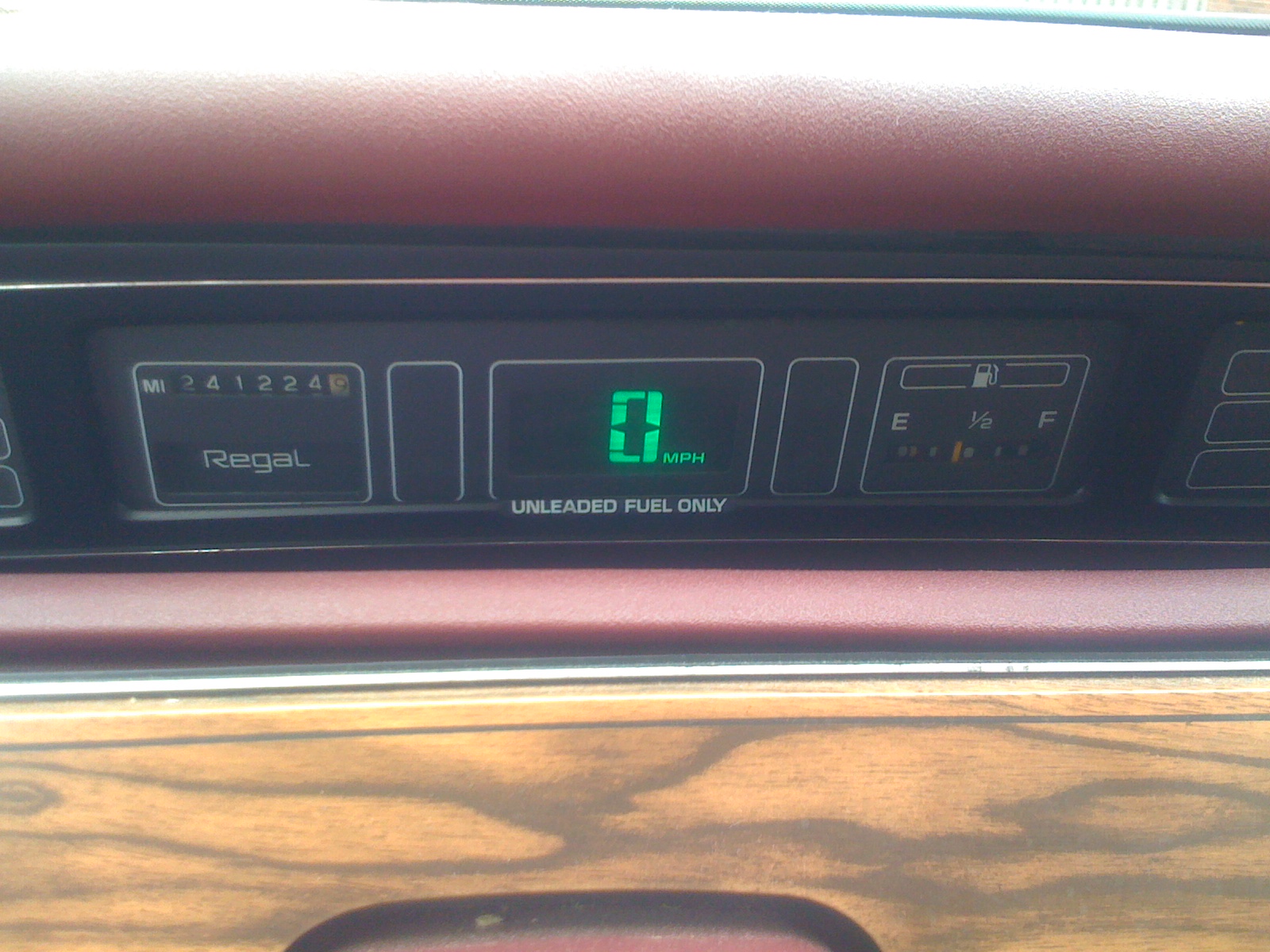

emb1230 Posted May 24, 2012 Report Posted May 24, 2012 (edited) At least in the CS all 3 were digital: speed, gas, odo, and trip, the Regal is the STUPIDEST design I've ever seen: Digital speed, mechanical Odo & gas gauge (which BTW is very hard to read) and NO trip at all!! here's the one in our 89 GS...LAME!! Edited May 24, 2012 by emb1230 Quote
